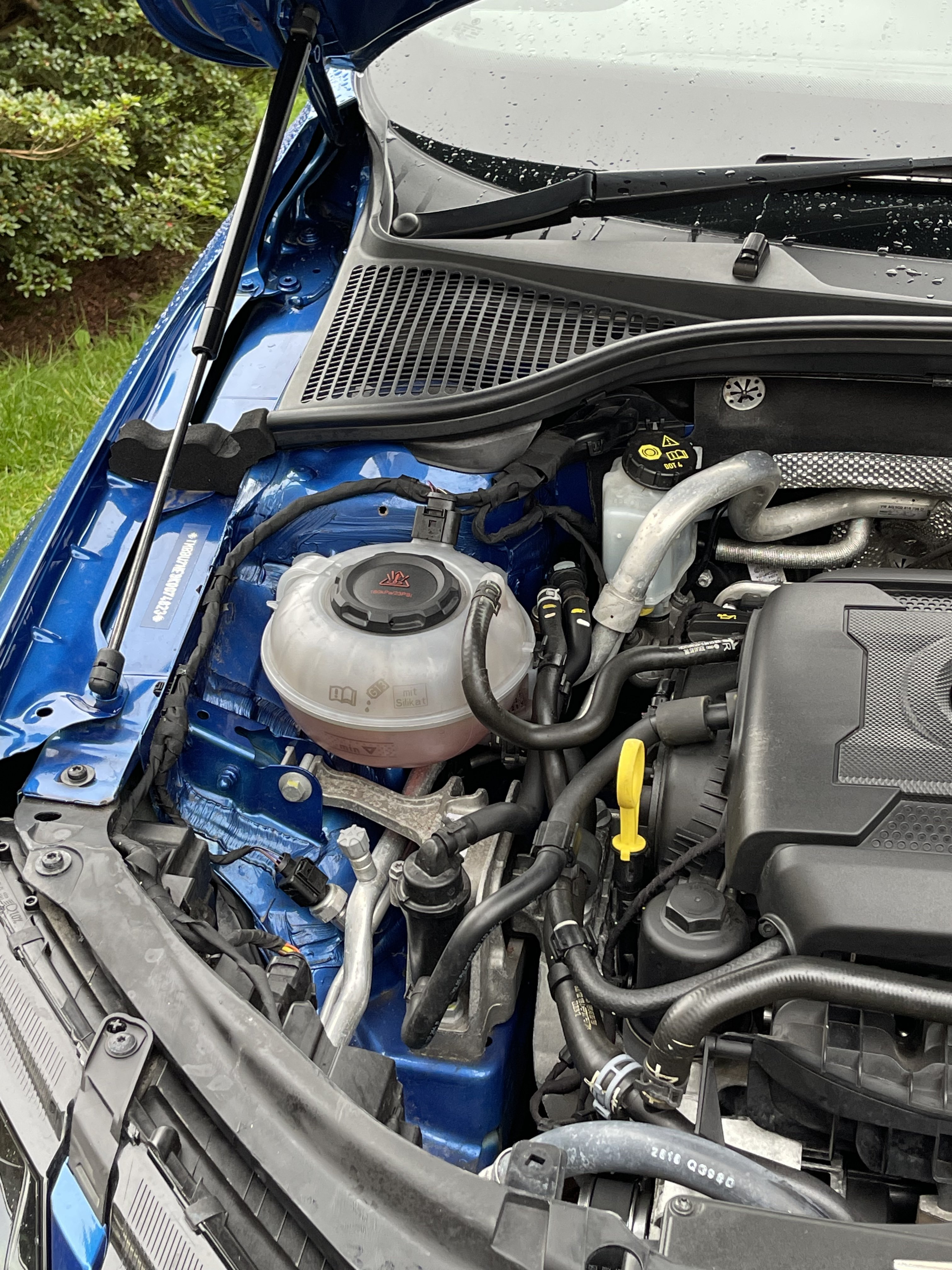

Just done mine (Karoq 2019)
still to be finished ie painted and bolt on hinge bracket to be trimmed down
excuse the dirty car !!!
