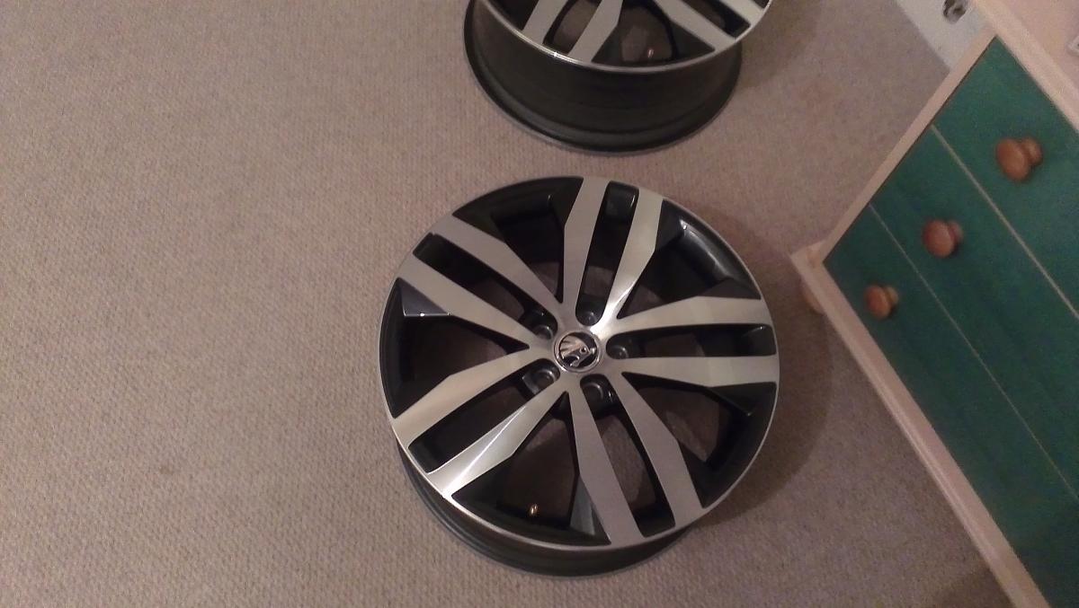

Picked up a brand new set of Fabia mk2 vRS alloys (14 plate) from North Yorkshire on Thursday for my Special Edition :) Pictures will follow shortly once I make the account on that picture thing! Just painfully waiting for the weekend to pass so my set of four brand new Hankook Ventus v12 evo 2's get here! Was close to getting Audi Comps but wanted to be one of the few so far who have the Gigaro's.

Maybe best to keep your Black Wheels for the Winter if they put Salt down where you drive.
Be sure to put some Copper Grease on the Mating surface inside the wheels, the Dark Chrome Gigaro are really bad for getting White Spider near the Centres under the Lacquer and further up the Spokes.
& be sure who ever is fitting the tyres is careful with the Rim Edges.
They are Wheels that are so easily marked and damaged, and prone to corrosion.

Scary. Whats the chance of my getting them replaced by skoda? My car is under used car warranty until next month but of course the wheels arnt standard for my car.. it's but I deal in this case to have them replaced with black ones then. I never read up on them as I just didn't expect these issues. They're so pretty though :(
They look lovely in that colour

I have a couple of marks under the lacquer already I've noticed, will apply a protective layer prevent them getting worse or is it a case of once it's started that it? Bl***y annoying really.
Just look after them, or have them Painted now before they do corrode.
They do mark very easily and damage to the Lacquer Area is easy to do as you have noticed.

I see, they are a 'take off' set from a 14 plates mk2. May end up having them painted then, bit of a shame. Is it not an easy task (for a professional) to strip the chrome part down and remove the white marks, then lacquer them again?
No it is not.  I was a Car Sprayer.
Best key the surface of the wheels as they are and paint, not go stripping or Powder Coating.
george
Paint over the current surface?
You can do, you Degrease, prepare and paint with the appropriate paint.
Or some just spray with Plastidip or the likes.
Or pay lots and have them stripped and painted,  or sell them again, or Look after them and get them painted or Coated in the Future.
They will probably be fine for the Summer if you grease the back and Seal them on the front surface,
