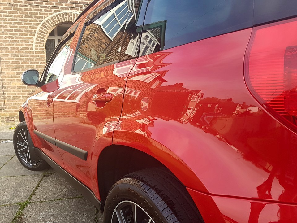

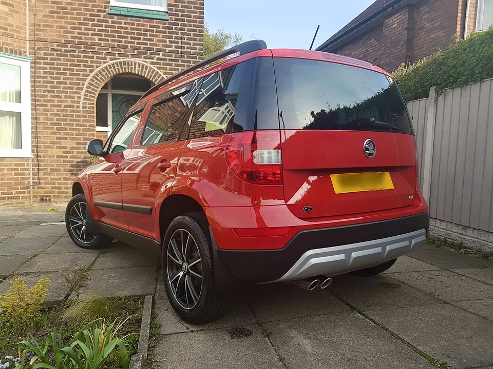

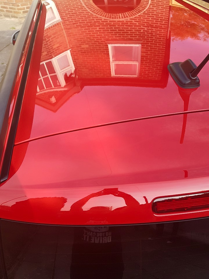

Car has had a good detail, 4 coats of wax and sealed the wheels.
post-120571-0-05042400-1462484443_thumb.jpgpost-120571-0-88023900-1462484443_thumb.jpgpost-120571-0-21398100-1462484445_thumb.jpgpost-120571-0-06170400-1462484446_thumb.jpgpost-120571-0-08713900-1462484447_thumb.jpgpost-120571-0-02338900-1462484448_thumb.jpg
You can even look down the street in the reflection!!
Nice work - looking lovely  :clap:

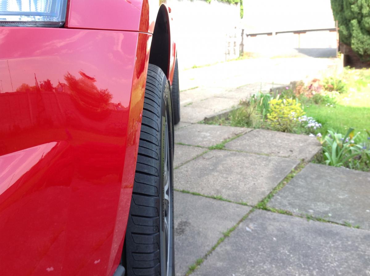

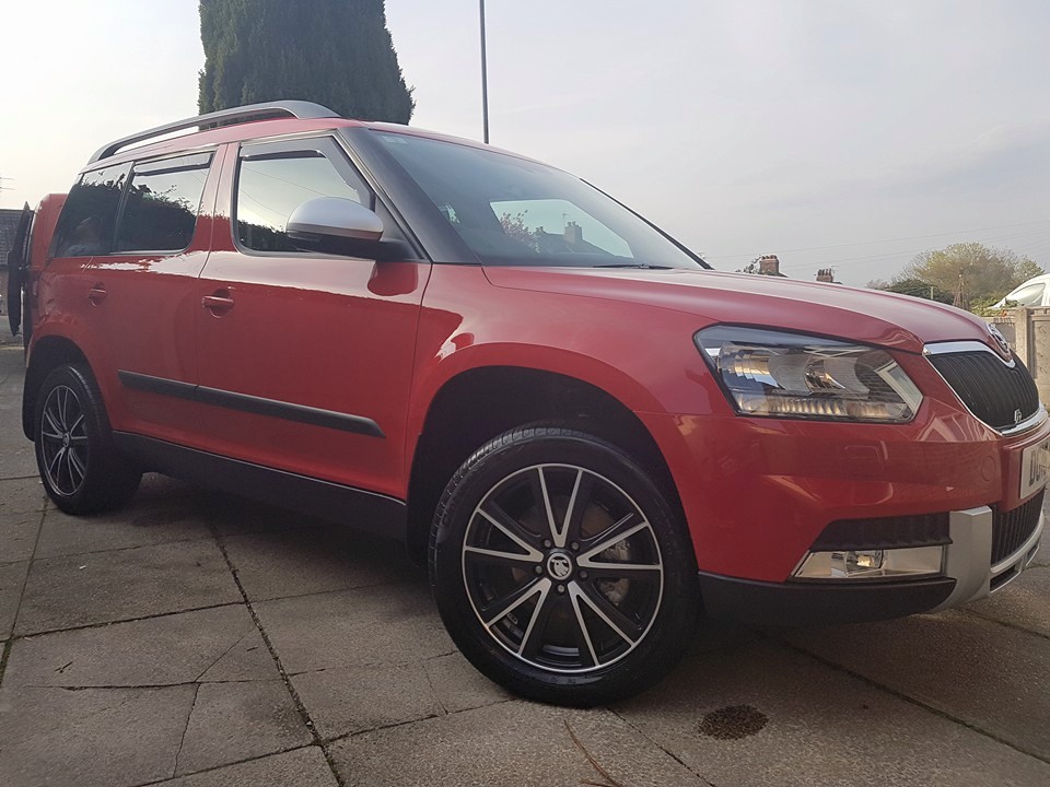

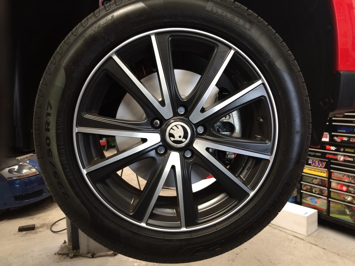

Got the 15mm spacers on today so 30mm across both front and rear axles, started lashing it down just as I'd finished so I'll have to get some pics tomorrow.
I think it looks great, has made a big difference visually, how it should have looked from factory IMO :)

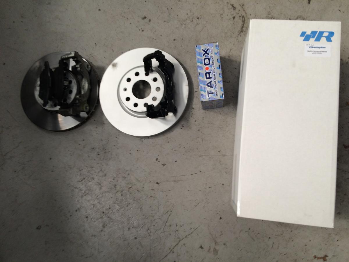

Couple of shots with the spacers fitted, I'm going to get the brakes sorted out today. I've gone with Tarox Stradas again, it was a toss up between them and the Ferodo DS2500, nothing in it price wise but I've used the Tarox before and was happy with them.
So today's list:
- Fit 312mm discs
- calliper carriers
- Tarox Strada pads
If I've got time I'll swop the brake fluid over to the ADE 200 :)
Edited by DarrellGB

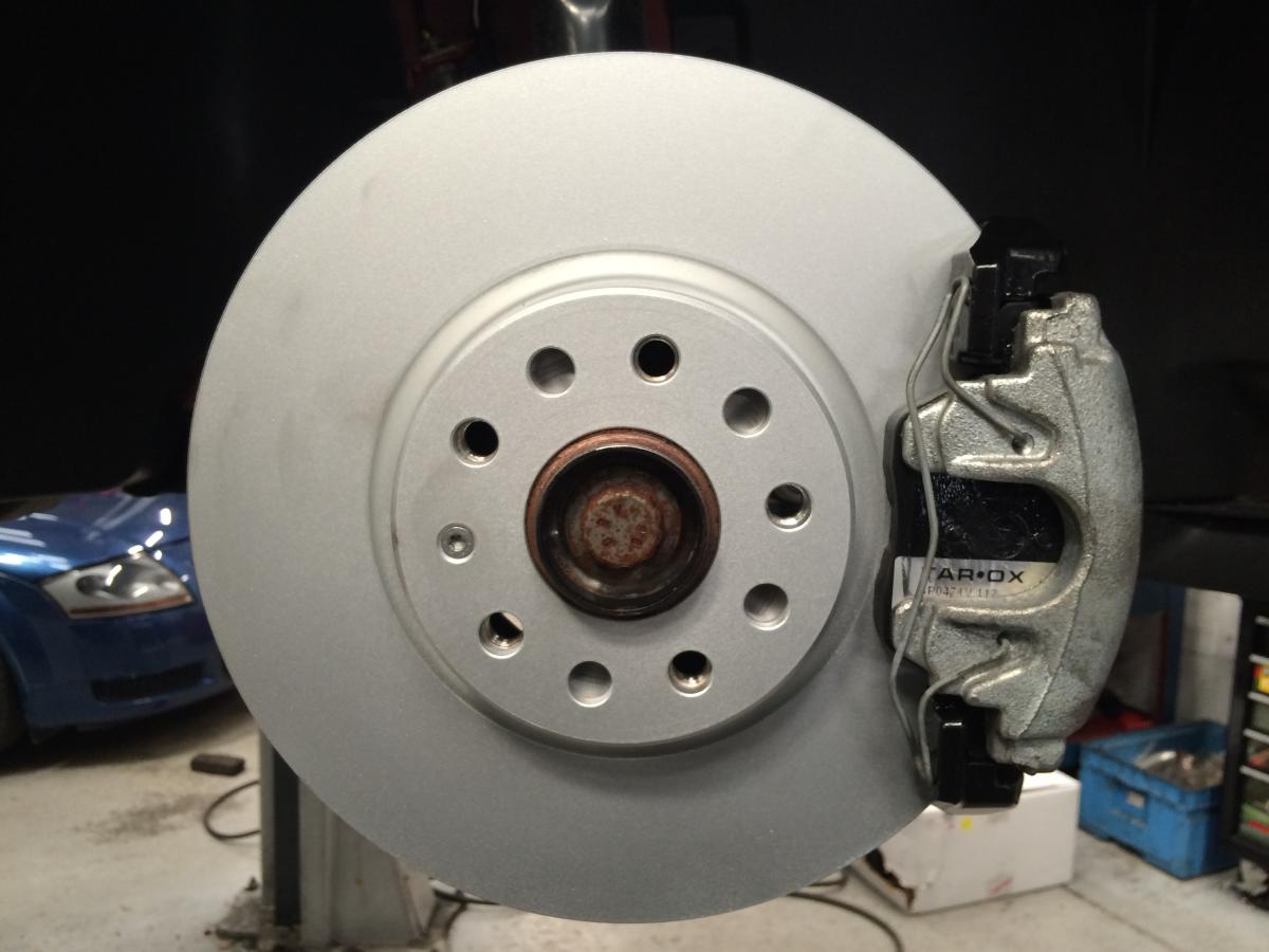

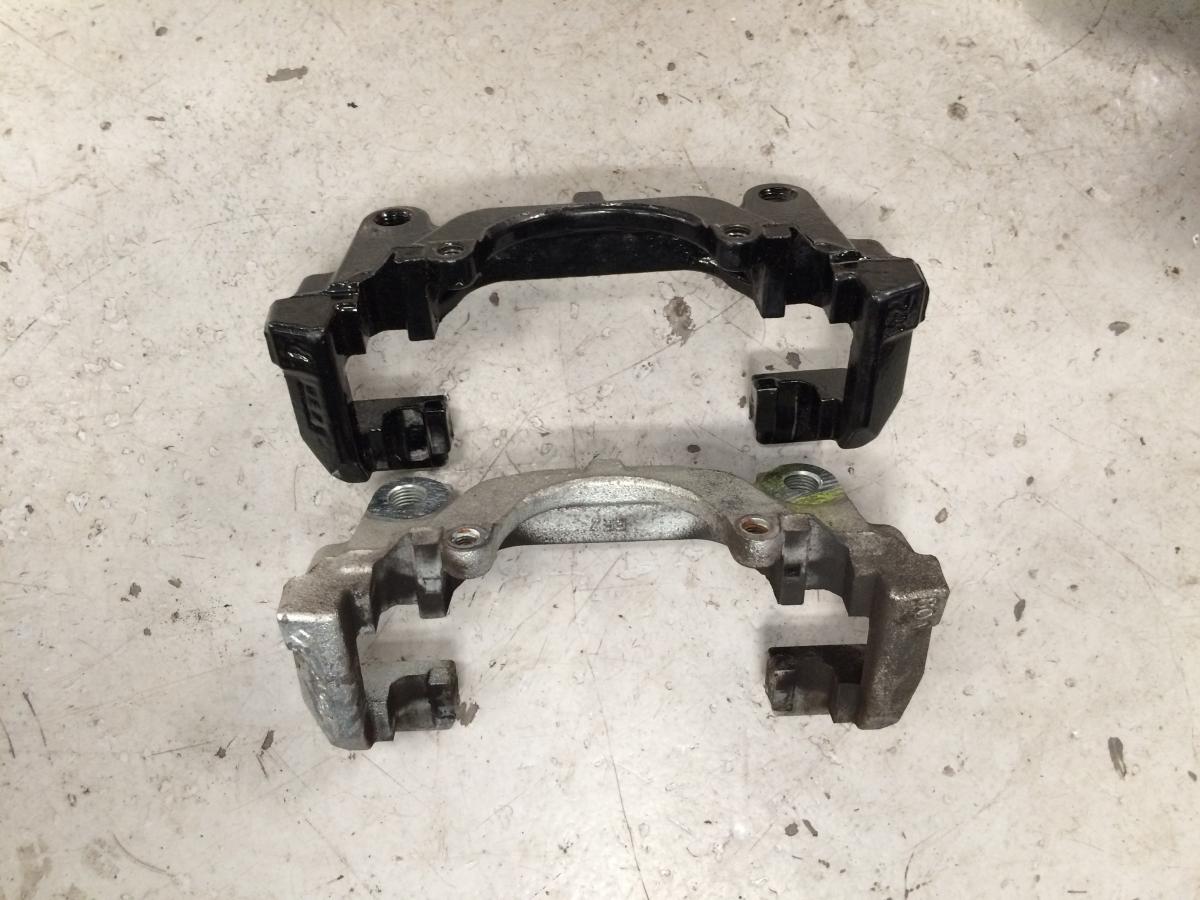

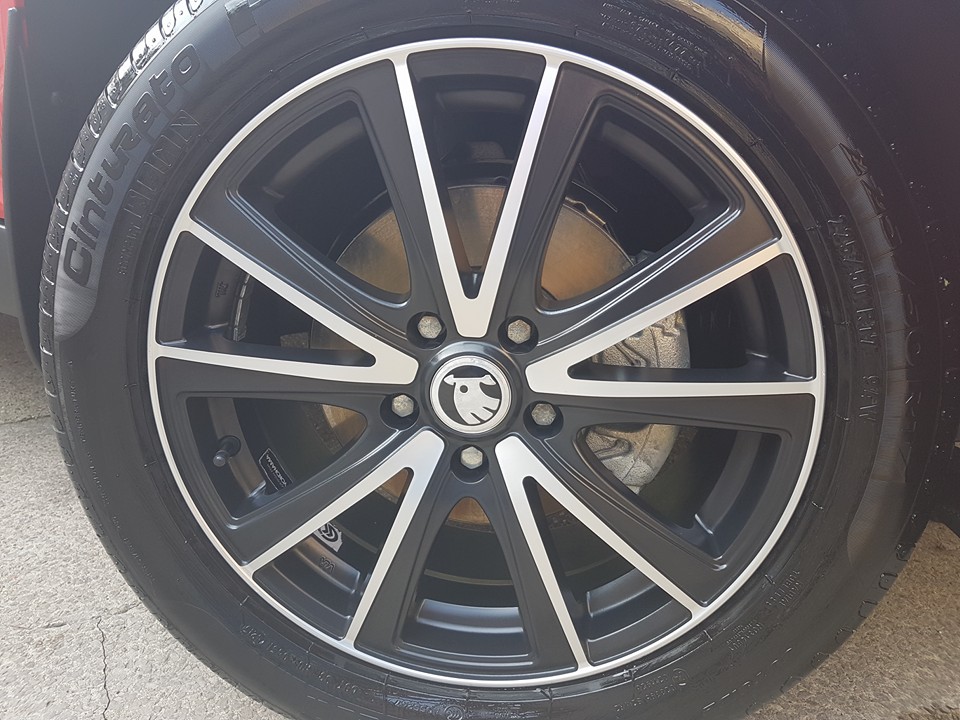

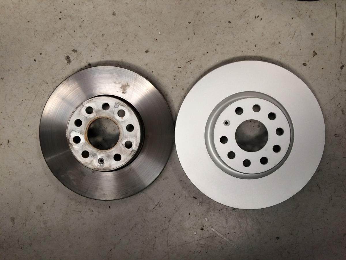

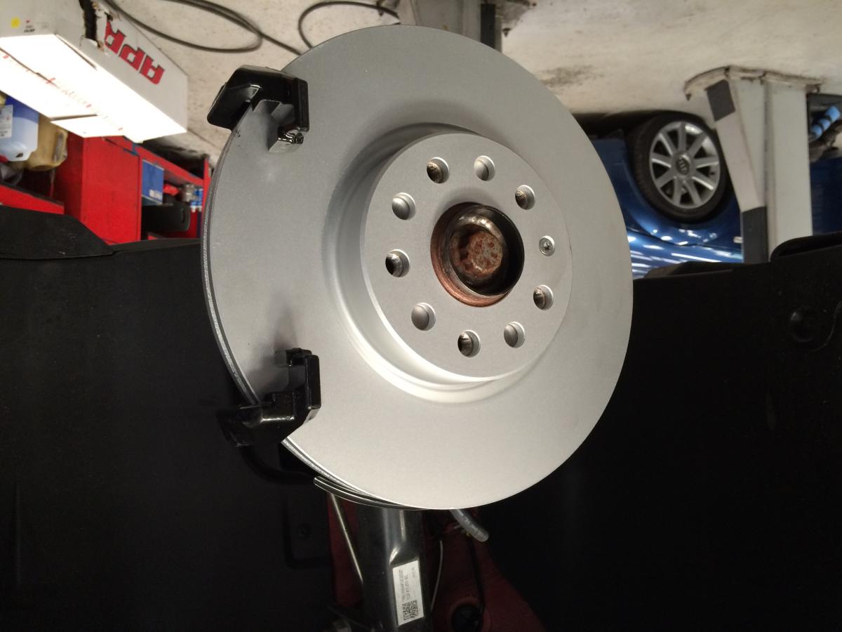

Brakes done, 312mm Pagid discs, black calliper carriers and Tarix Strada Pads with ADE 200 fluid :)

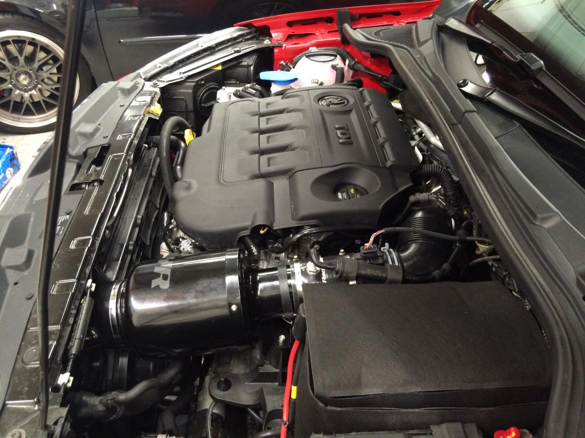

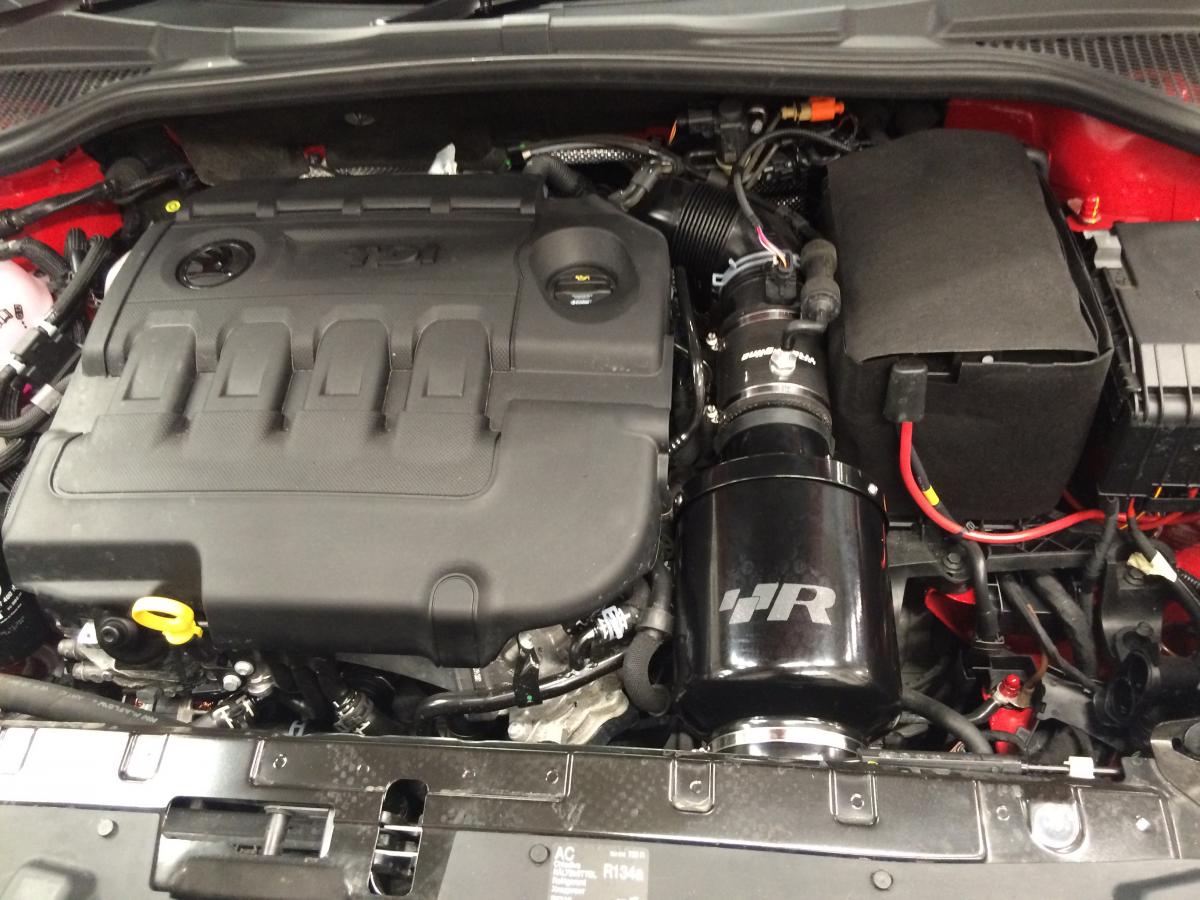

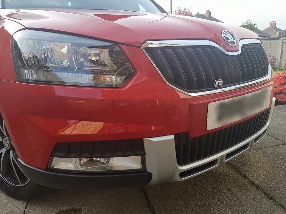

Also had a mad moment and fit some engine bay bling with a VWR Intake (yes I know there's no real gain) but it looks and sounds great, well IMO :)

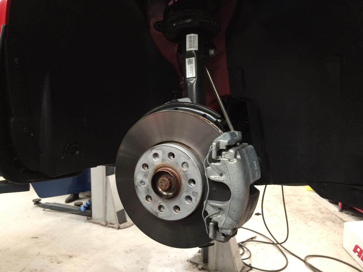

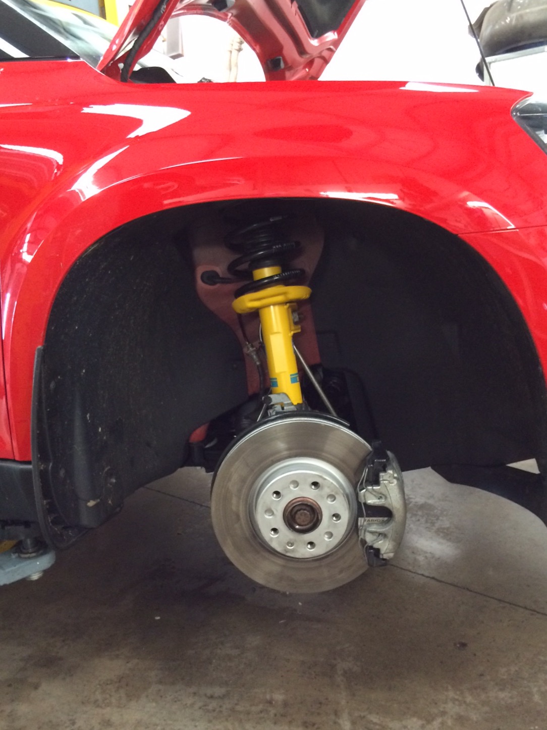

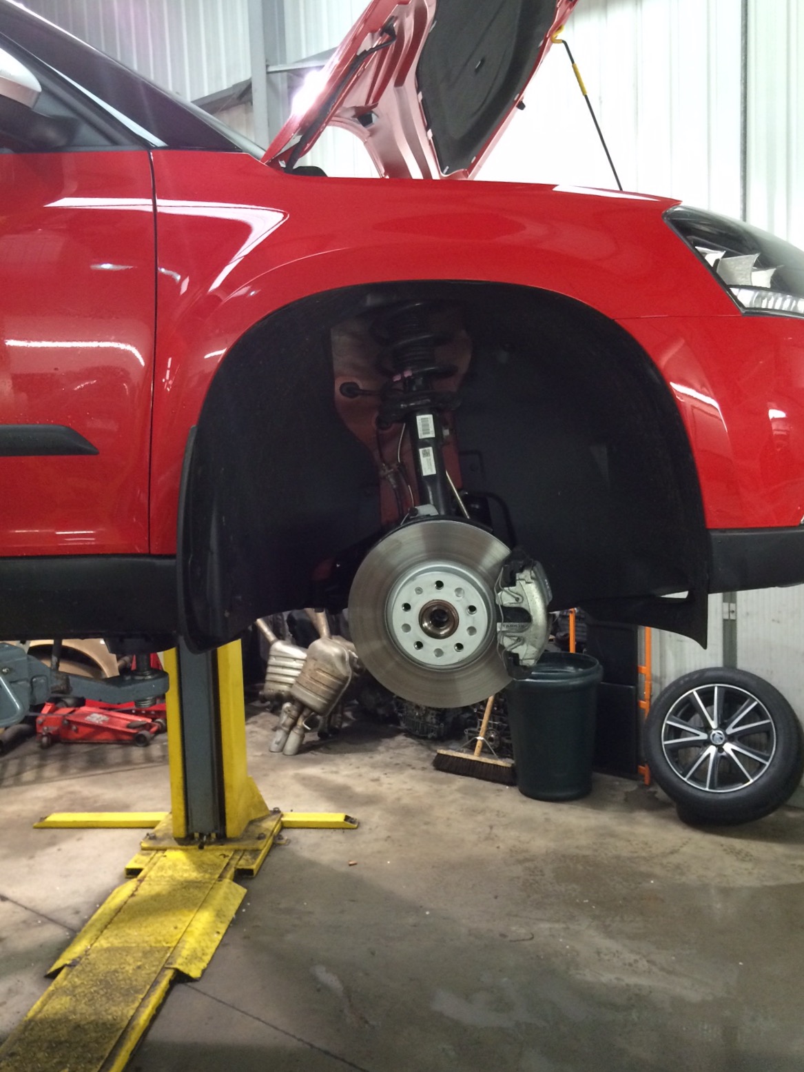

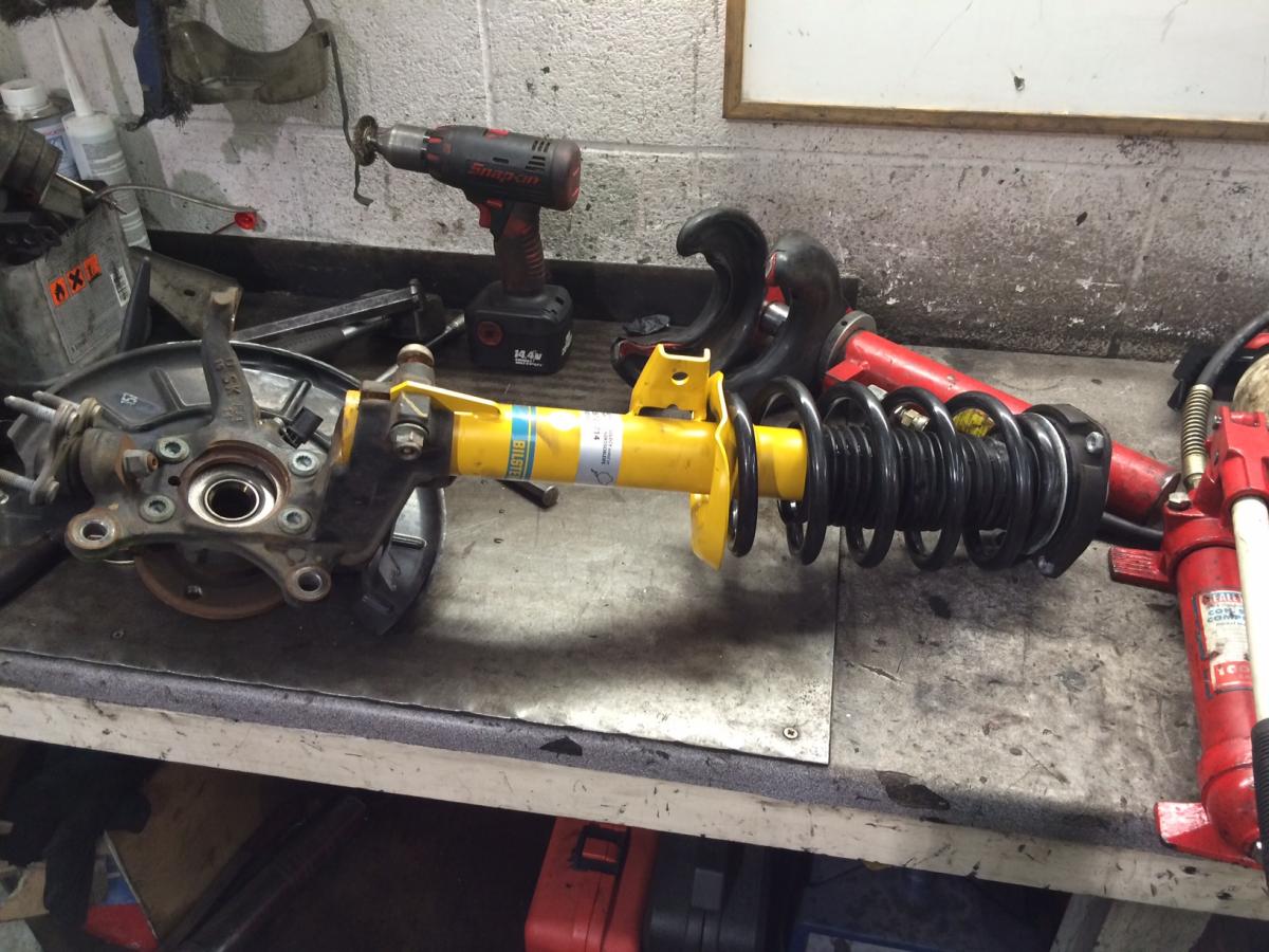

Bilstein B6 Shocks and Eibachs fitted, quality work as always from Shark Performance, can't wait to see what it handles like, think I'll go the long way home through Snake Pass :)
Couple of questions...as I'll be switching my dampers over quite soon.
Do the normal front bumpstops get re-fitted with the B6 dampers ? The shafts look a lot bigger on the B6, and I remember doing the same change on a Passat and having to dremel out the bumpstop hole to get them to fit. Reason I had to refit them on the Passat was because the protective bellows attached to the bumpstop.
Did you see how they remove the plastic trim at the bottom of the windscreen to get to the strut mount bolts ?
Couple of questions...as I'll be switching my dampers over quite soon.Do the normal front bumpstops get re-fitted with the B6 dampers ? The shafts look a lot bigger on the B6, and I remember doing the same change on a Passat and having to dremel out the bumpstop hole to get them to fit. Reason I had to refit them on the Passat was because the protective bellows attached to the bumpstop.Did you see how they remove the plastic trim at the bottom of the windscreen to get to the strut mount bolts ?
It was a straight forward swop, they didn't have any issues and it went on perfectly so you should be ok :)
I think they removed the foam rubber edging and it just popped off, I'll have a look to double check

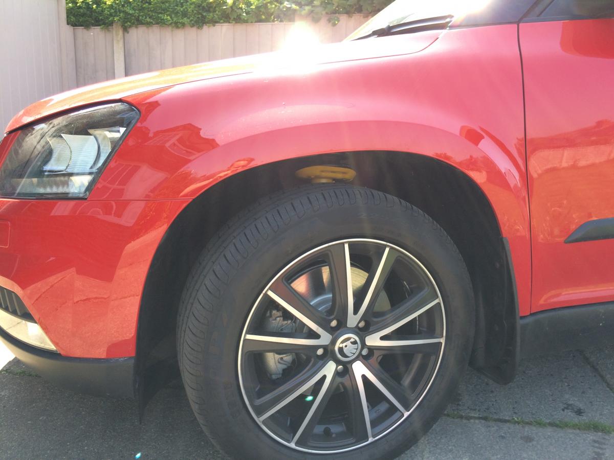

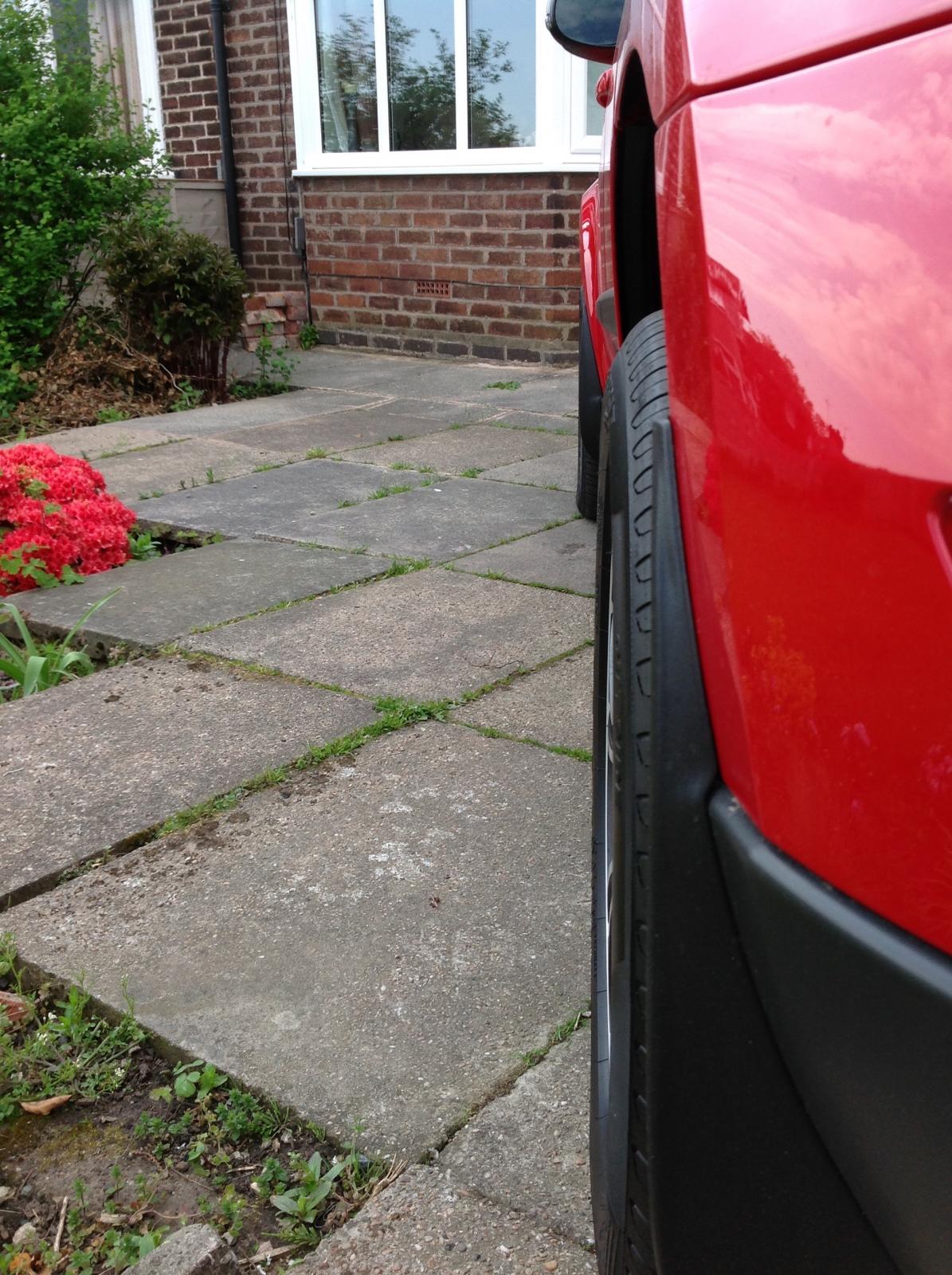

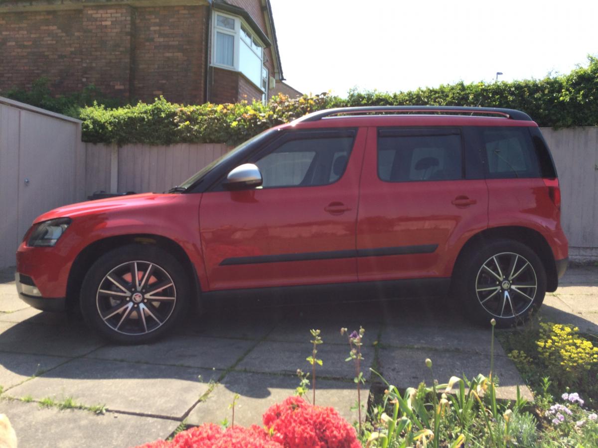

Well, here are a couple of pics showing the stance and ride height :)
post-120571-0-21394900-1463072328_thumb.jpegpost-120571-0-26474400-1463072416_thumb.jpeg
Looks good - bit more hunkered down :)
I approve :) looks good
the existing front bump stops will get discarded as they are mono tube inverted shocks so the front bump stop is inside the shock and can't be seen
Thanks. What do the bellows attach to at the top?
