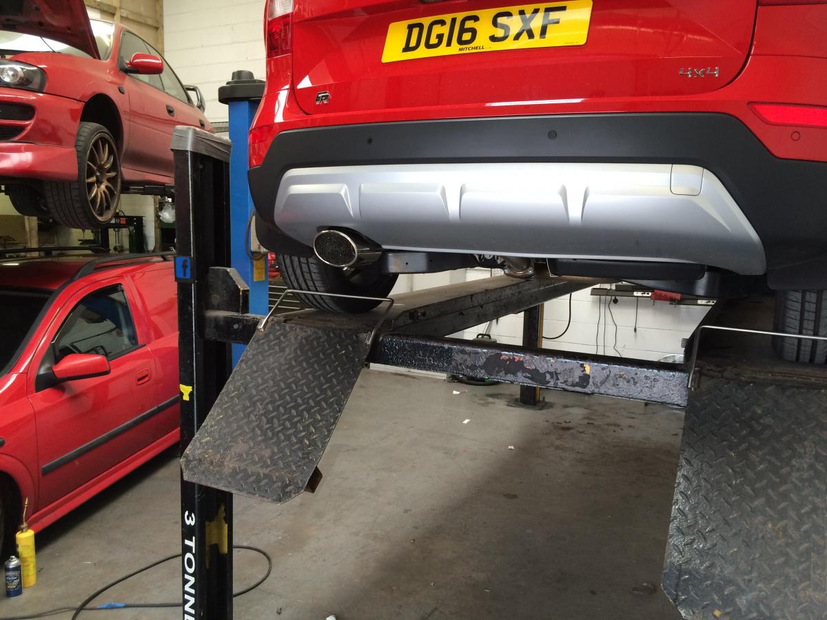

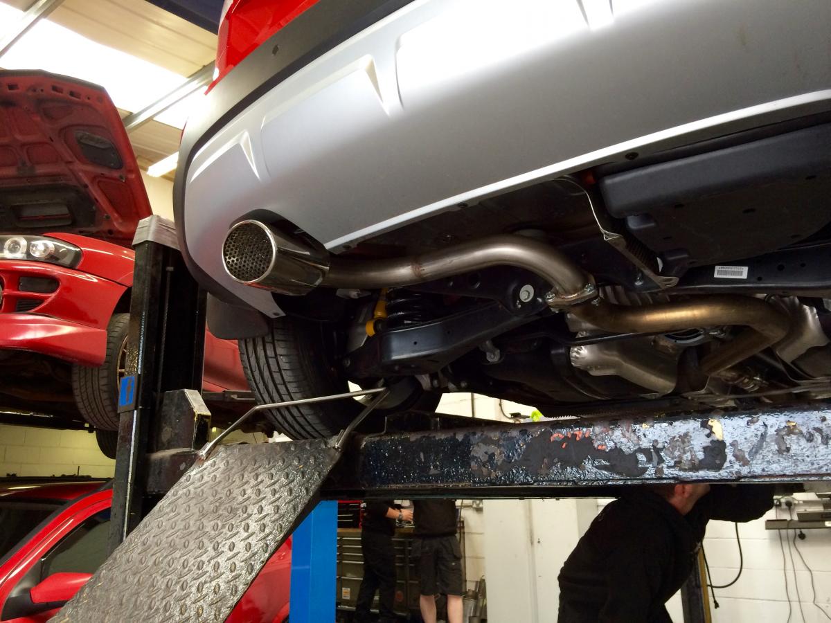

I know opinions are like farts, everybody has them :) but after Bedford my thoughts have turned to the exhaust on the 2.0tdi project, so I'm looking to see what you think.
Due to the Adblue system options are rather limited on the exhaust or i would just transplant the Milltek from the Greenline and after a little research It seems Im left with one option at the moment.
I'm looking at a rear muffler delete, litterly removing it, keeping the existing tail pipes but putting in a straight pipe where the rear muffler was.
Obviously there are no performance gaines but from the research I've done it does give a nice sporty note. I've looked ar countless you tube cars but wondered if anyone has first hand experience with doing this on the 20tdi?
Another plus is that it's very easy to return to stock when the time comes :)
Edited by DarrellGB

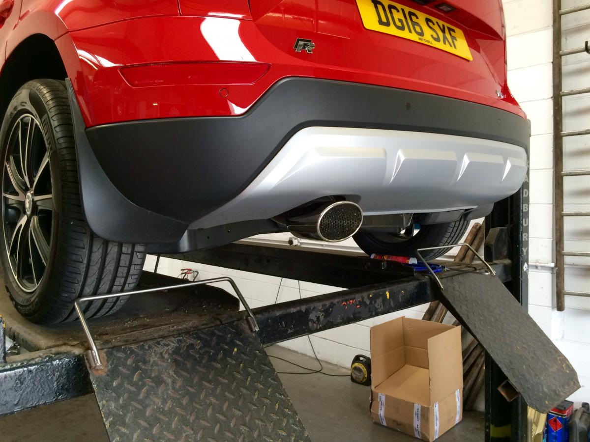

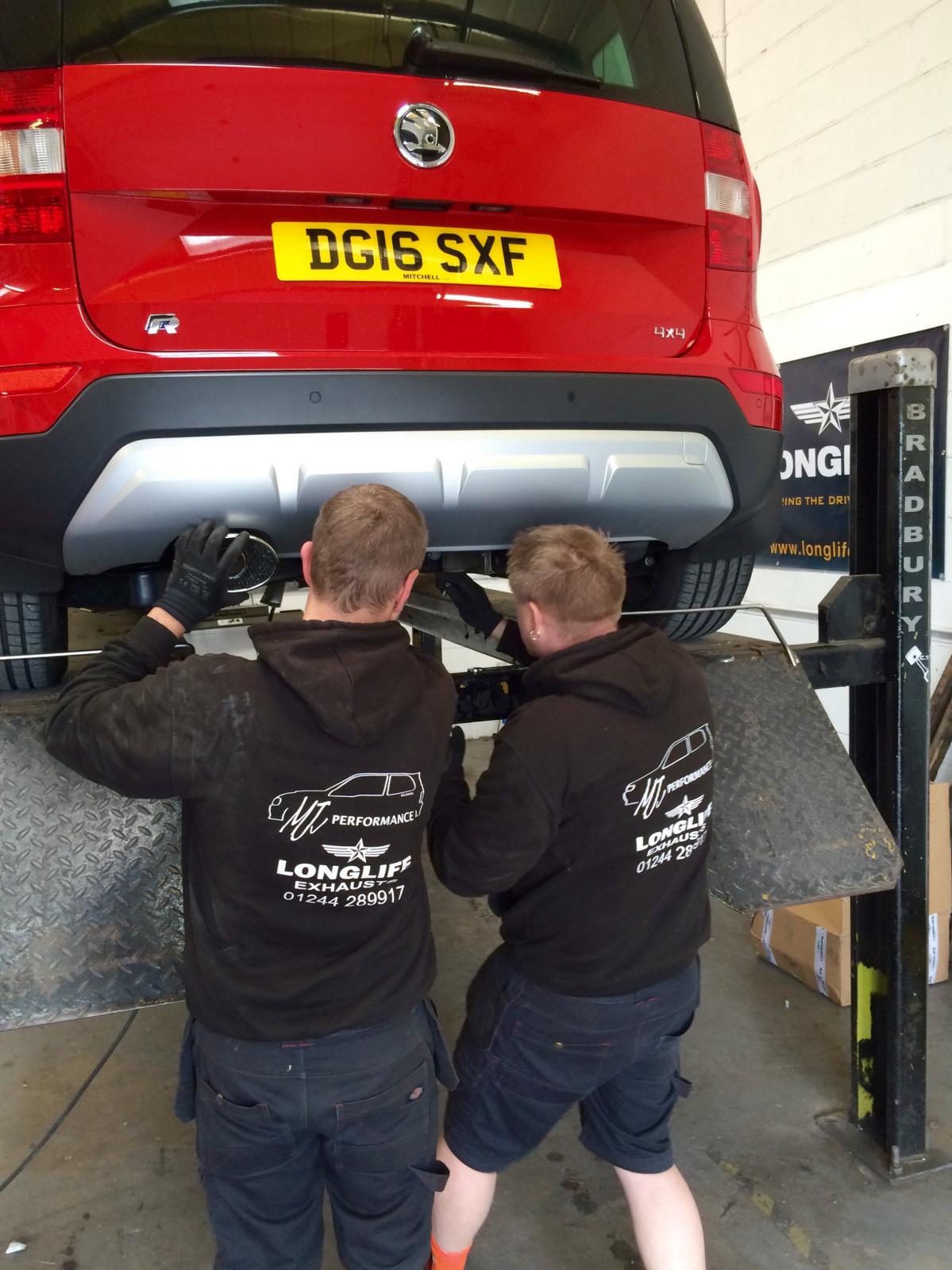

What do you think of the new tailpipe?

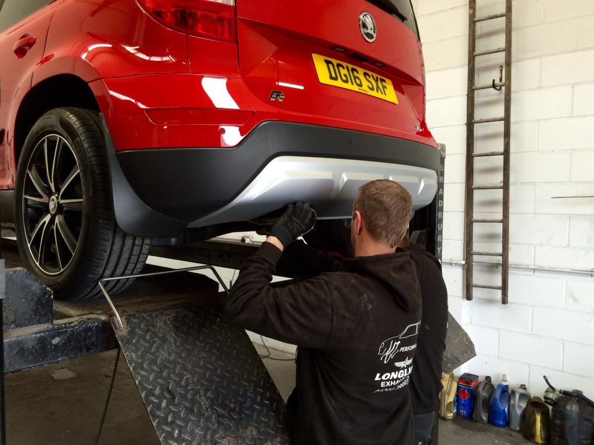

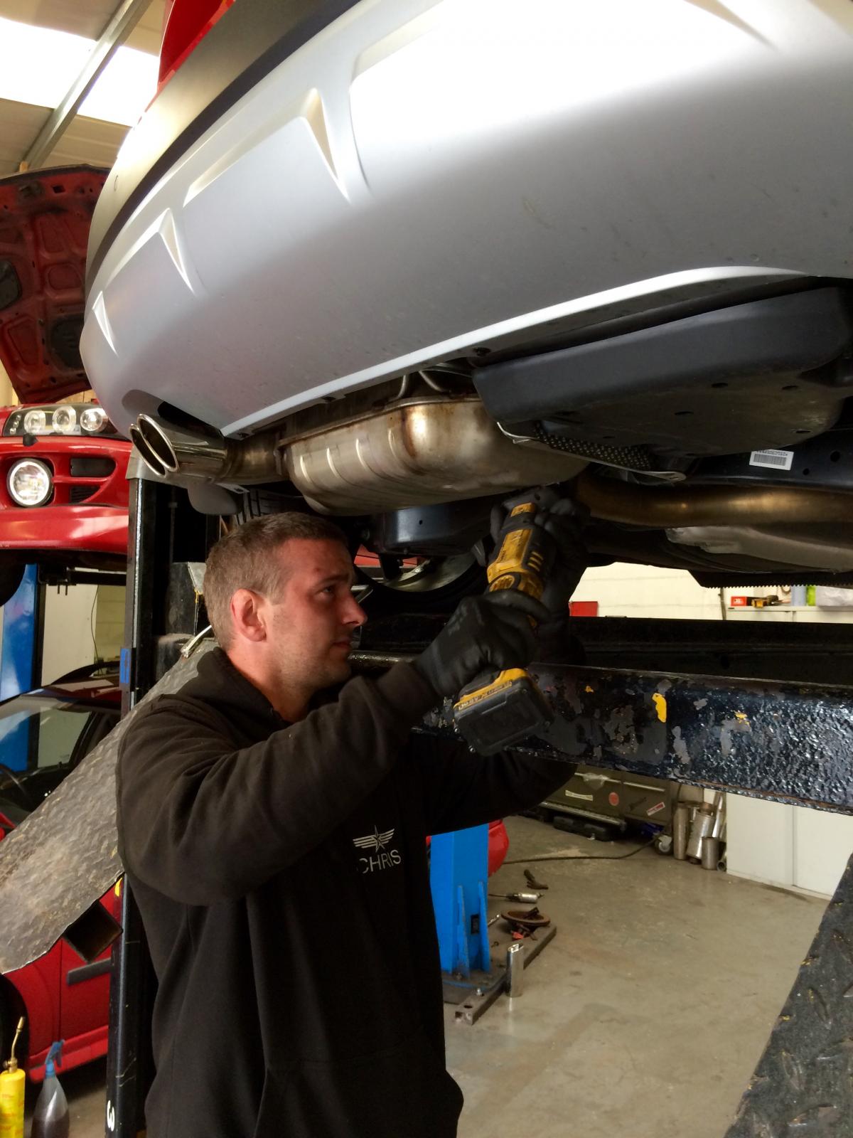

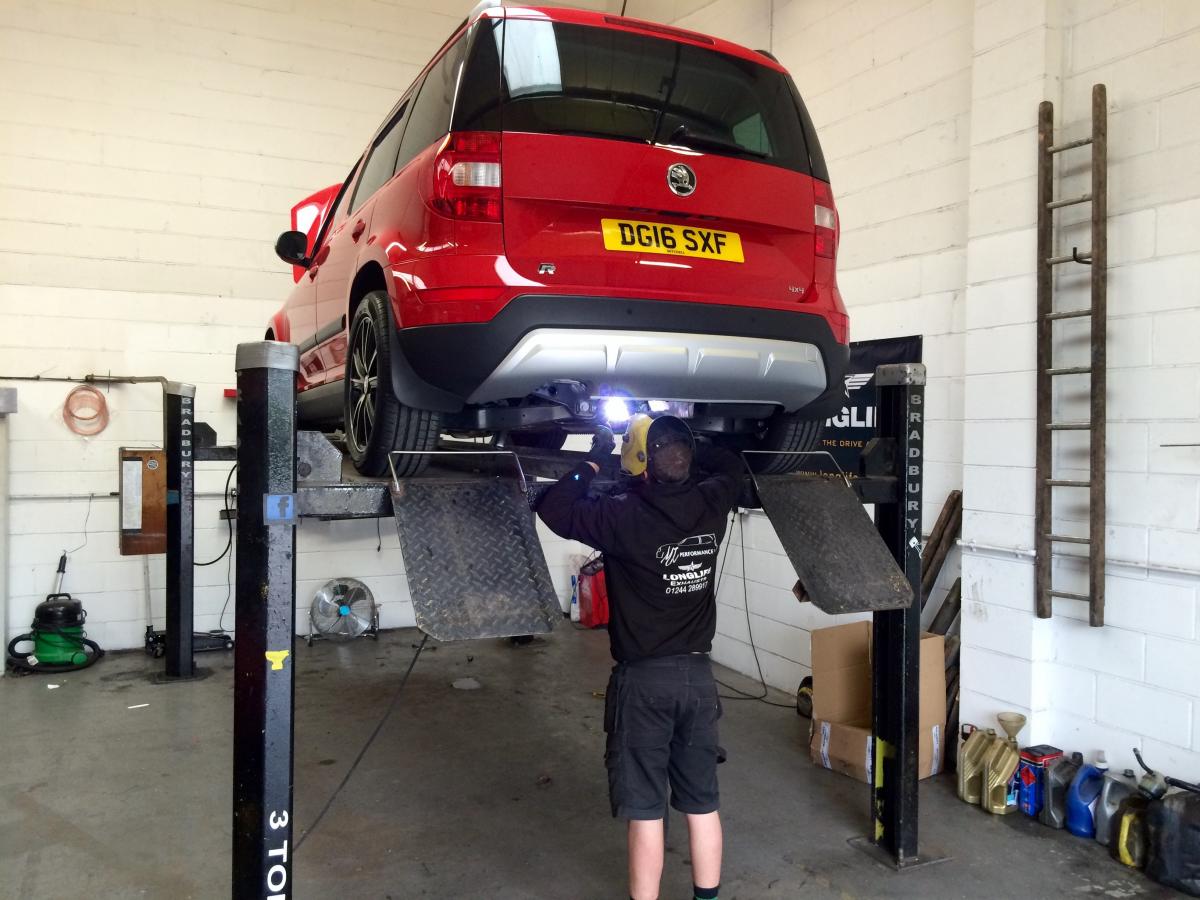

Mufflectomy done but the guys at LongLife Exhausts in Chester, cracking job and very professional set up.
I kept on changing my mind between keeping the stock look or going for something different. In the end, different won, a nice oval design which matches the bumper cut out perfectly.
I'm really pleased with it and the subtle but sporty note even with the DPF/Adblue constrictions , it sounds very nice :)
