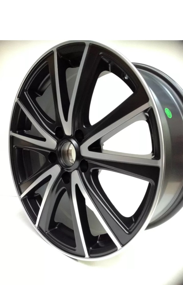

Well, I've gone and bought some wheels for the Yeti, think they will look rather good on, also got hold of some 15mm Spacers from Gizmo68, should look nice once lowered aswell :)
Just need some Skoda centre caps to finish them off nicely.
Edited by DarrellGB
