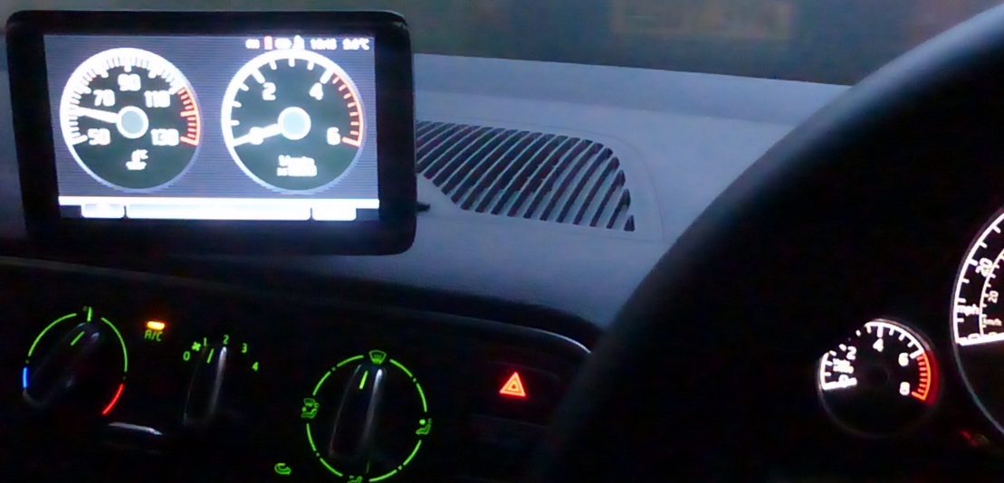

I have just noticed (after 18 months of ownership) that the redline on the PID rev counter is different to the rev counter in the cars instrument cluster. On the PID its 4k and the cars instruments its 6k.
Does anyone else have this problem and did you solve it?

Just checked my PID and the red line starts at 6000 just like the dash' rev counter.

Mine is at 6000rpm, but the demonstrator I tried had the red line at 4000rpm on the PID.

Mine also red lines at 4k on the pid
Mine is also on the 4k mark, perhaps its to do with the engine size? People have said that the 60ps is just noise past the 4k mark, I tend to find it useful, if I need to accelerate quickly I always change at 4k and not 6k

Well the Citigo has returned un-changed. They looked at the coding for the car and said that did not make any difference to the PID. Apparently they tried a new PID and that defaulted to a Citigo Diesel as well. So they are now going back to Skoda technical and Garmin to see what the next step is? I won't hold my breath as Garmin still have not contacted me after a month of sending my email. So the stopwatch is running.

Today I get a call from my Skoda dealer. They asked me to contact Garmin technical. I spoke to a nice chap who tried to help with the problem. I was asked to carry out a factory reset. However when going to Navigon Fresh to carry out a restore it detects my PID as a SKODA Portable systems DRF. So no point carrying out a factory reset on our PID.
Garmin Said that the PID gets a code from the Citigo when its paired to give it the correct fuel info. So they say it is probably a Skoda coding issue???

I carried out a full factory reset on the PID and updated the software as follows:
7.6.6 has 6K redline
7.10.15 has 6K redline
7.10.25 has to be connected to the Citigo before you can use it and on our car the PID recognises it as a Diesel.
Apparently its the radio unit that sets the fuel type.
Garmin said that the information about the car model or fuel type is stored in the car radio. Perhaps, a wrong radio was installed in the vehicle, which returns an incorrect value. The car dealer has the ability to read the vehicle data with his ODIS and check them.
So back to the dealer to see what can be done!! (Hopefully not at the garage for two days)
