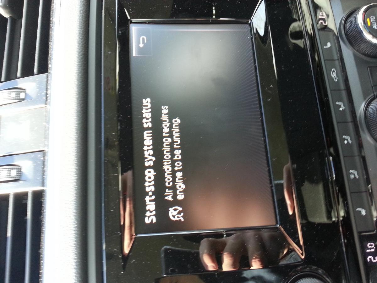

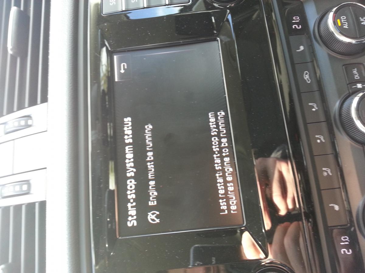

In the three days I have owned the car I have had three errors with the start stop system, two different error messages as seen in the attached photos..
The errors do not make sense since the engine was running in all cases..
And whats up with the aircondtioning error occuring under the start-stop system?
AC was off btw, and not trying to turn it on..
Anyone else had these?

That makes sense, but the AC was not turned on..

There's loads of other reasons stop-start won't work but another common reason is due to being mid dpf regen (on mine at least)

Weather or not you have the AC button lit up or not doesn't necessarily mean the compressor is running/stopped.
As far as I've understood they're no longer the old type that is either on or off, but instead vary their circulation speed continuously based on conditions. It's usually a good idea to leave the system on Auto and let it decide how much cooling is required based on your slected temperature. Otherwise it'll just keep it running on the minimum setting and use higher fan speed to compensate.
Looking at the photo the a/c is set to auto. Last summer I was stuck in traffic and the car auto stopped but after about five minutes it restarted cooled the car then when off again.  I was quite impressed!
I get the other message "engine must be running", I have put this down to a DPF regen.

These are not Stop/Start errors..!!!!
They are just messages informing you about the state of the Stop/Start system so that you can understand why the engine has restarted on does not stop when you might expect it.
"Engine Must Be Running" means the stop/start system cannot stop because one of the systems in the car requires the engine to be runnning.
Usually this means that the DPF is in regen or has recently finished so needs to cool down the engine/exhaust.
"AC Requires engine to be runnning" refers to any part of the climate system requesting that the engine stay running not just if you have air-conditioning.
e.g. the current temperature is more than a certain amount below the temperature requested or the air is humid so the climate system wants to keep the windscreen clear.
These are perfectly normal message & don't indicate any errors with the Stop/Start system at all.
Everything is working at is should.

If you've not got the A/C in auto and the fans arn't blowing more than the Auto setting would have them (fan speed indicator light goes out at Auto speed) then the only part of the A/C system that can be keeping the A/C going is the Glove Box cooling. Check the roller temp. selector is turned fully off ie. 0 and not the frost symbol
It was on because the setting "Auto" is on, when on Auto AC is in fact turned on. AC does not just cool interiors, it works well in the colder months by reducing the moisture in the air thus reducing misting inside the car. You basically pass the cooled air across the heater matrix, so you get hot air out the vents with no moisture.
