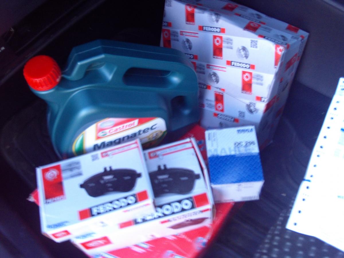

4 new Ferodo Discs and sets of pads cost me £104.04 including VAT (and a £3.50 Oil Filter), these are for a Mk2 Skoda Fabia.
Pretty much the same Discs and Pads as for the Yeti.

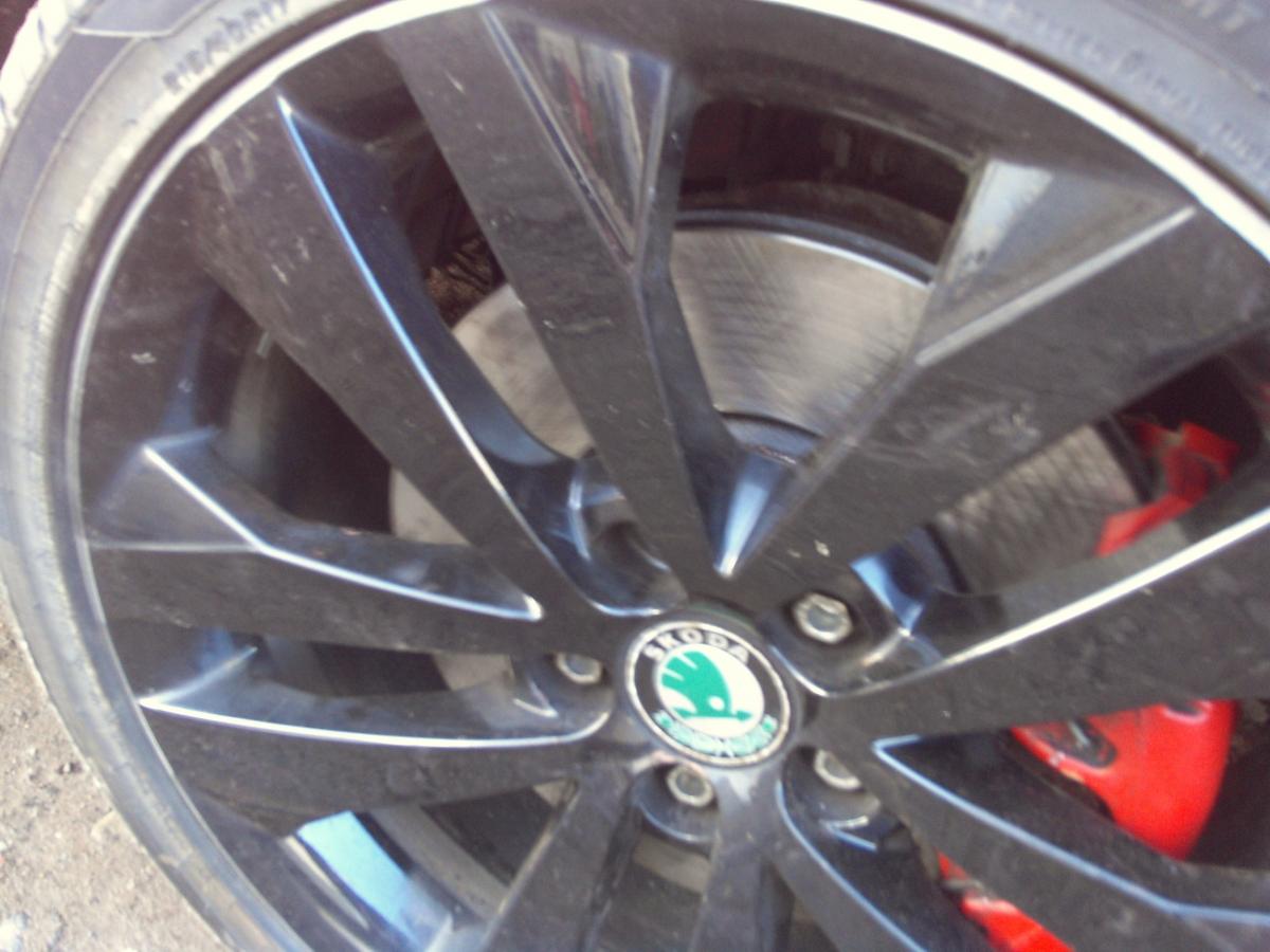

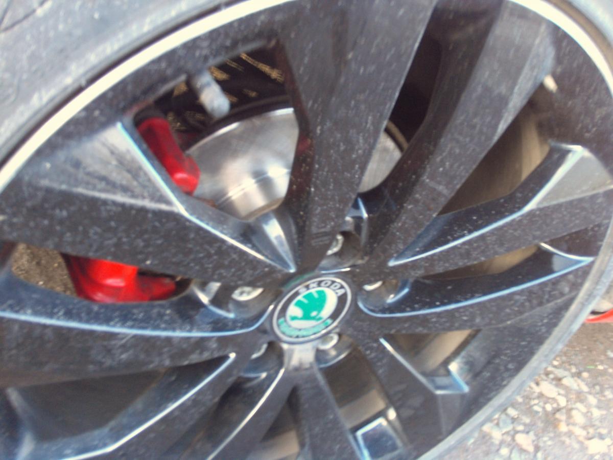

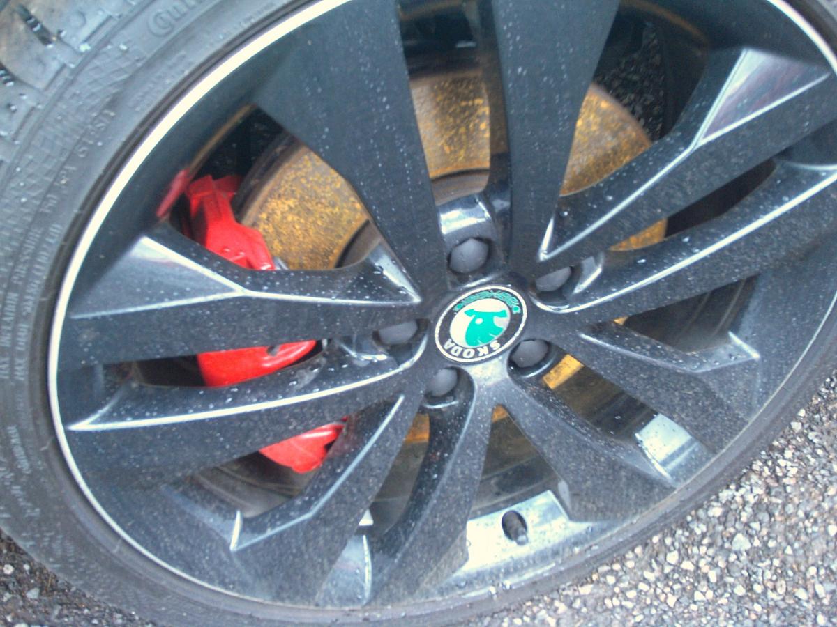

Rusted Discs in the pictures at the right hand side an Example of a Demonstrator with under 1,000 miles on  Main Dealers Forecourt.
