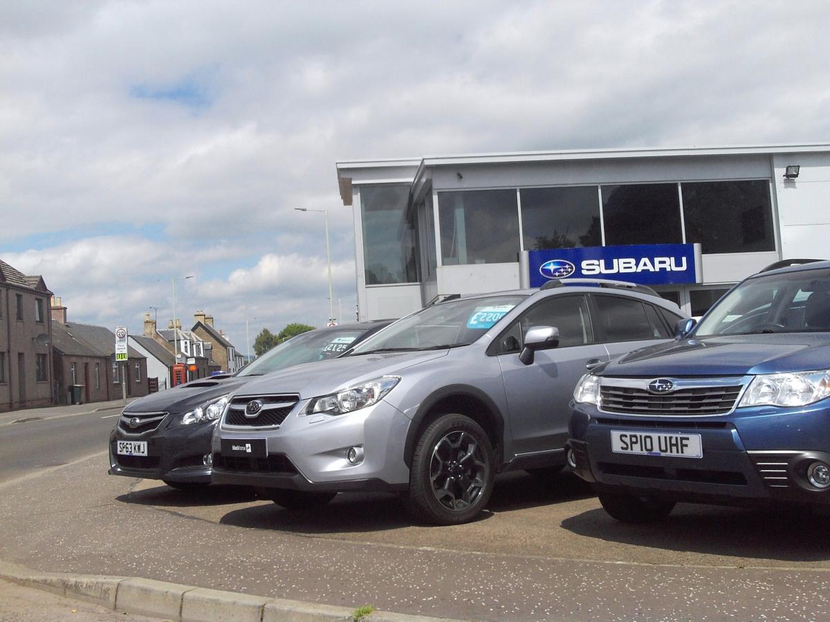

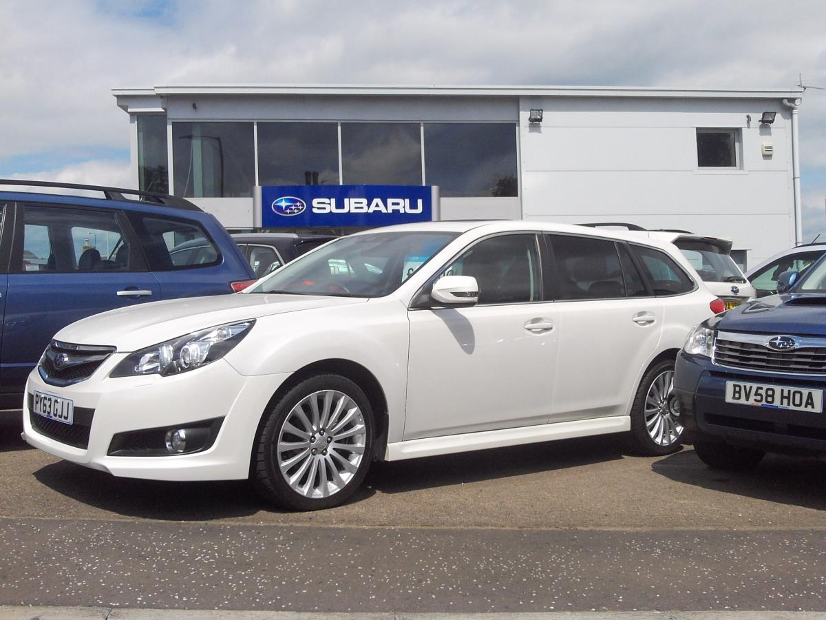

My local Skoda Dealership has relocated, so a Subaru Dealership has taken the premises over.
I will be looking at the Sales cars Discs over the next few months to see if it was only their  Dealership
near the sea that had so many corroded disc brakes on cars on the lot.
