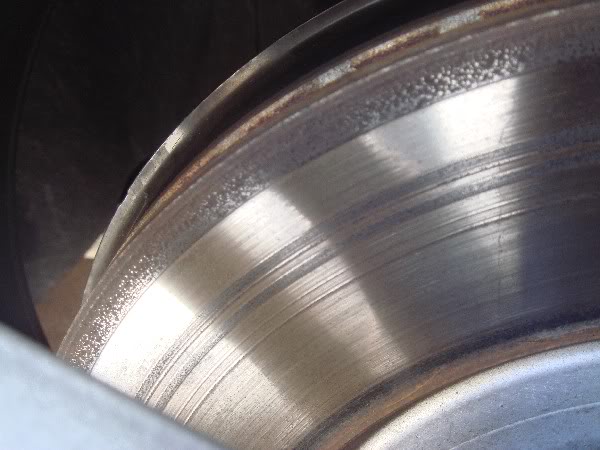

Continual rubbing on a metal surface will over years wear down that metal surface.
There is a difference from a Braking Surface and another braking surface coming together and friction causing a braking effect.
A nice shiny disc and a flat surface, maybe a lip where the pad finishes and does not reduce the discs thickness.
The Surface getting scoring,
ie grooves being cut into the Disc because the hard rusted particles caught in the pad are cutting groves.

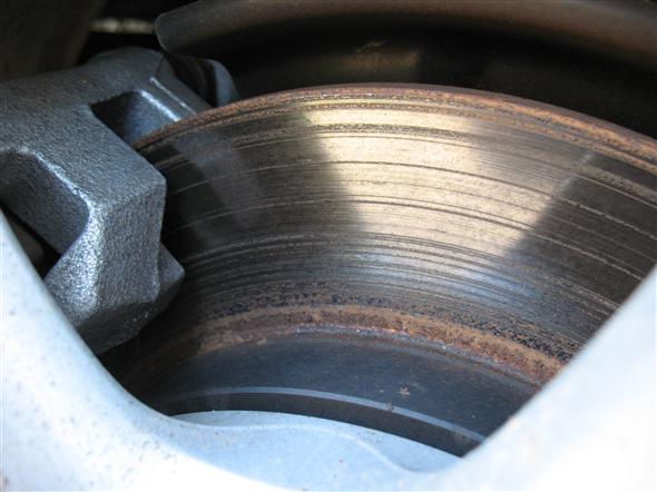

These were advisory at MOT last December.
I took one look when home and changed them immediately
Some would never have put a vehicle in for a MOT or even driven a vehicle with pads in that state.
Anyone with knowledge of vehicle mechanics should be ashamed IMO.
So what was the vehicle were they on and how old, or how many miles had they been fitted for.?
