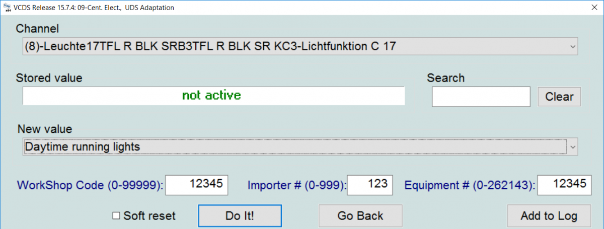

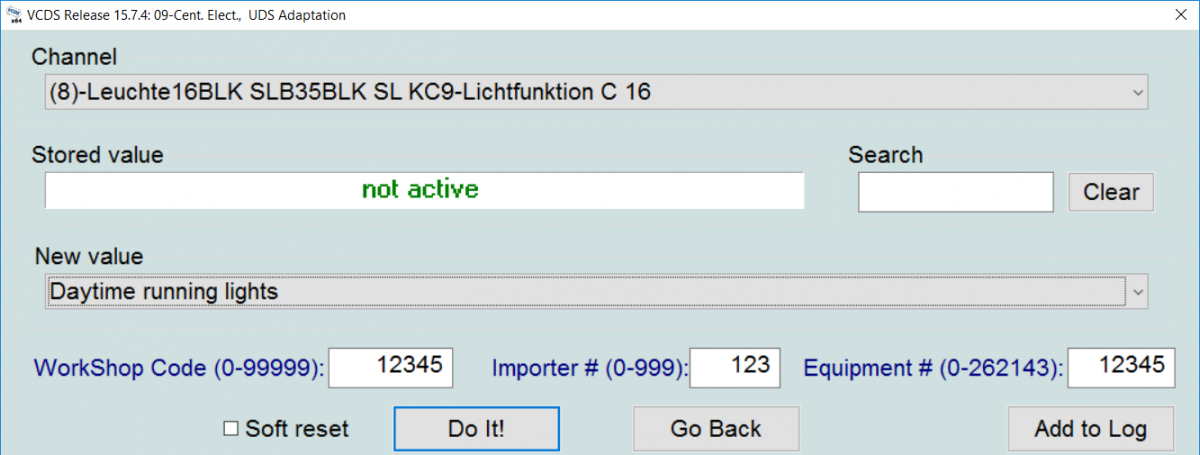

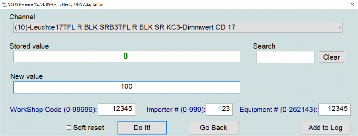

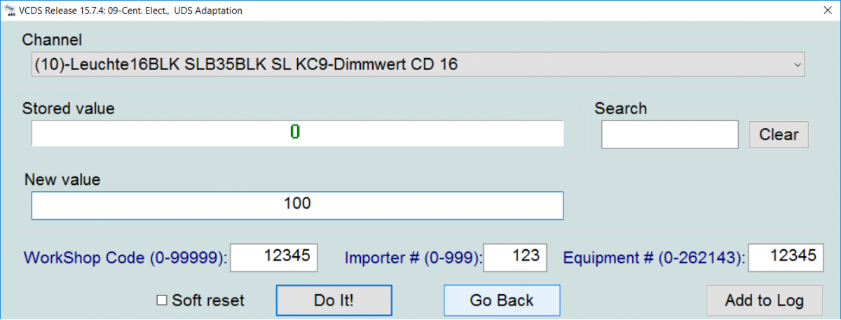

Coding Eyelashes always on in the headlights S3
Module 09
Login 31347
Go to Adaption
Change (8)Leuchte17TFL R BLK ......... C17 to Daytime running lights
Change (10)Leuchte17TFL R BLK ......... CD17 to 100
Change (8)Leuchte16BLK SLB ......... C16 to Daytime running lights
Change (10)Leuchte16BLK SLB......... CD16 to 100

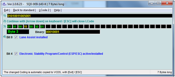

The last rule is not (always)right. I found out that the S3 i had you have to change in module 44 Byte 3 Bit 0. See attachmentpost-71204-0-82397900-1464285641_thumb.png

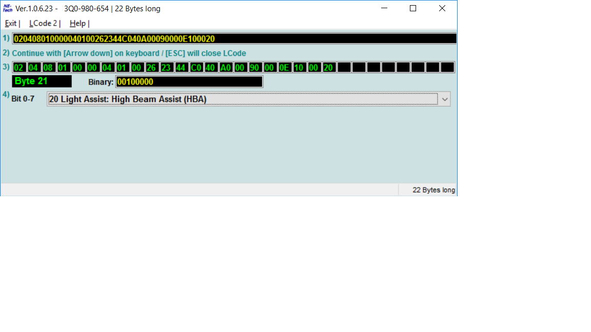

Activating High beam assist on the SuperB:
·         Go to Module 09
·         Login
·         31347
·         Adaption
·         Go to: (2) Assistant light functions - Menu light assistant
·         Change to Present
·         Coding
·         Long Coding
·         Byte 3
·         Bit 2 aanvinken
·         Go to module A5
·         Login
·         20103
·         Long Coding
·         Go to Byte 21
·         Change to  High Beam Assist or change to "20"
