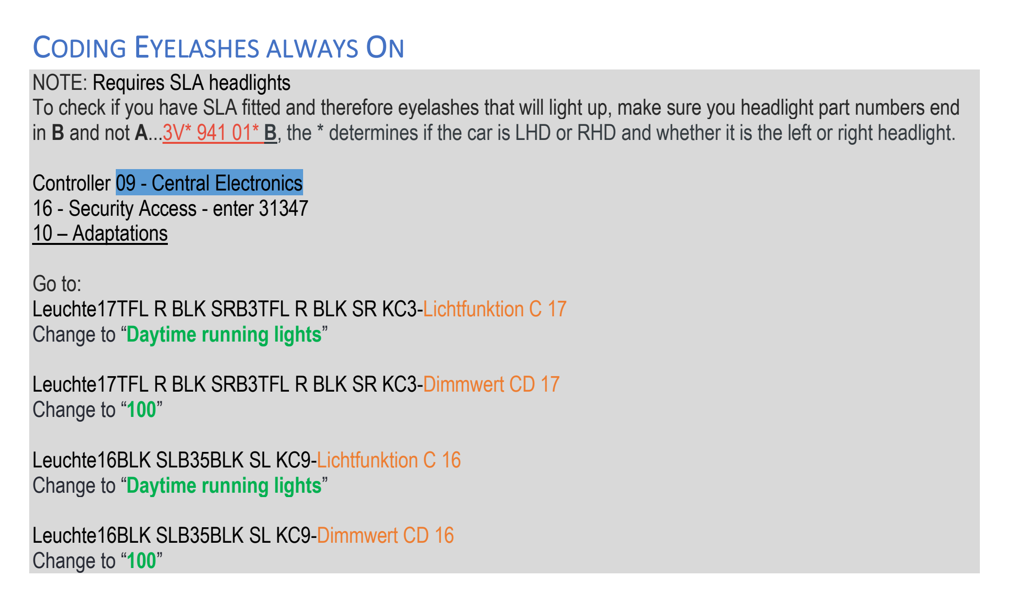

Hi,
I'm really interested in "eyelash'es" of my front headlights. My S3 MY16 has got SLA, so it suppose to be easy task to make it shine, but all tutorials are made with older vcds software versions. Does anybody could explain how to do this with vcds 18.9, please? 1st problem is that i'm dont know german language, 2nd problem is representation of chanel list in 09 block is completely different (i. e. IDE*****-ENG*****-*** or etc.).
Thanks for everybody in advace.

I'm pretty sure I used 18.9 to code my eyelashes.
Use the search function - don't go by the IDExxxx numbers
