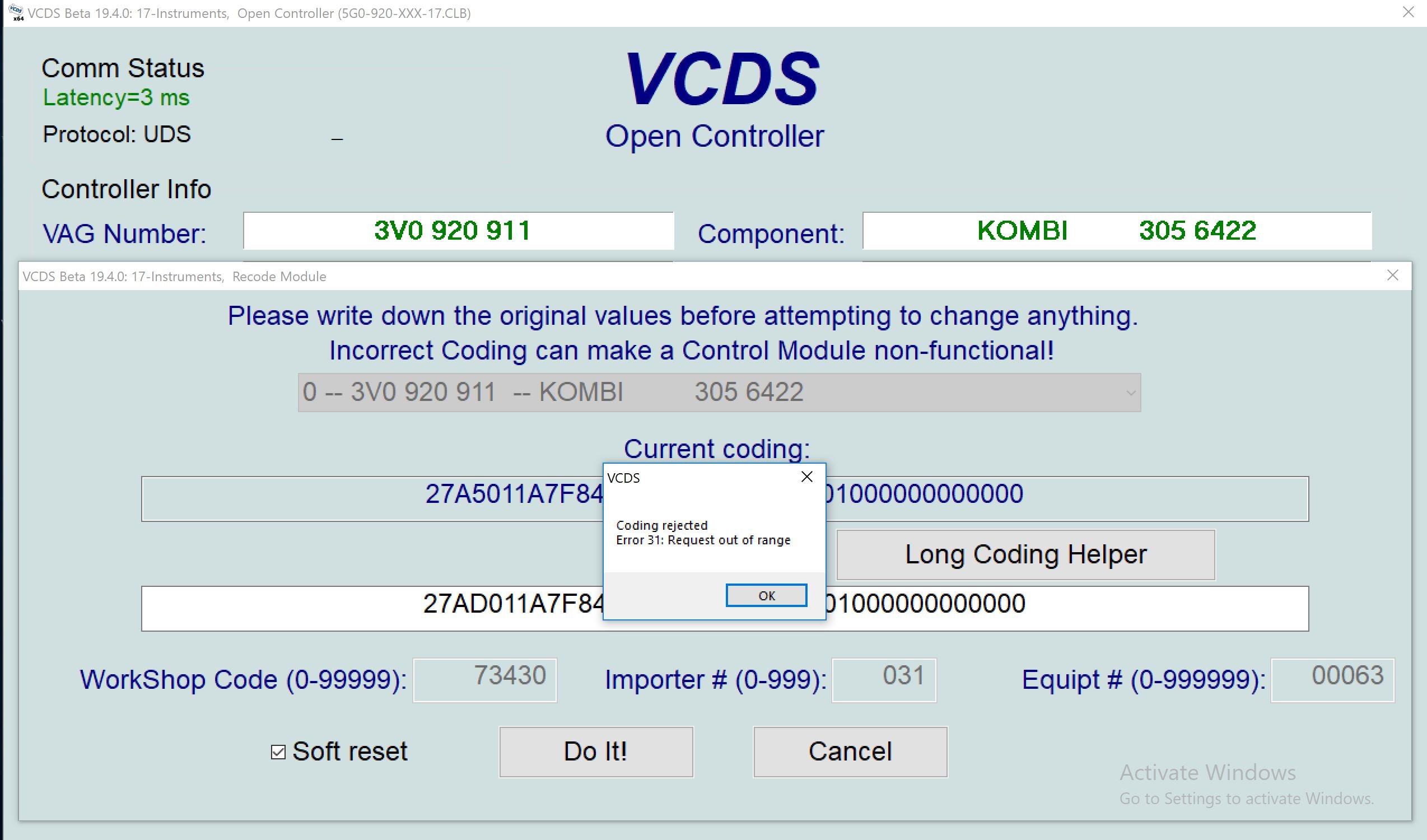

Here you go, MY16 L&K:
Address 17: Instruments (J285)       Labels: 5G0-920-XXX-17.clb
   Part No SW: 3V0 920 911     HW: 3V0 920 911
   Component: KOMBI         305 6422
   Coding: 27A5011A7F84A600008B7E0B5001000000000000
   Shop #: WSC 73430 031 00063
   ASAM Dataset: EV_DashBoardVDDMQBAB 009046
   ROD: EV_DashBoardVDDMQBAB_009_SK37.rod
   VCID: 6FAE16E0B613573A55-803A
No fault code found.
I only talk about mk3, not mk2.
In Germany, there are other cluster installed. For example : 3V0 920 710 A
I have activated it on several Superb mk3 and had never the message of "out of range".
I think the UK cluster are completely different

@djduese I have a french MK3, and I face the same error message as Gizmo. It doesn't seem to be specific to UK models.

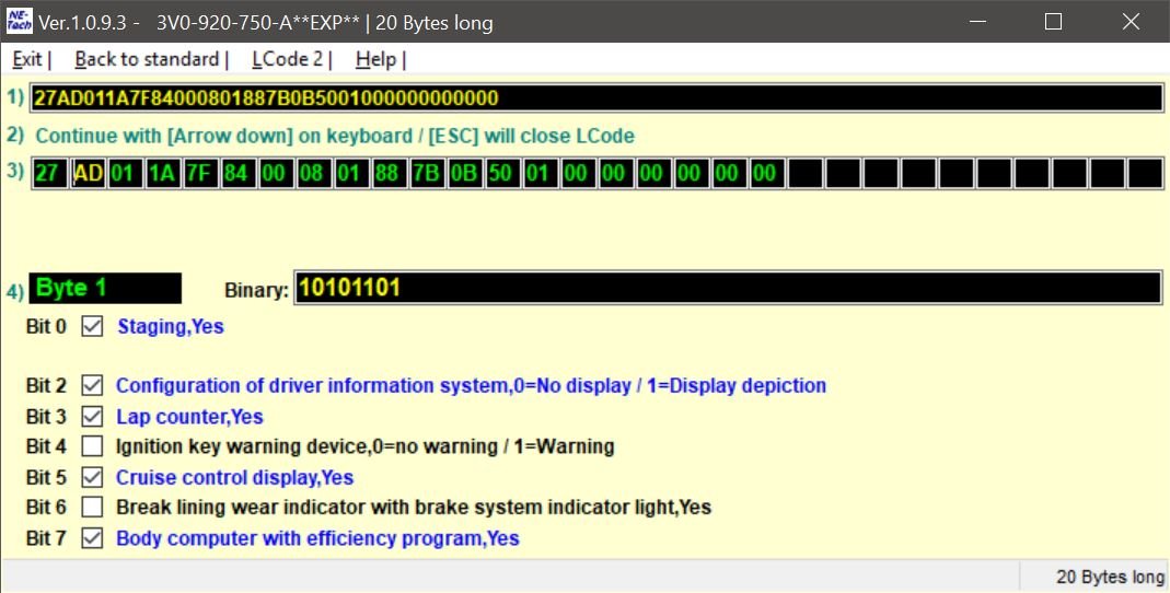

I have another scan from a Superb I coded. It has the part number 3V0 920 750.
Performance Monitor can not be activated per coding

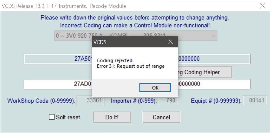

i just tried it, to enable the lap timer - sadly code rejected 😞
Controller 17, Byte 01, Bit 3
Edited by JR RS
