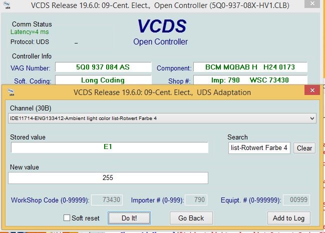

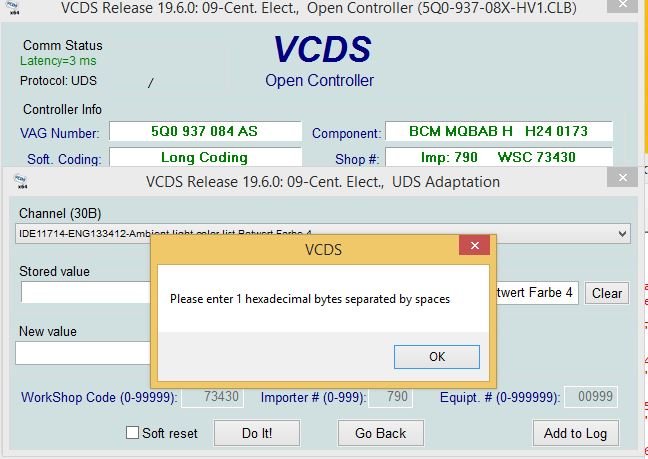

Hello Colleagues,
today i tried to extend ambient interior colors from 3 to 10.  Car is Superb 2015 with columbus MIB1
IDE09731-ENG125017-Int. light: 2nd generation-Instrumententafelbeleuchtung mehrfarbig - Set to Active
IDE09732-ENG02312-Interior light: light configuration-Ambient_Farbliste_HMI - Set to Active
Interior light: light configuration-Frei_Farbwahl_ueber_HMI - Set to Active
After that i tried to change RGB color number 4. Actual value is E1 in hexadecimal. i am little bit surprised. Is it normal ?
Edited by rrozbroj
6 hours ago, rrozbroj said:
Hello Colleagues,
I don't believe u can do this to the pre-2017 Superbs as the 3 light LED stripes are physically a different unit to the 10 light LED version.
Edited by JR RS

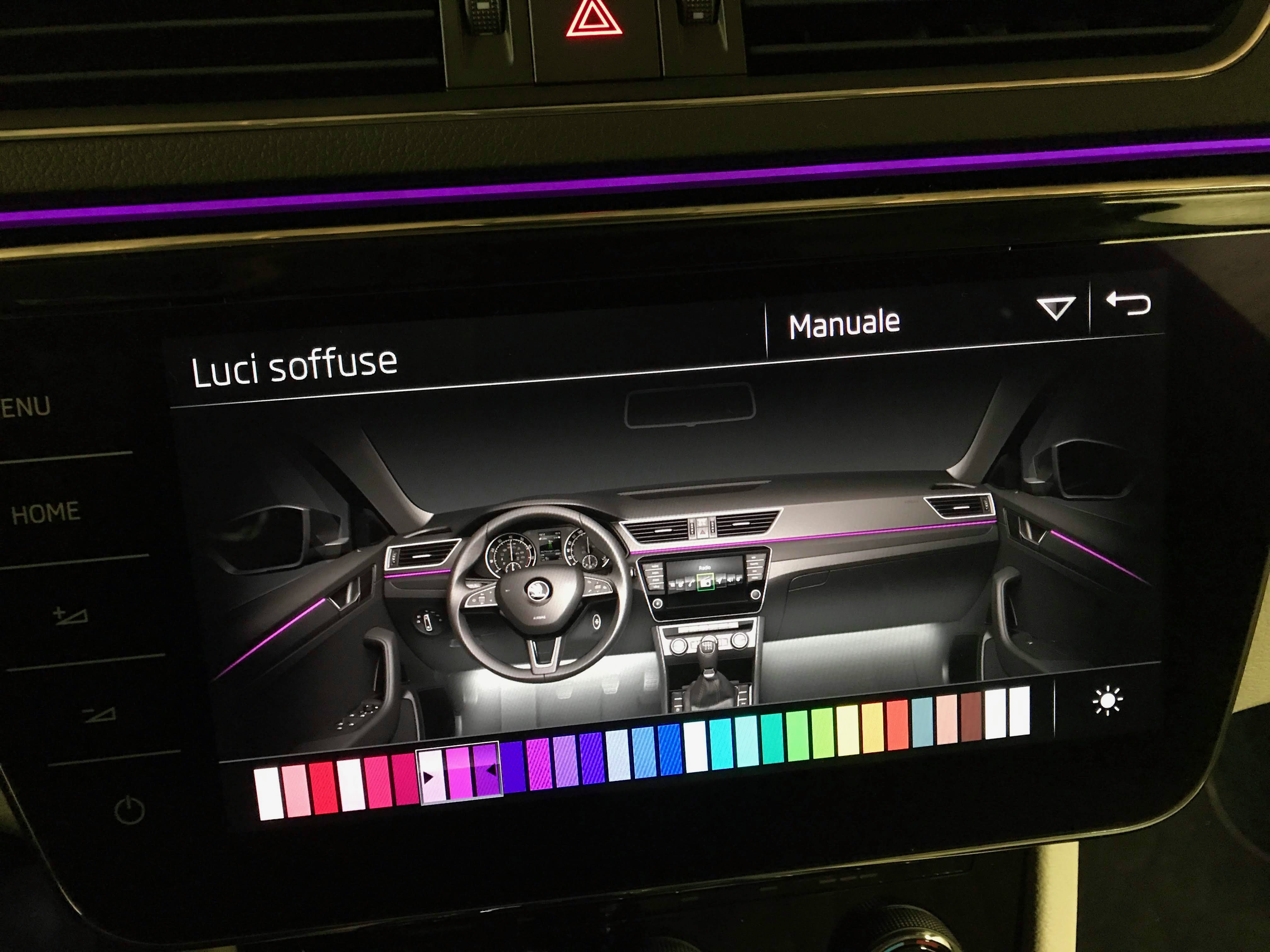

Hello can someone please post the 2017+ rgb colors codes ( with a picture fo color) please.
I have a 2016 version. with only   3 and i don´t like none, so i have changed the warm light to cold ( the one in the vcds option) but i would like to change the other 2 to ones i like.
Thank you

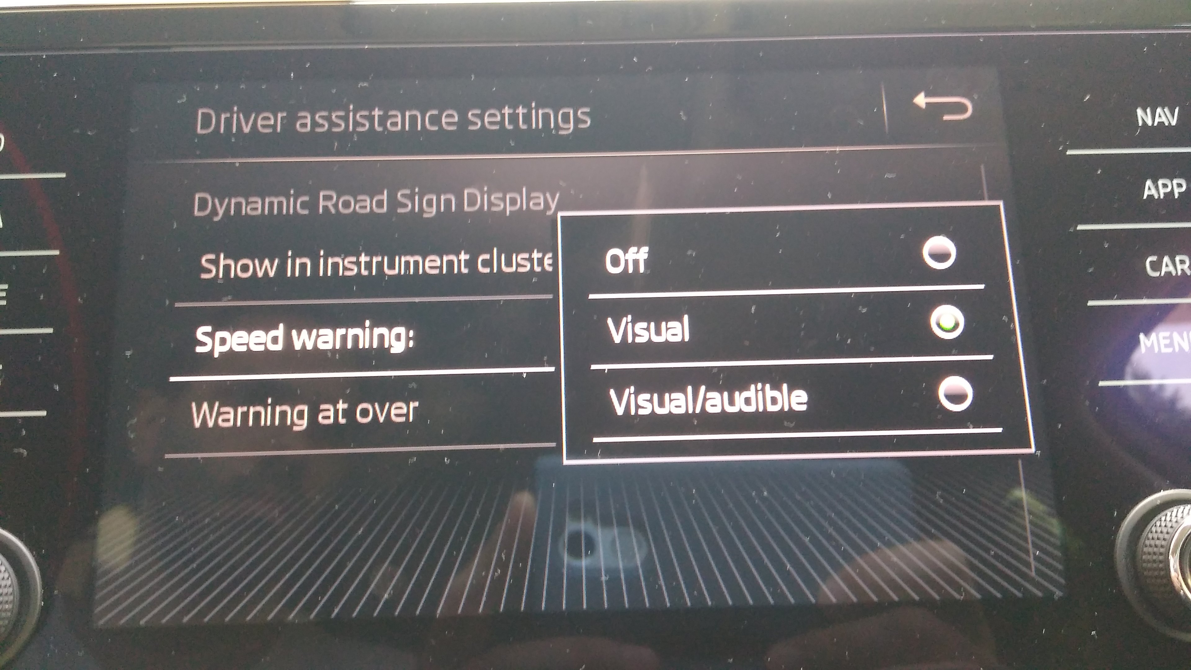

I have a question for the enthusiasts. Is there a way to stop bing sound for speed limit exceeding?
 I'd like to be notified by visual warnings only.
Yes you can turn that off in the maxidot, you will lose the visual warning as well though.
In my MY19 superb you can select visual warning only from the infotainment system configuration - this is how I configured my car.
Thanks for the response, unfortunately MY2016 doesnt have a setting like this, I wonder if it is possible via VCDS
