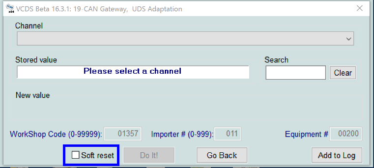

On 15/08/2019 at 14:22, Bap33 said:
How did you do that?
I’ve tried 2-3 times, but never succeeded in my MY17 L&K...
Did you make a soft reset at the end? I have to say, I didn’t on each of my attempts... 🤔
Thanks for your answers
I just followed the instructions on this thread for it. I’m not sure what you mean be a soft reset - if you mean a restart of the ignition I always do this after coding.
Mine is a 16 plate with the older Columbus with buttons either side of it.
A soft rest can be useful when coding anything to do with the infotainment system.
Ok, I’ll try again...
Thanks
