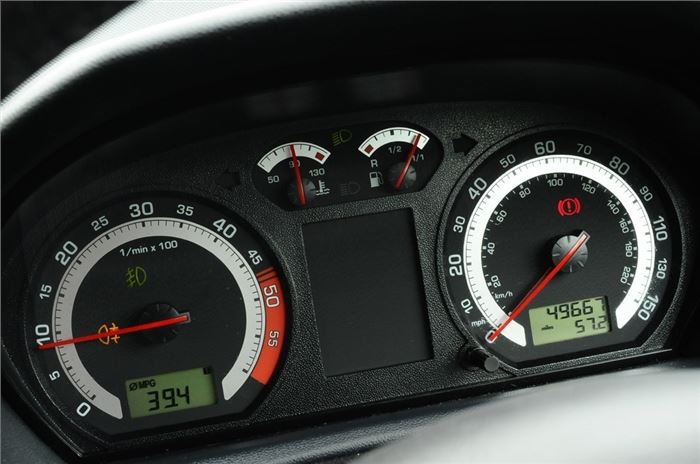

The left hand LCD on a car with a trip computer is different to the basic one with just a clock.
You can see they are different as the trip computer LCD has space at the top for the MPG icons etc.
Basic:
Trip Computer:
Skoda%20Fabia%20vRS%20(2003-2007)%20(16)
Has anyone done this - the left hand lcd looks the same size in both jpgs - what it can display is the issue, I guess.
The LCD is the same physical size, if you look at the actual digits on the two displays, you'll see they're different.
The basic display only has the segments to display a clock.

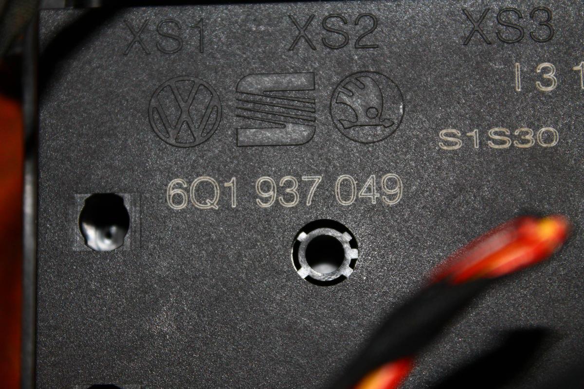

got the speedo cluster and 6Q1 comfort module today, now just need them coded
