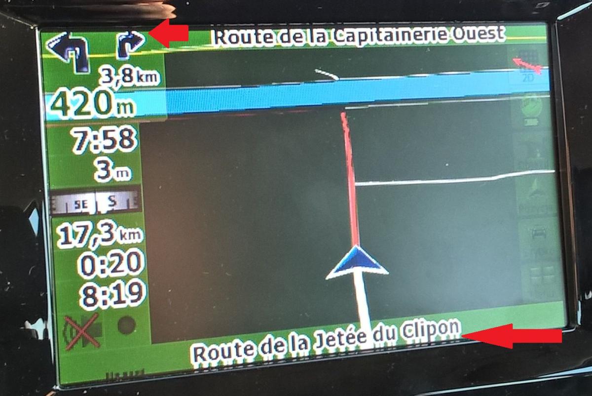

Note1: there is a vertical shift by few pixels (marked with arrows). It's visible when using iGO 8 as shown. If you use iGO Primo problem is not visible.

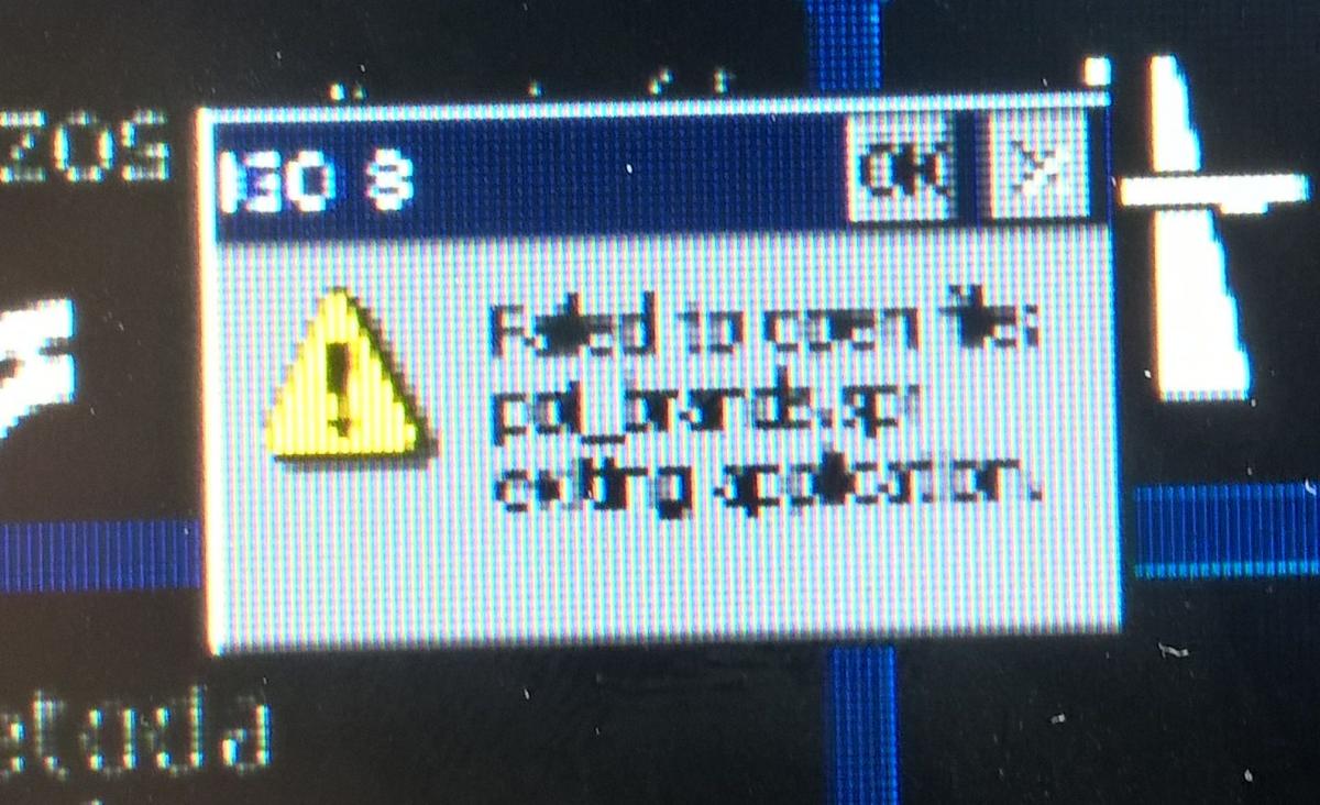

Note3: In my case, sometimes when map was switching day/night mode, I was getting error (attahced) and had to reset. I disabled night mode as auto dimming works well in bolero and problem is gone. Btw, resetting is done by long press of the right-lower hardware button of bolero.

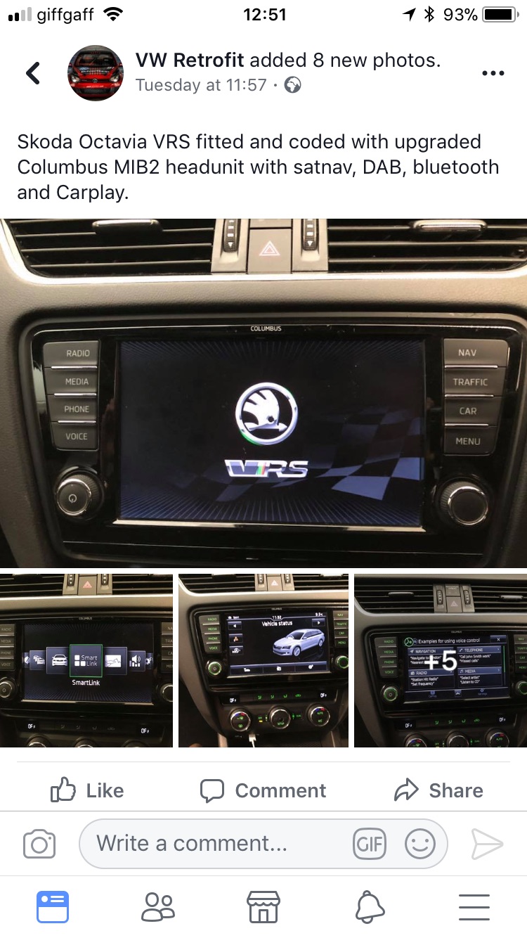

Not had any dealings with Alex but saw him at VAG Tuner last year. He has posted this on his Facebook page.
