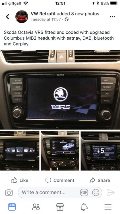

There are multiple companies fitting factory Columbus systems(both MIB1 and MIB2) here in Denmark. The other company is VagStyle, they don't have a webpage as such but are present on Facebook instead where they post images of their work and respond to messages.
https://www.facebook.com/vagstyle/
CarTrends and VagStyle are situated in different parts of the country, i've personally used CarTrends to have him fit a factory/Original towbar on my Octavia, and he did a stellar job :) Next on my list is the Columbus ;)
While i was in he had a brand new Polo 6C(driven 8km, still in transport mode) a dealer had delivered to him for fitting of parking sensors back and front(of course original with Park-Assist).
And a brand new Octavia that was in for an upgrade from Bolero + Canton to Columbus MIB2 + Canton :)
