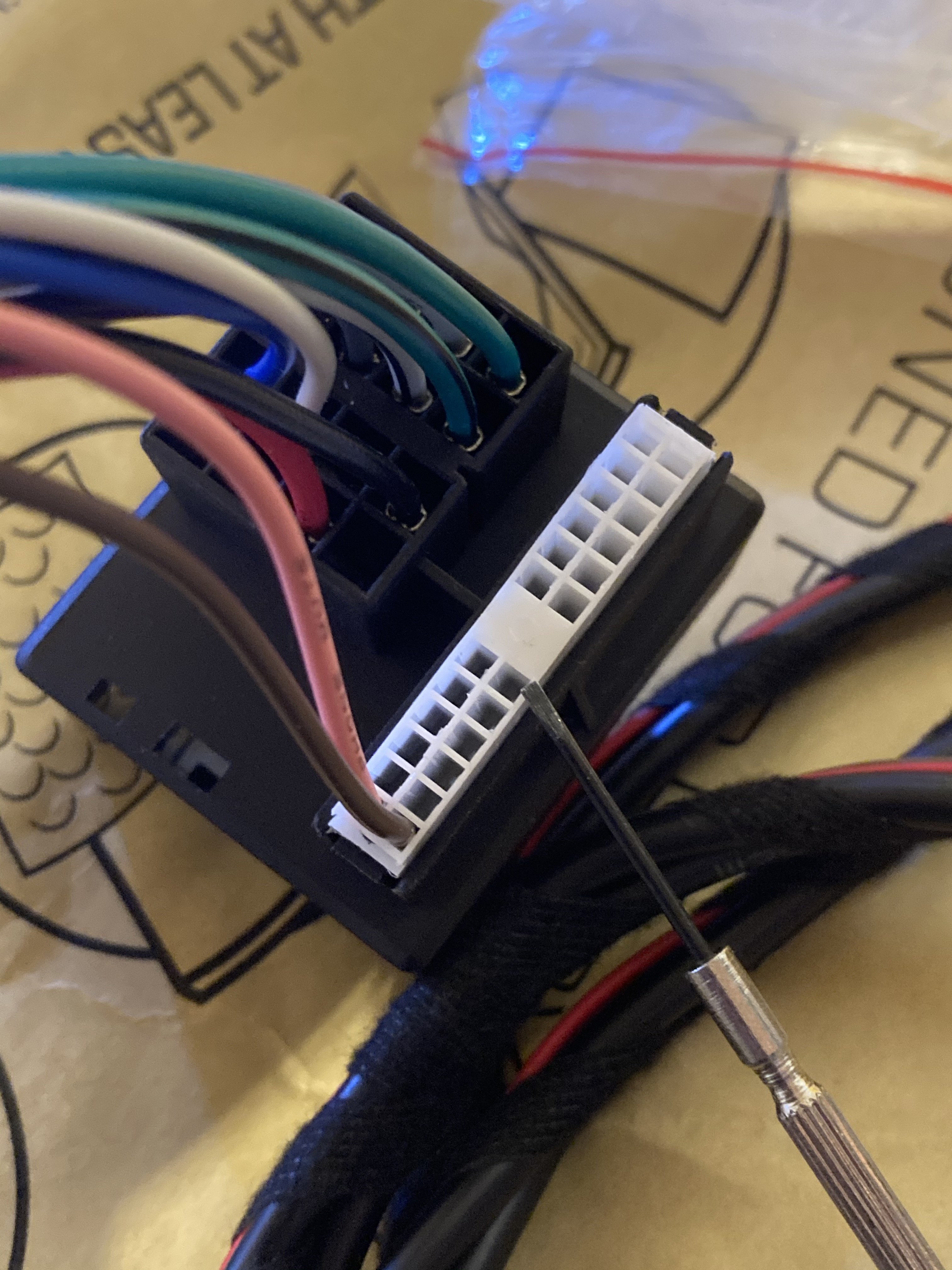

If anyone else gets the adapter of finest Chinesium (like this one I have: https://www.amazon.co.uk/gp/product/B078SRXGT2). I've bought the same one and can confirm that the radio side of the adapter you do indeed need to move the pink and brown wires across form their original position to where I have pointed with the screwdriver. They also need to be swapped around as the polarity is incorrect in the shipped product.
original wiring as it arrives, screwdriver to where the wires need to shift to
wiring complete, can be done with a small jewellers screwdriver, white plastic block pops out and can be readily re-pined.

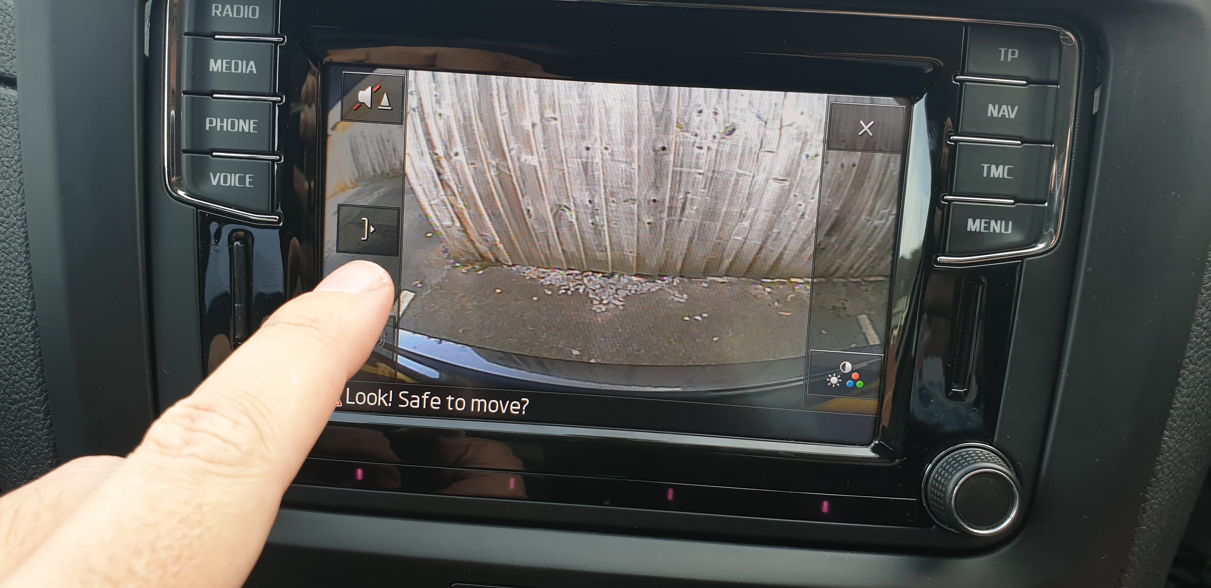

Ok, so I managed to spend an hour or two today installing one of China's finest trunk handle low line reversing cameras (surprisingly good for £16!!) and coded it up via VCDS. It all works as it should, however I don't have the option to show the PDC overlay on the camera feed, the camera has essentially replaced the Yeti PDC graphic.
I do have a little 'right arrow' icon on the left of the screen, but pressing it does nothing at all. The right hand options for brightness, contrast etc all work fine. Any ideas?
You might need to recode or replace the parking sensor module :)

If you haven't already, I'd try recoding the park assist module as I'm pretty sure it has a 'camera fitted' bit.
Yep, I had to recode the PDC bit to 30800E to get the camera to show, it wasn't enough to enable it via byte 17 in 5F.
Might eventually pick one up from a breakers etc then at some point, but won't let it bother me for now. Ta for clarifying.
