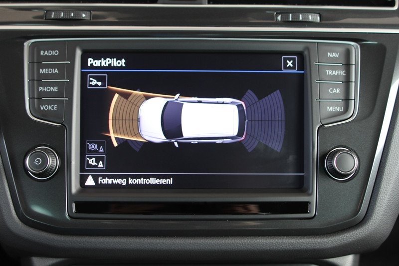

i have MIB2 unit 5L0 035 680 E, and PDC unit 1K8 919 472 A. I want "DYNAMIC PARKING LINES". How can i activate it?
Any one who has it, in VCDS, there are some errors? Somewhere I find that there are some errors, not registered or something liake that ... its due can filter for PQ cars? many thx for info. Daniel
At least on PQ35/46 cars, older CAN gateways don't support 5F which might result in a not registered error. It's trival to replace the CAN gateway with a newer one that does support 5F. On your Citigo this will be different as I think the CAN gateway is part of the BCM? Assuming the BCM is new enough to support 5F, you might just need to add 5F to the installation list.
Other than that, it'll probably depend how it's been fitted or had component protection removed.
I wouldn't expect the patch board or the CAN filter (for CP enabled cars) to cause errors. Mine was software patched so there is a permanent CP active error but it doesn't affect the functionally.

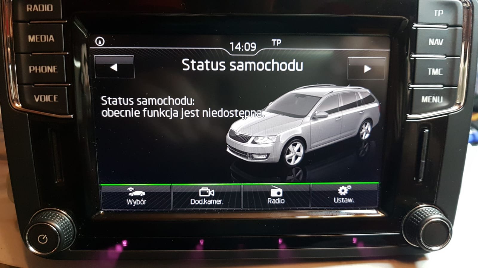

Some updates:
1. VW and SEAT units can now be reworked into SKODA - startuo logo, HMI skins. Advantage: they are more of them available on the market and they have built in CD drive :)
2. Yeti picture in OPS and VEHICLE menu can be replaced with set of pictures available in MQB units, e.g. Fabia III, Octavia III, Superb III. See examples below.
Edited by pab567

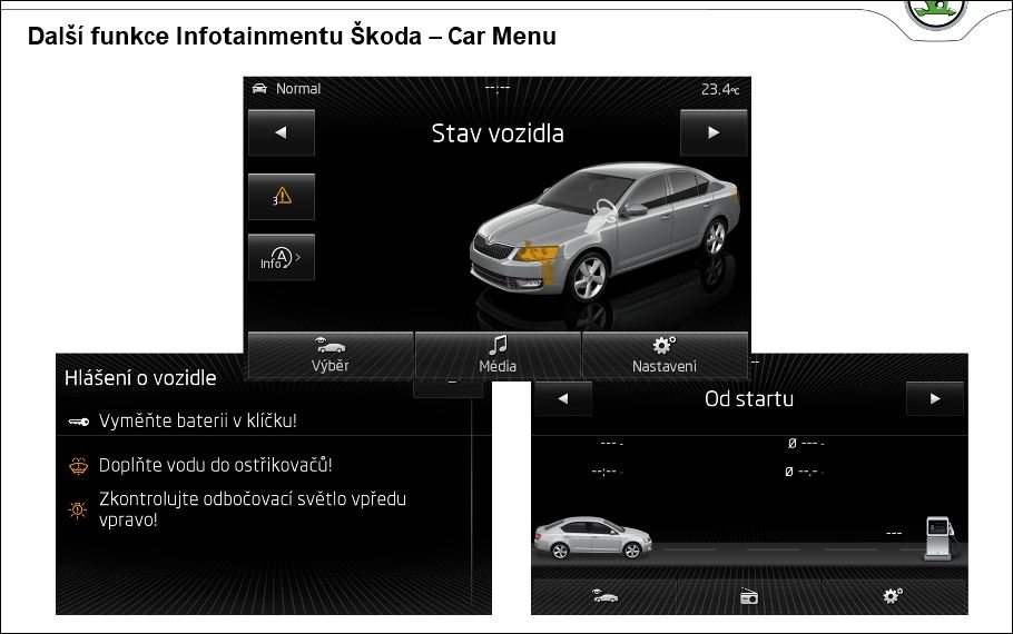

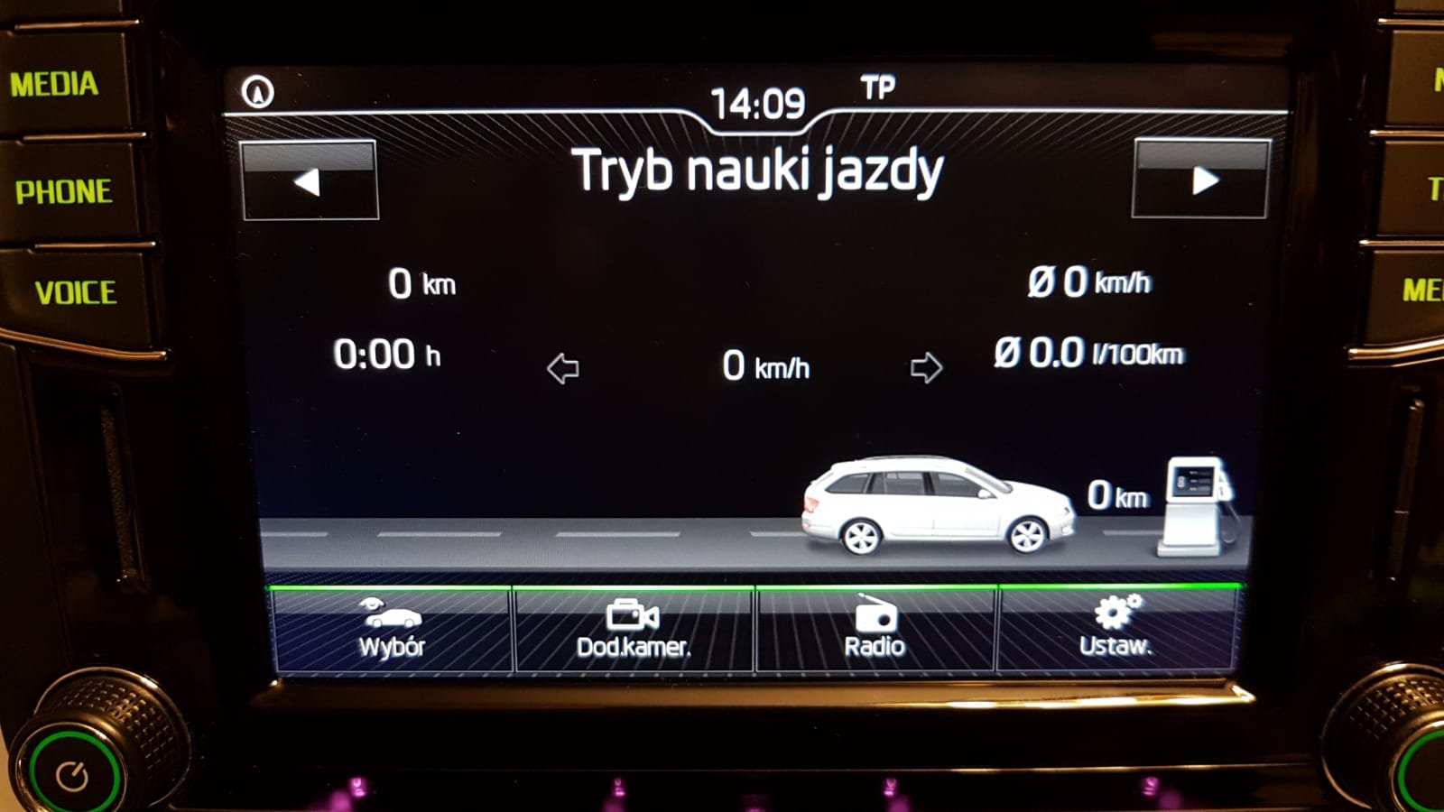

Reg. 2)  any limitation to version of stsndard Skoda units?
What does "Dod.Kamer." (Add.Csmer.) button does? Does it work only in School Care mode?
Is this mode available to any unit?
How to turn it on?
Does car menu with travel details actual, long distance, from fueling is available now to any unit?
CAR Menu on Superb II work?
How to turn it on?
No limitation, I can make it in any MIB STD2 PQ unit.
"Dod. Kamer." disappears when unit is installed in the car.
This mode is available natively on MY17 Amundsen units (SW 03xx). Can also be turned on in Amundsen MY16 units (SW 02xx) via flashing front panel in unit with SW03xx and then re-installing updated front panel in MY16 unit. I have not tried it in Amundsen MY15 units (SW 01xx).
Your turn it on by simultaneously pressing MENU NAV VOICE.
Car menu with travel details actual and long distance is available to units I listed above. ,"From fueling" is not supported (it does not show any measures).
Car menu works only with limited information, not in full scope as in MQB cars.
I can push cars other then Yeti into every unit but I need the unit physically on my desk in Poland.
last but not least - if anyone is interested in such rework or in new unit pls contact me on PM.
