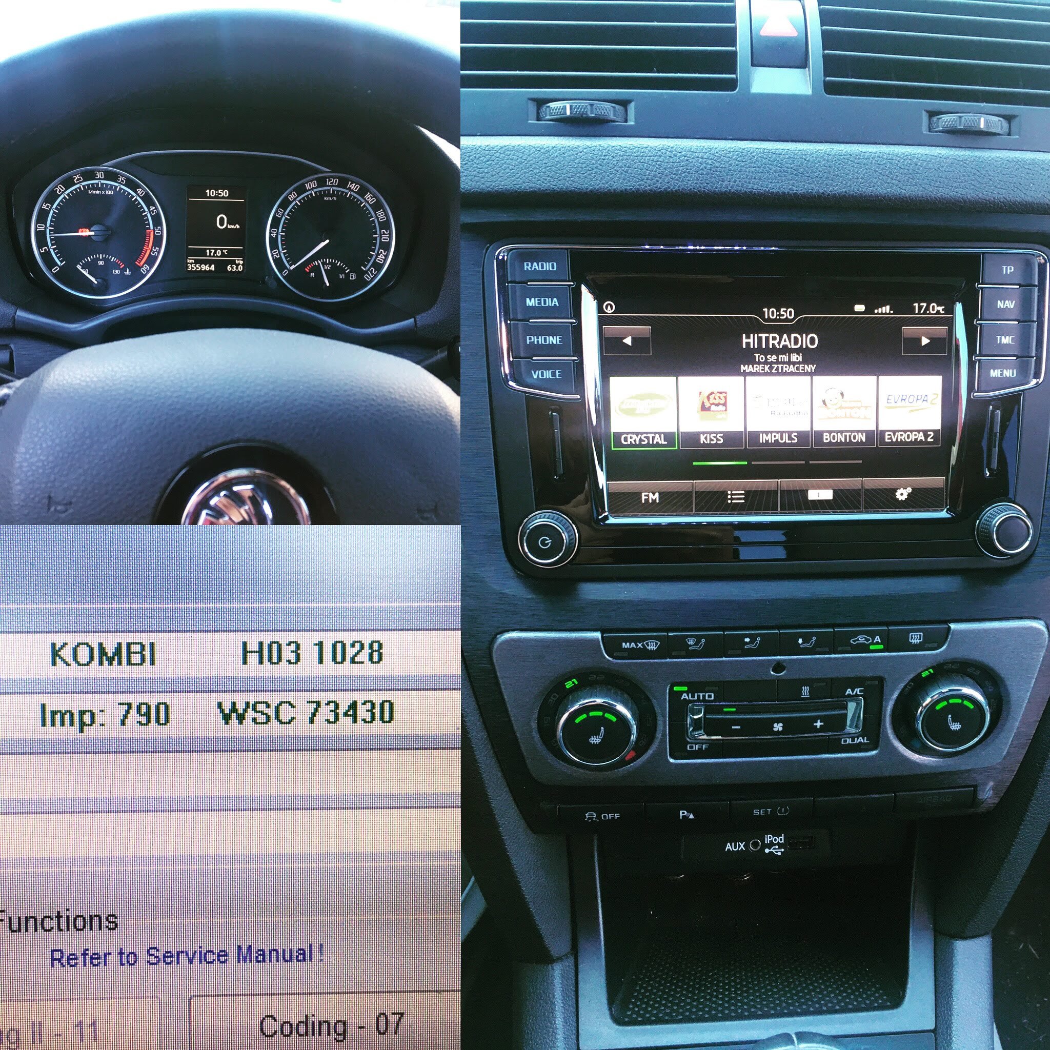

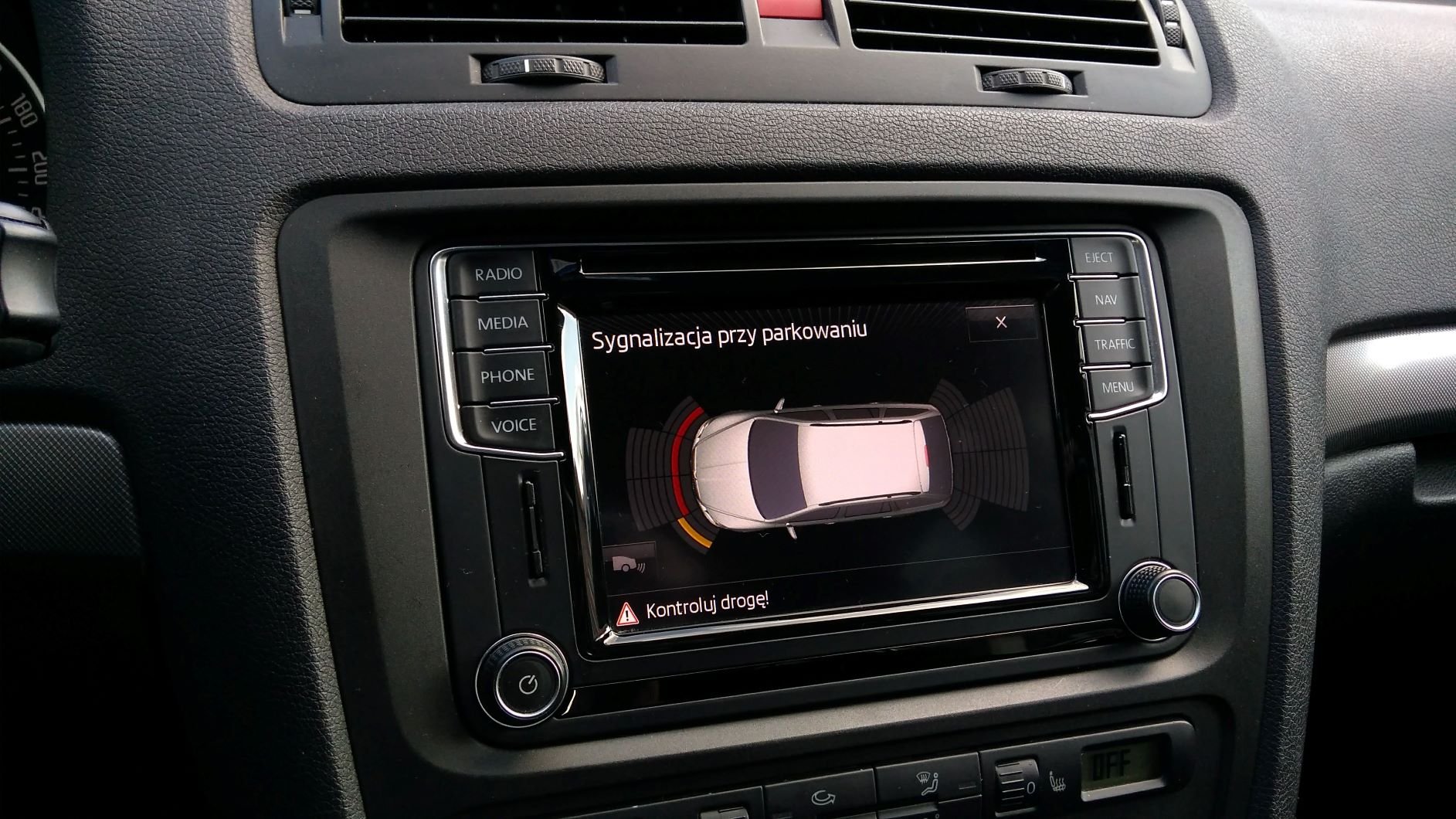

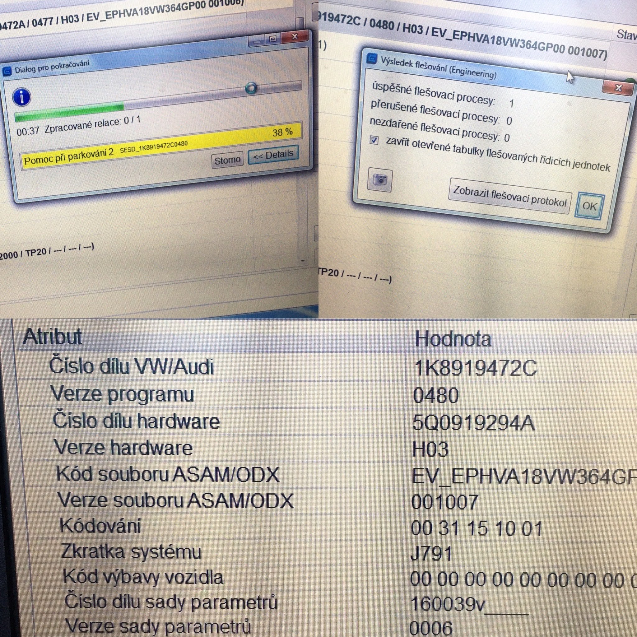

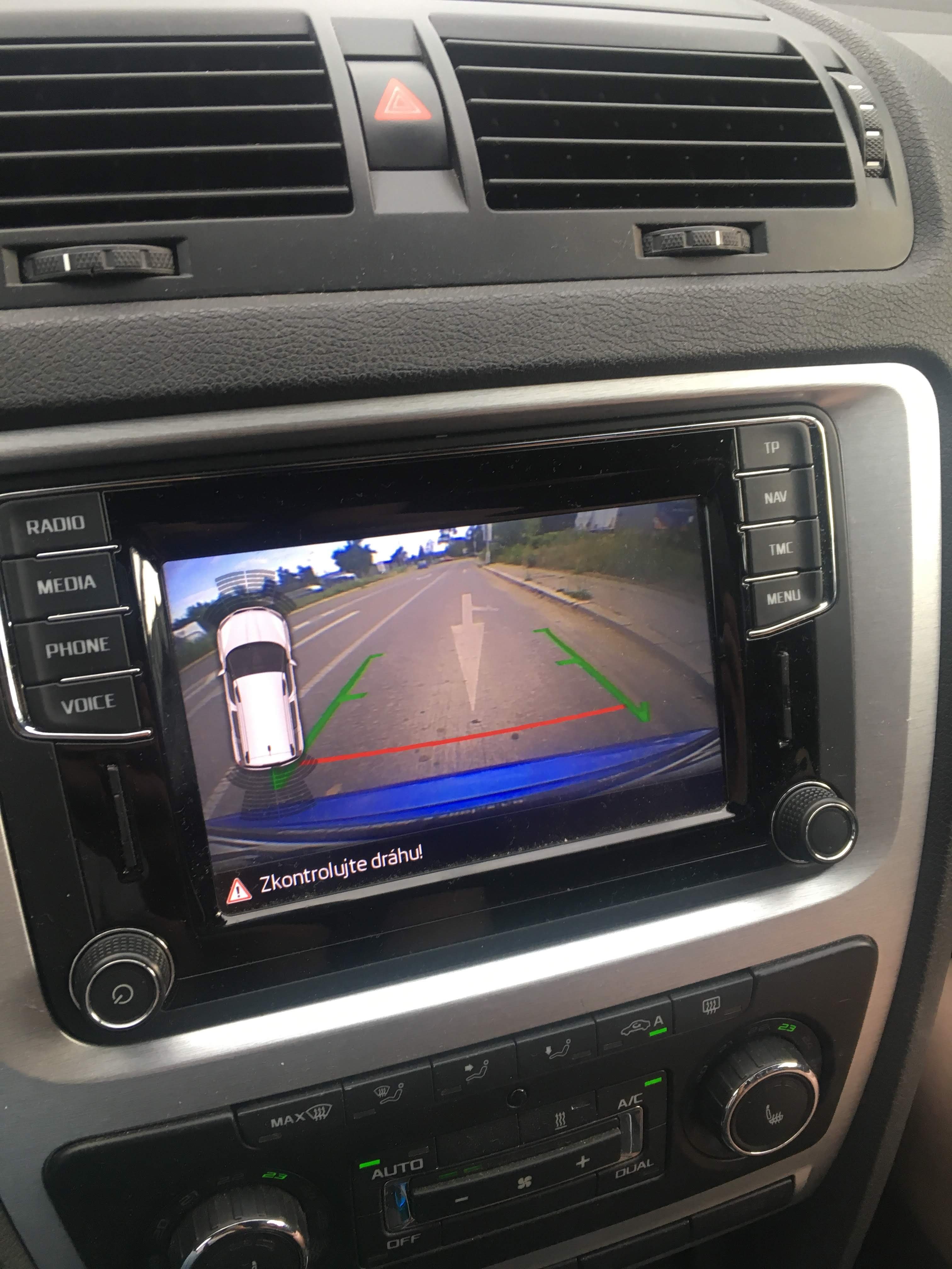

My car Škoda Octavia II 2007 swap to 2012 ☺️
  • Gateway 7N0 907 530 BL
  • BCM 1K0 937 087 D
  • Dash 1Z0 920 843 T flash to fw 1028
  • SoundSystem 5C6 035 456
  • PDC 1K8 919 472 flash to 1K8 919 472 C
A1356668-76BB-4151-93BD-AE002A685A40.thumb.jpg.212f68f11368289bbf24ca2634fe3fbd.jpg 7B53E5CD-BCA1-4C20-A934-727474A8C4A3.thumb.jpg.07a1226f02edc4a4647274c132b1bc4f.jpg

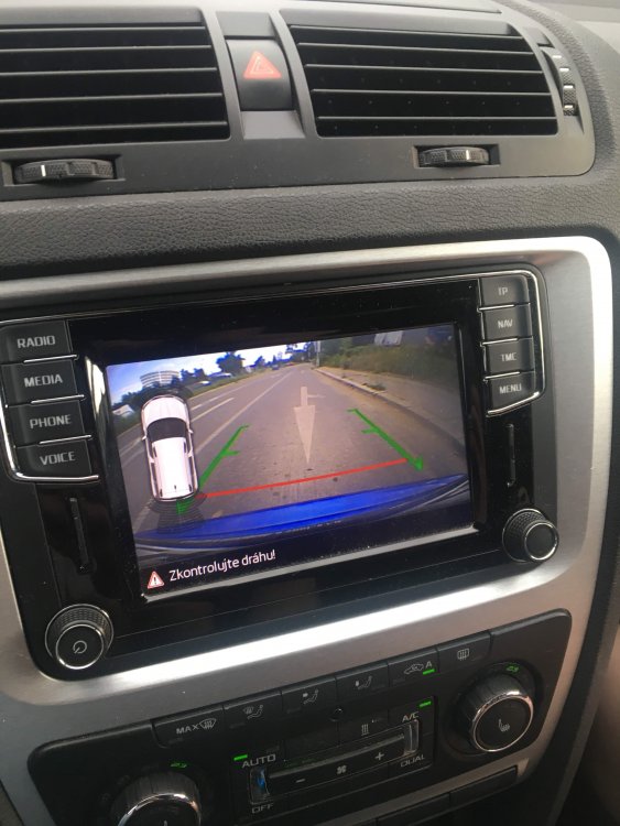

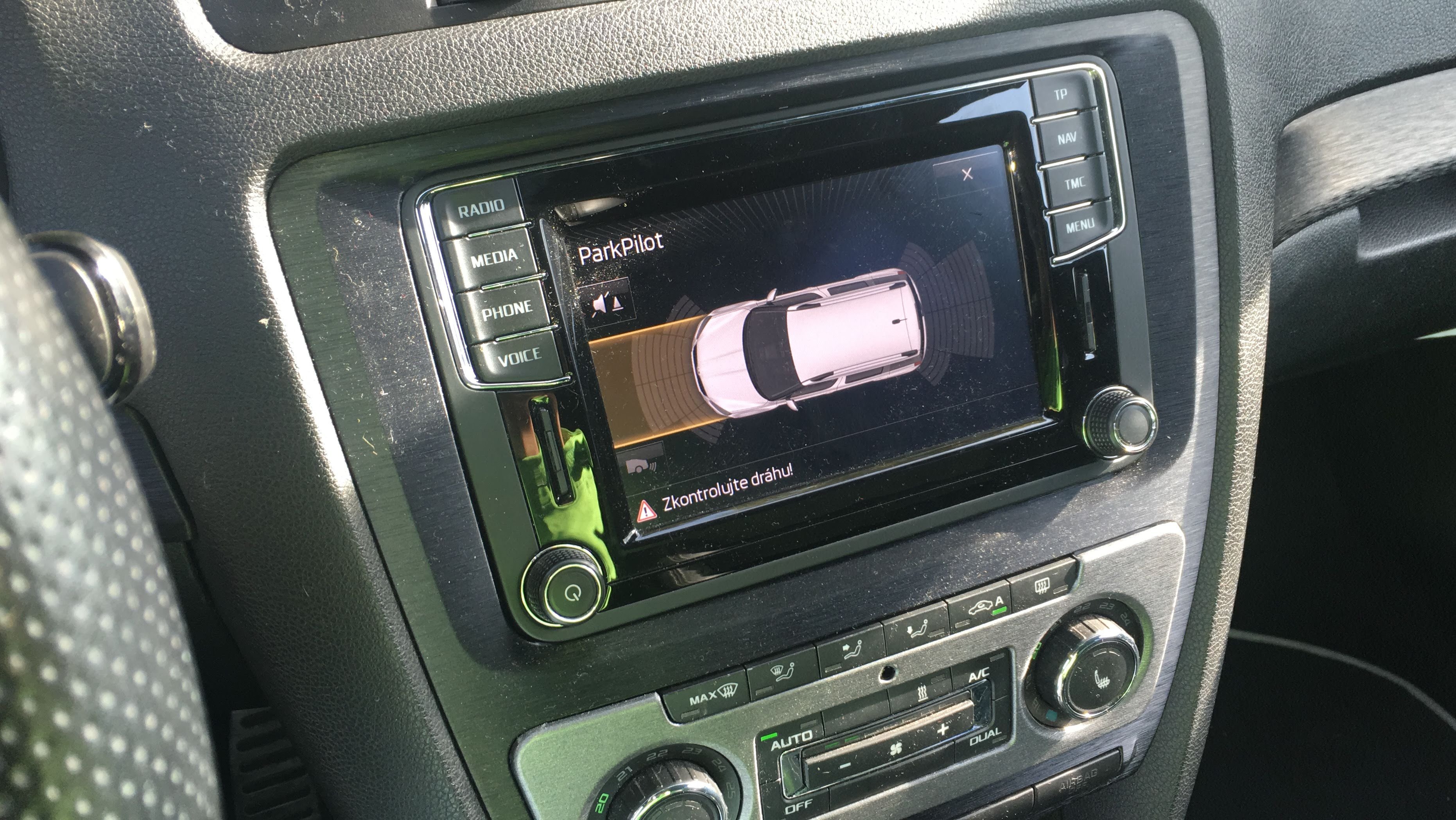

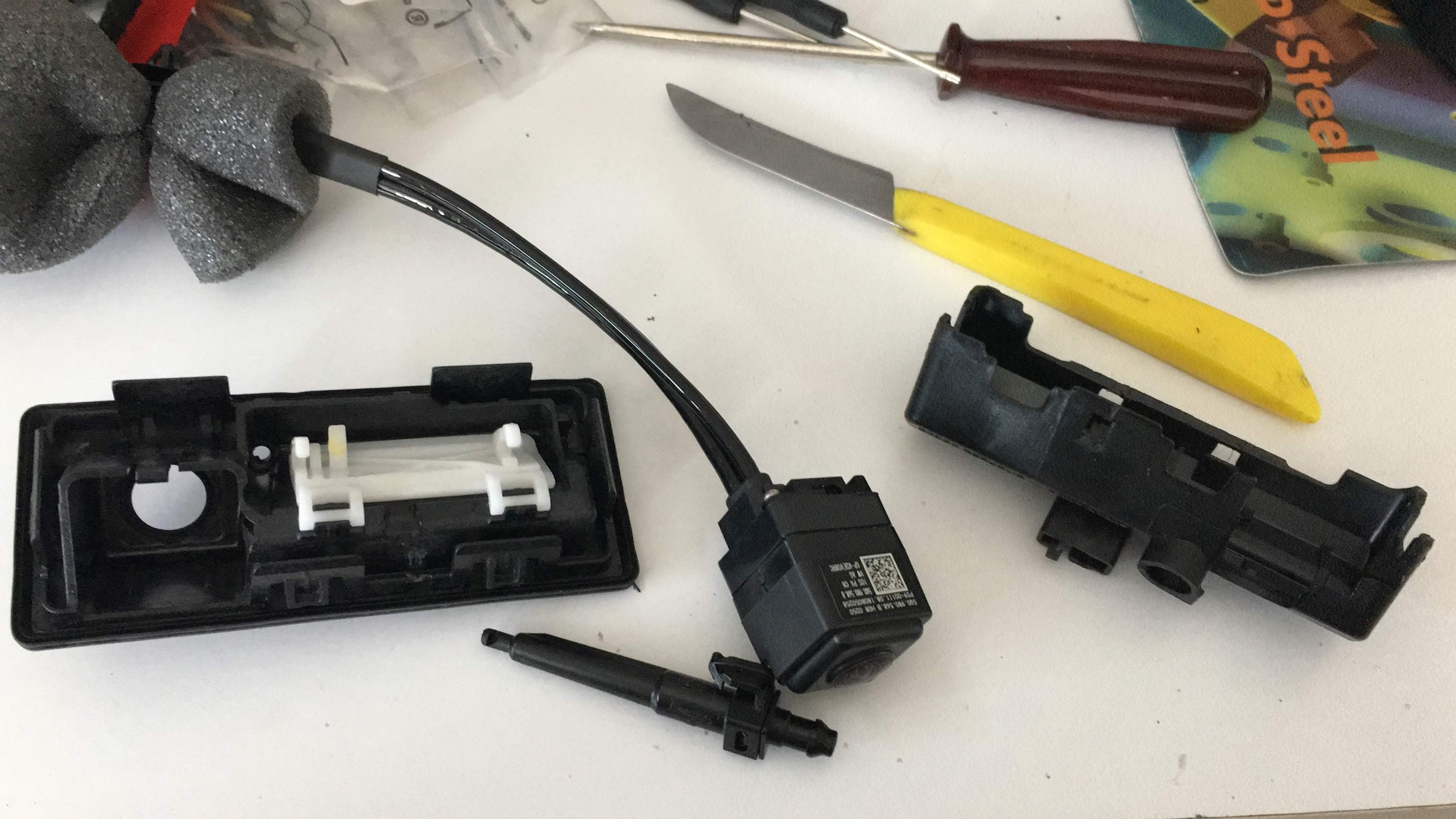

  • RVC from O3 with sprayer to clean the camera lens
camphoto_1804928587.thumb.jpg.a50ab7343c5d5766620c782b164cd579.jpg E74EA949-4757-42C1-BBE6-C4C61EED96C2.thumb.jpg.4d0c6343c91dc84e02f9ae93b10b9af1.jpg

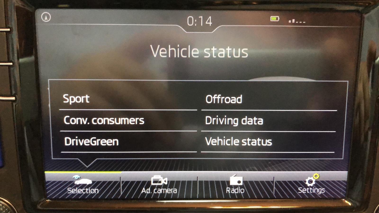

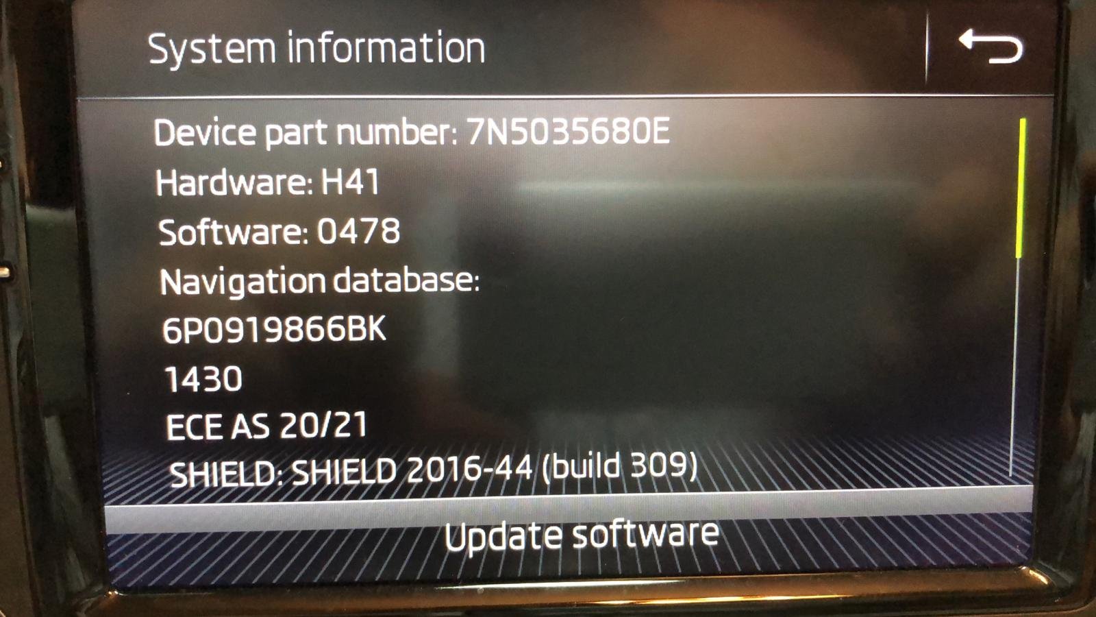

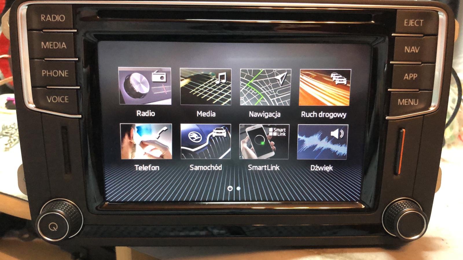

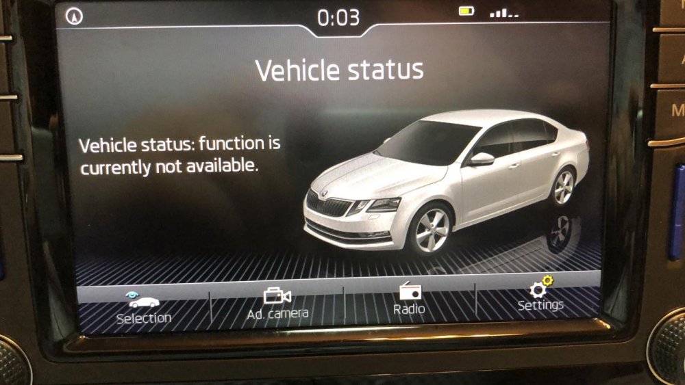

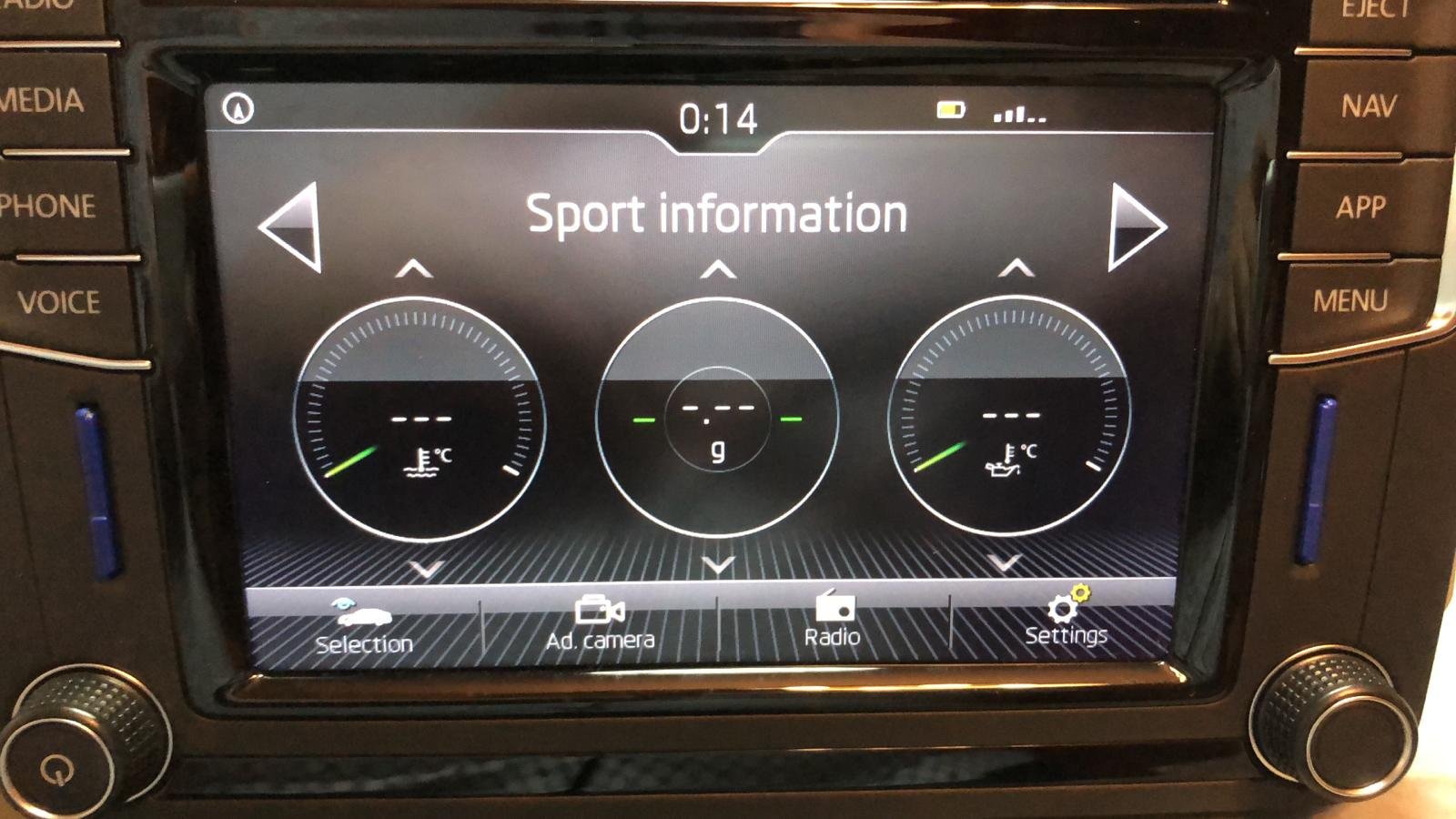

Some more pictures of the latest development. As you know SKODA has never launched MIB STD2 PQ with software 04xx so I decided to do it by myself:
- unit SEAT MIB STD2 PQ model number 7N5035680E
- reflashed with VW software MST2_EU_VW_PQ_P0478T
- Components Protection disabled
- all the features activated
- flashed with HMI (Human Machine Interface) from SKODA software MST2_EU_SK_ZR_P0478T from MQB platform
- button backlight LEDs changed to green
Thank you everything is fine

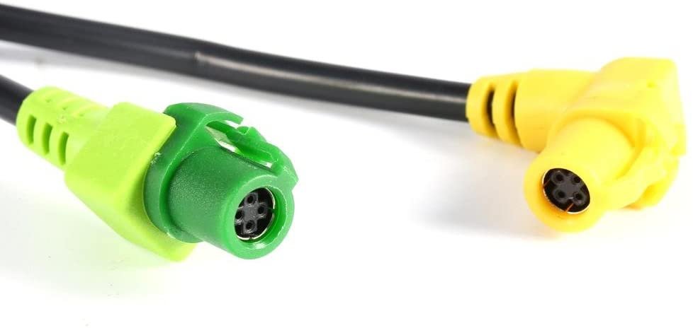

Following this topic, il already bought a Bolero (5L0035200 B ) and an USB port (5Q0035726 E).
Now the harness is missing.
Is a harness with this type of connectors will work with my unit ?
