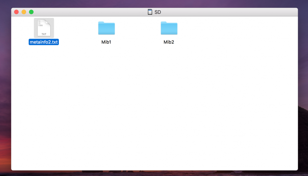

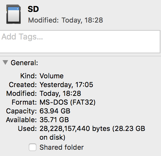

I have re-done it from start on my Mac in macOS.
Done exactly as you have said, card is still formatted as FAT32. Copied over the files, used Clean My Drive and removed the junk, ejected the card and I have locked the card so no more files are modified on it. Will give this a go.
Done exactly as you have said, card is still formatted as FAT32. Copied over the files, used Clean My Drive and removed the junk, ejected the card and I have locked the card so no more files are modified on it. Will give this a go. imageproxy.php?img=&key=66c1d7df650950da
Good luck... it looks good. Was the any hidden files???
Yes - working now! Has only took me around 6 months on and off.
I think locking the SD card after deleting the hidden files resolved the issue, as everytime it was plugged back into the Mac, Spotlight re-indexed the card and created a hidden folder.
Hidden files was defiantly the issue!
So glad its worked for you.

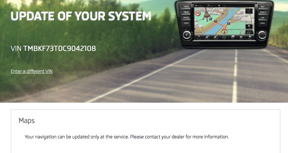

Skoda website states Columbus update on Superb Elegance Columbus sat nav  "can only be updated at service".  The cost was quoted as £203 + VAT, has anybody found a 'work around'?59df8ed166e88_ScreenShot2017-10-12at16_47_03.thumb.png.7e6320ffd2cccc32dd30227a70283383.png

Just phoned Skoda dealer as mine is 4yr old cannot update from internet dealer only £140
Anyone know a way around it as when I enter my VIN says dealer to update???
Without knowing what car you have, what year it was built, what model it is, what system you have fitted etc. it's kinda hard to help.
Sorry  it's a 14 plate superb with Columbus syystem
Then the dealer is correct. The free online update is for the later model (MIB) Columbus. Yours needs a dvd update disc which doubtless can be found for free or cheaply online. This thread is for the Mk3 Octavia, and the Mk3 Superb will now be included in this detail, but the Mk2 is a different issue I'm afraid.
Cheers Rustynuts
