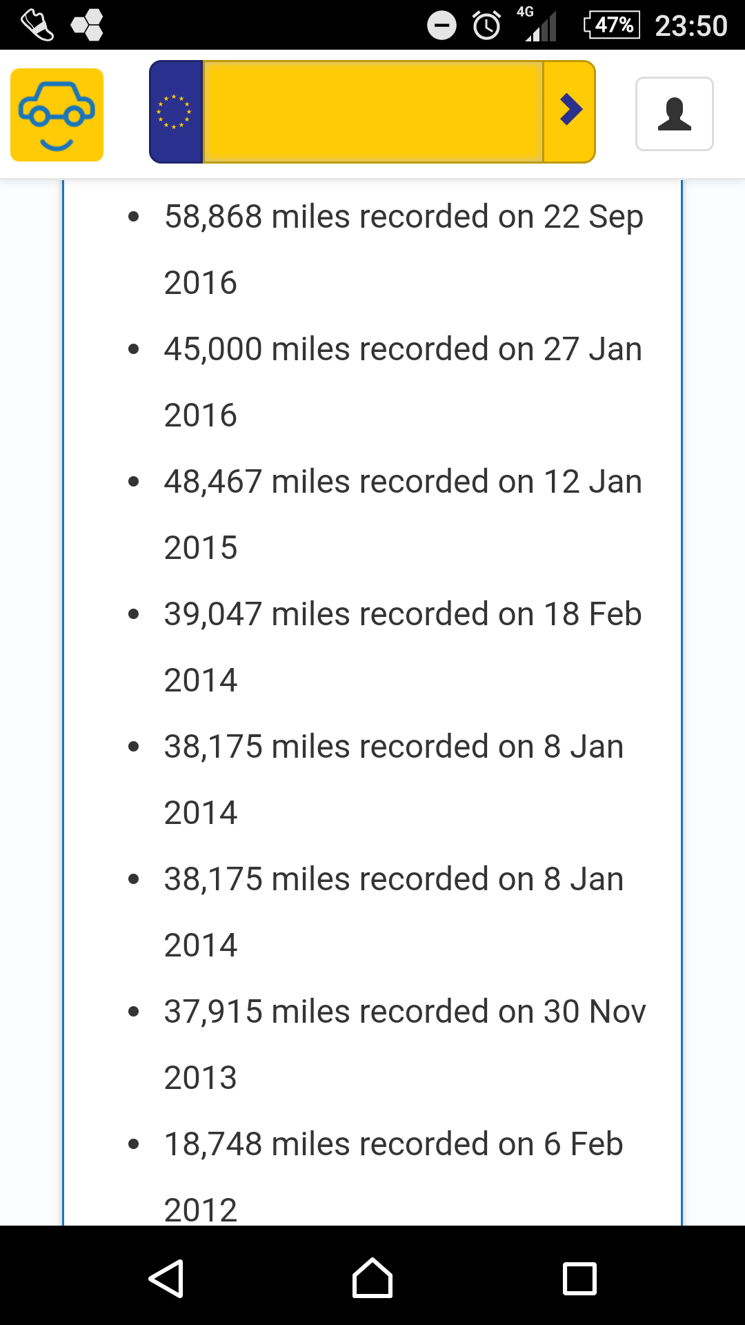

just done a vehicle check on it and the mileage concerns me, see photo. it does state at the bottom mileages are supplied by 3rd parties and cannot be validated.
also noticed it was mot'd 2015-16 which expired 20jan 16 then it wasn't mot'd again until Sep 2016.
what do you guys recon is this one to stay clear from? everything else came back on the check clear.

Well i know it's after 1a.m right now but it looks like the mileage goes backwards. 12th Jan 2015 mileage recorded as 48,467 then on the 27th Jan 2016 mileage recorded as 45,000. Unless I've read it wrong. You can check on dvla site for mot's/mileage.

The mileage reports look kind of ok, but there should be a report at least every 12 months from MOTs?  The second last one goes backwards but at a clean 45,000 sounds a bit like someone has guessed it and input. But at the same time it only shows 10k miles between 12 Jan 15 and 22 Sep 16 (only about 500 miles a month and half of the previous usage).  Worth a question, to the seller, did ownership change, change of job etc, on a forecourt?
Some vehicle checks show the source of the mileage record, that could help point to the issue with the 45k reading. You could run another one from a different provider. Ask the seller for MOT records etc....

yes it has the jack in the box. yeah I thought it could be an input error or they have just told an insurance company its got 45k and that's been added to a database.
details are as follows:
new keeper change 29 Apr 2014 (so I guess that could explain the sudden drop in mileage originally registered to a company so I guess it was a reps lease car for 3 years)
Engine Vrs Tdi Cr
it only has 3 MOT's
14 - 38,175
15 - 48,467
16 - 58,868
the interior seems to match with the age and mileage, slight bit of wear on top of the gearstick plastic like a haze or slight scratching (maybe caused by a ring?) no wear on the drivers seat
having the mileage checked on the ECU via VCDS - which somebody correct me if im wrong should display the correct mileage
I'd be less worried about the 45k mile outlier, but as you've pointed, not having a valid MOT for 8 months seems a bit of a question mark?. Another mistake, maybe,  also corresponds to the period over which the 45,000 mile reading was taken. Overall mileage probably ok if it all fits with wear but what is the non use about if not a mistake...Even a dealer would keep MOTd.

How long do you intend to keep the car? I think you should also consider whether the mileage discrepancy and not having the book will cause you trouble selling it or end with you having to give the next owner money off.
I would grab a photo of the option sticker under the boot carpet and make sure it belongs to a vehicle of the spec you think it is. A dealer or someone on here should be able to help you decode the 3 letter codes on the sticker. It's easy enough to buy new badges to make a car look better than it is but changing that sticker is a much bigger job.
Have you called a Skoda main dealer? There should be a record on their system of every time a dealer has seen any car. That may help ironing out the mileage issues and seeing whether it has been serviced correctly.
I really don't like the look of that 8 month MoT gap. It could mean that the previous owner didn't look after it or that it did sit on a forecourt for a long time and for some reason the garage couldn't get anyone to buy it. It may also be something innocent like the owner being sick for an extended period and unable to drive. Whichever it is, they would have to have declared SORN on it or got fined as I'm sure the mandatory tax or SORN rule was in place then.

ill check under the carpet :thumbup: yes called main dealer they confirmed service NOV 2013 at 37,915 which matches with the history and invoices for other services and maintenance done.

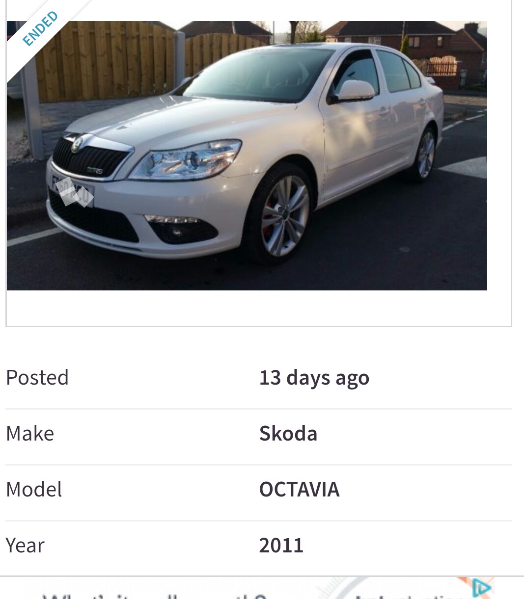

This is the car..  T minus 10 hours to viewing / buying
I'm not sure that car's being sold by a dealer. The only place I can find any mention of the supposed dealer is a mobile number and a facebook page. His location is a residential road in Rotherham. Most likely he's just a bloke who sells a few cars and likes to think he's more important than he actually is, and there'll be a distinct lack of response once you buy a car and find out there's a problem with it.
Given the situation with dubious service history, dodgy mileage, and a dealer who hardly exists, I'd be walking away from this one.
It's been mentioned previously but that mileage discrepancy will always be there. It will almost certainly affect future resale values. Any hpi check on the car will flag it up. I had this issue last year when I'd sold my Leon and was searching for an Octavia. Found a well specced pre f/l on Autotrader. Rang the dealer arranged a viewing but as it was a long way to travel i checked the car before setting off so the purchase could happen straight away. The hpi check came back ok but with a mileage discrepancy just like this one. The dealer was lovely tbh he went through service book and mots etc all seemed to check but as it was a round figure on the mileage it probably was a seller filling out the log book and just guessing the mileage. He was looking into having it corrected through dvla but tbh i don't think it's an easy process. Like mentioned, it will be your problem when you come to sell it on.
So, Checked it over again I appear to have missed alot first time round, drivers door window wasn't working properly, speakers drivers side were not working, front and back.. drivers bolster looks like it had been split and repaired also waytootall came out and ran vcds on it see file below. Safe to say I walked away
Can't access that download.
All that damage / stuff not working is on the same side, so my guess is it's been in a side impact and badly repaired outside the insurance.
