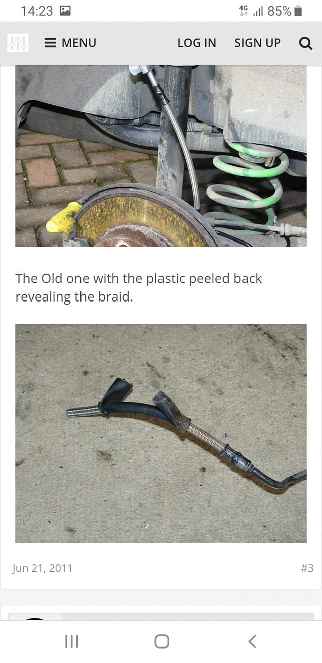

my Lucas rears (Smaller ones) were  rubber tubing type i think.  These were cut off a scrapper  and repainted.
Uprated the ATE fronts thats where all the stopping power is.
Deffo braided

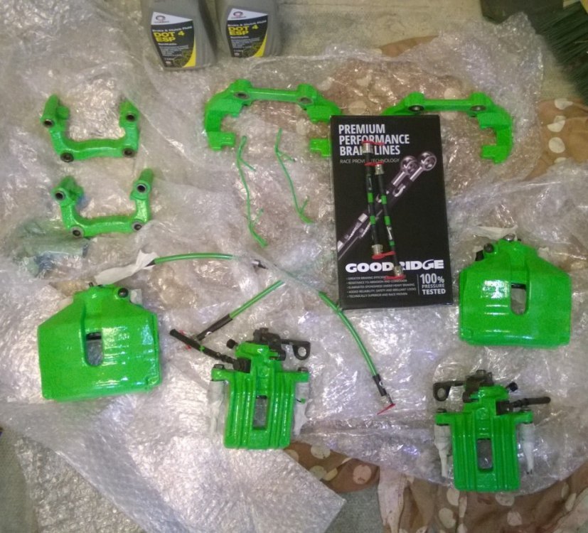

New pads fitted today as well as braided lines and a complete brake fluid change and a stud conversion
