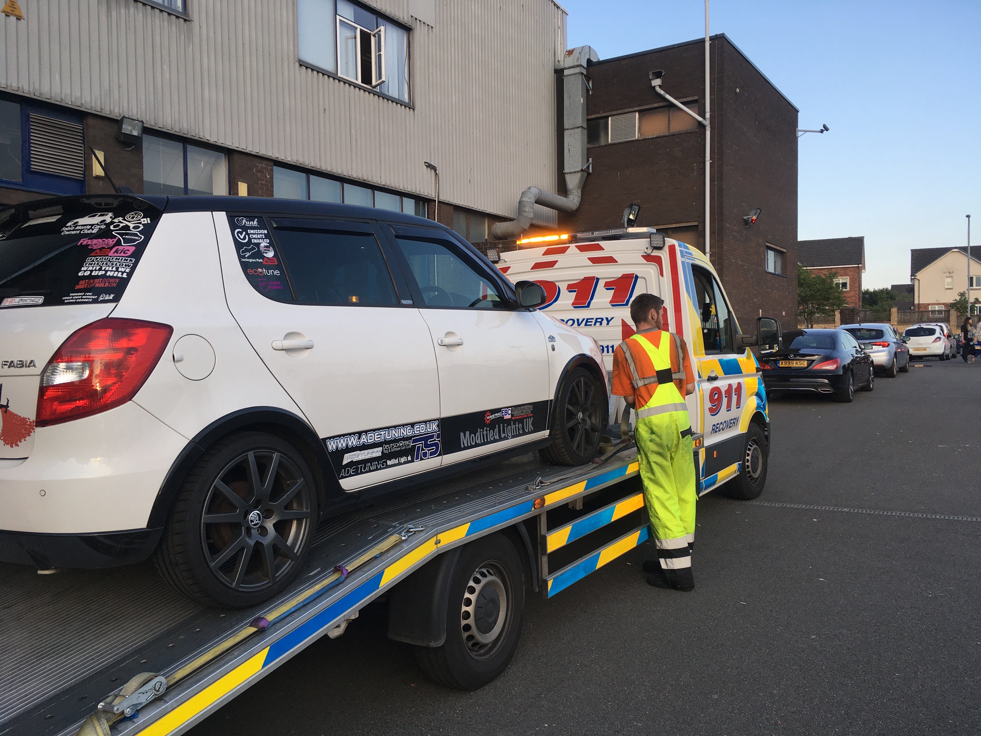

Well from the picture above you can see the Fabia had to get recovered. For a week or so i kept having an issue with the clutch where i would reverse then try to pull it out and it wouldn't come out. Sometimes when you lift the clutch a little the gear lever will move so did that and the car stalled so biting point was on the floor compared to the usual high up.
After the first time it didnt do it again untill you were doing low speed monuvers or riding the clutch but was normal in normal driving. Spoke to a couple of friends and they said it sounded like the clutch slave cylinder and to test it stick a breaker bar on it over night and look for any leaks. Did this and the next morning a nice spot of fluid on the ground.
Now i knew what the issue was had to get it sorted over the next few days, drove to work and went to pull into a parking space and clutch was gone stuck to the floor. Skoda Assist came out and confirmed that to be the case, tried to phone around a few garages i know to see if they could take it in but they were all full so had to get it recovered to a main dealer. Almost £400 to get it sorted.
