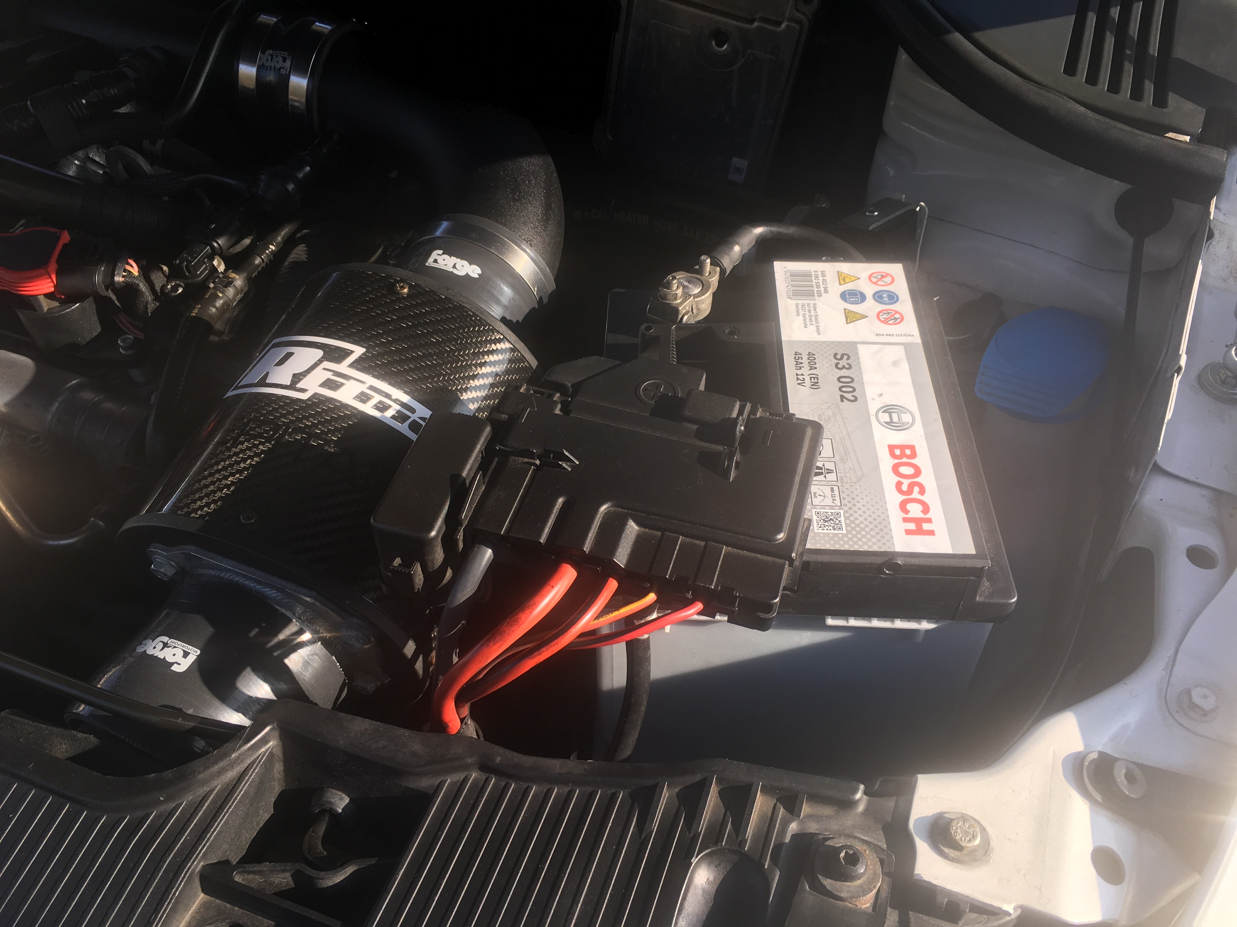

Can u stick battery in the boot spare wheel well? That allows more options on intakes and would be less weight (on left)  I think all fabias MK2 variants are heavier on left, no wonder they pull that way! tyre tread wear quicker on left side too.
Could do but then comes the issue of usability.
Ive had a couple of punctures in the past and with the miles I do I wouldn’t wanna be stuck for ages waiting on recovery.
Looking at the RTMG sideways kit which may help.

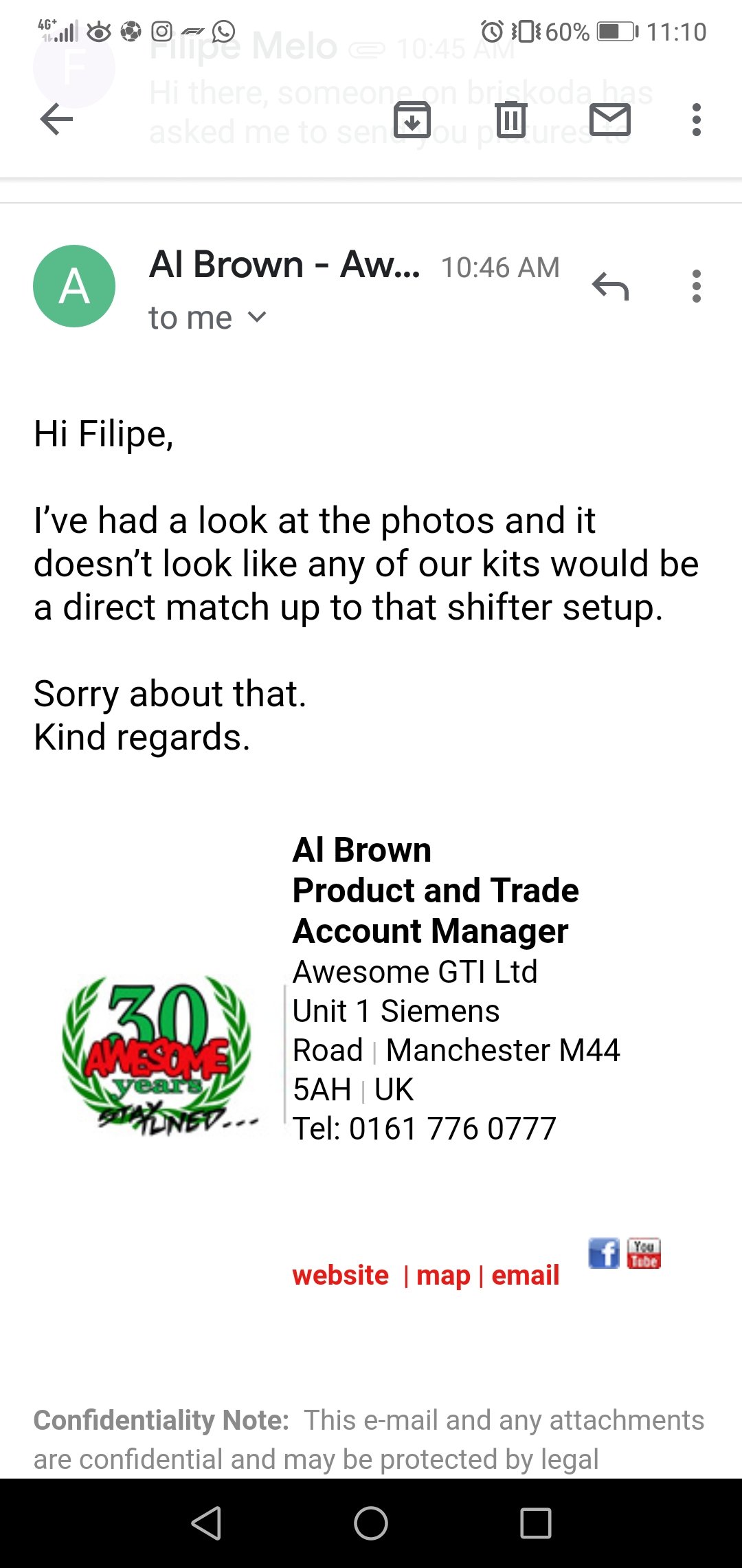

Do you know if they will work for the 1.2 tsi 5 speed?
Not sure sorry
Not sure sorry
might be worth emailing Awesome GTi as they don't list gearbox codes for the different ones they do, Your gearbox code is 02T and mine is 02R
Ive already asked they have requested photos of the shifter, but won't be to do anytime ok in the next 2 weeks, off on holiday to Ireland.
I too have a 1.2 TSI O2T box can you please take photos.

Sure, I'll do it tomorrow if I have the time
Contact is Al Brown
al@awesomegti.com
TIA
Ken
Bummer
Yeah Bummer ☹️☹️
Thanks for following it up.
Ken
