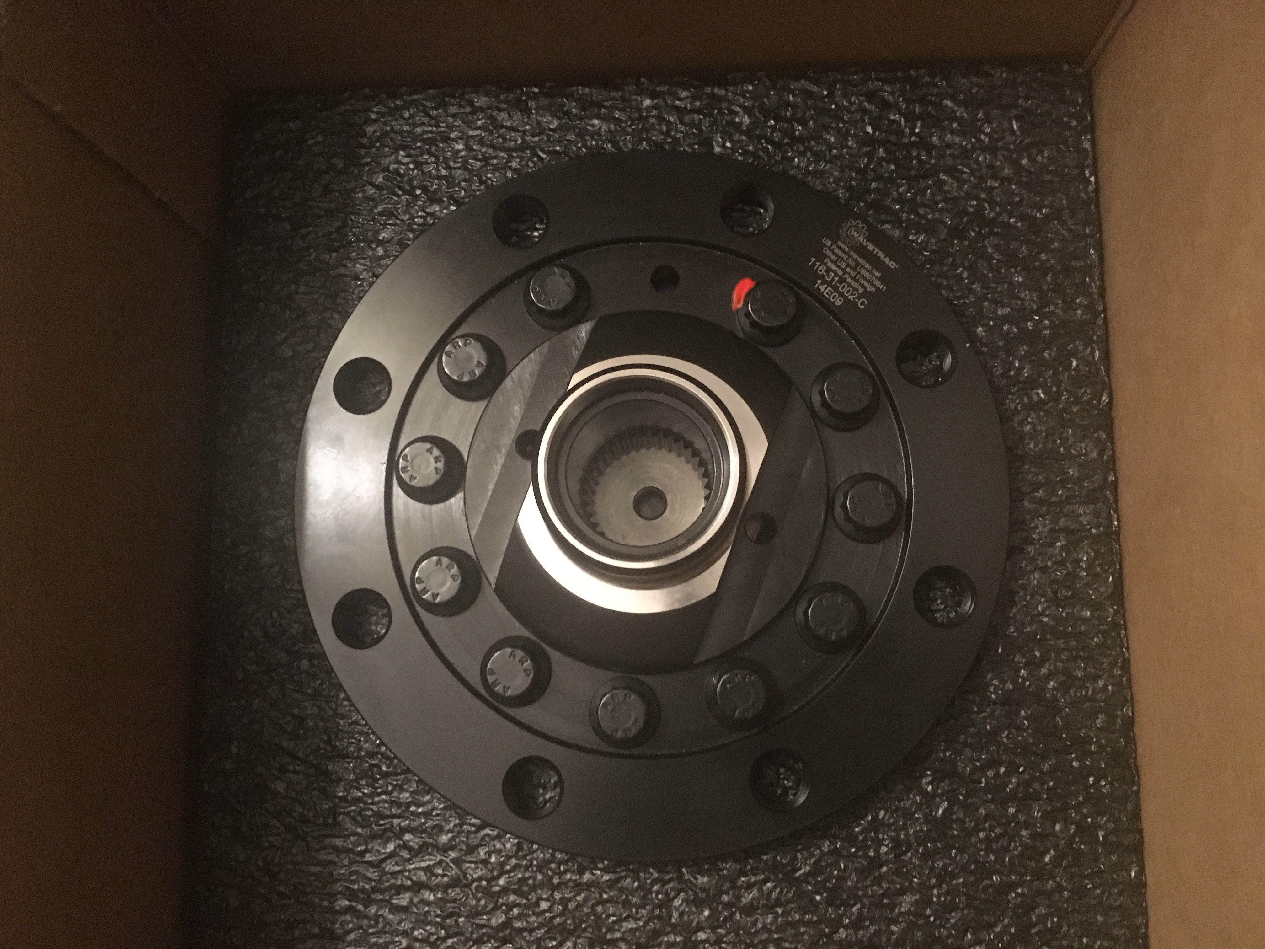

  • This is going to be a long post!   Finally got to splitting the 5 Speed box to finally see what the damage was and there was nothing left of 4th gear

Around may time hopefully. The car’s 5 years old this year so will need the cambelt and waterpump doing and a few people have suggested changing the clutch while the box is out too.
Similar to my mod in that I went for a clutch (LuK from EuroCarts with life time warranty ) replacement when fitting the LSD. As well as having the timing tensioner replaced. Except that I've not done the water pump as it's not showing any problems. Mines 8 year old in Feb, so not expecting any more large bills for at least 7 years, and for the MOT also due in Feb.
Not sure if my car would be covered under their life time warranty :D
half tempted to put in another standard clutch again since the current one seems to be coping ok but i guess we will see when the box comes off
Sachs SRE paddle clutch :D I loved mine in my MK1.
And I also loved my wavetrac. Good choice.
