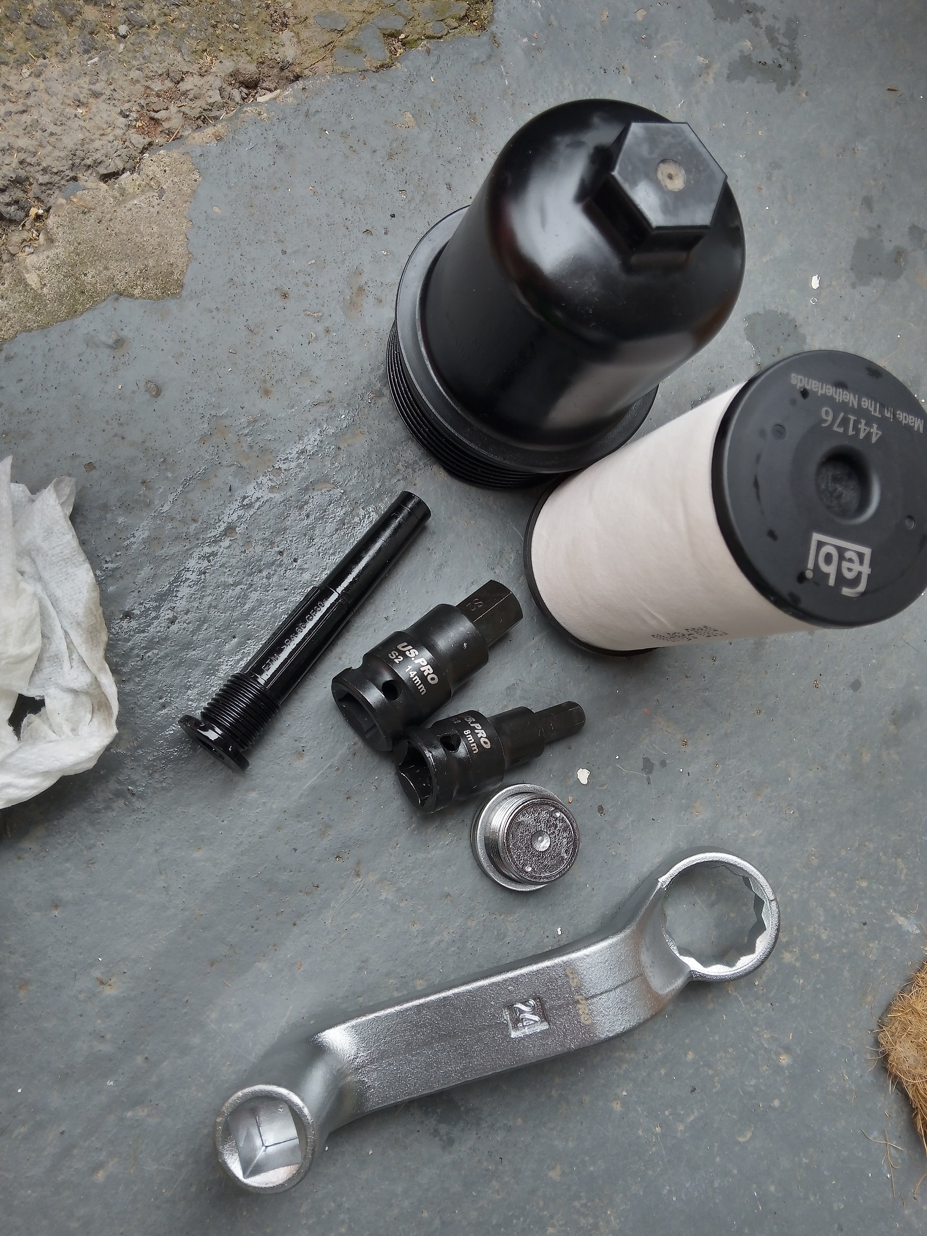

Short offset 24mm spanner works well on Octavia 3 ,100mm length.
Photo shows snorkel on left.
3nm torque to tighten snorkel.
24mm dsg filter housing is 20nm
Drain plug with fresh metal washer is 45nm torque.
