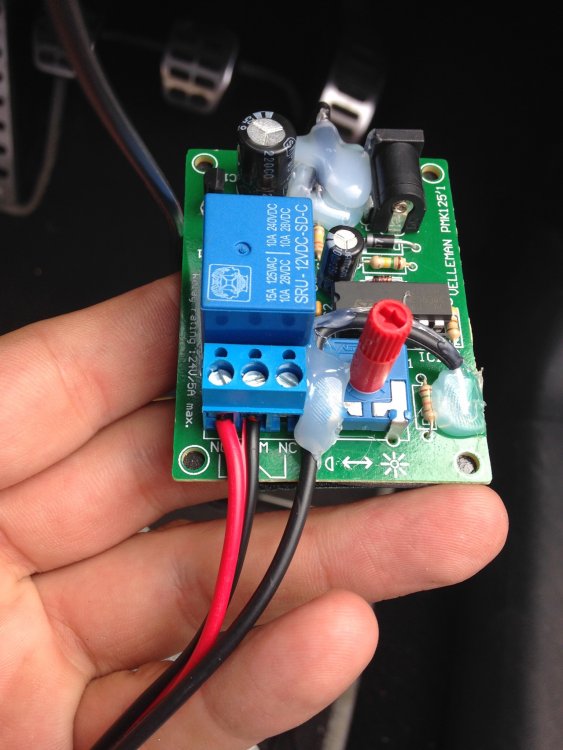

It can be done as said, but you need some bits and pieces from Maplin. I would show you, but photobucket now sucks and won’t allow me to share the picture I have.

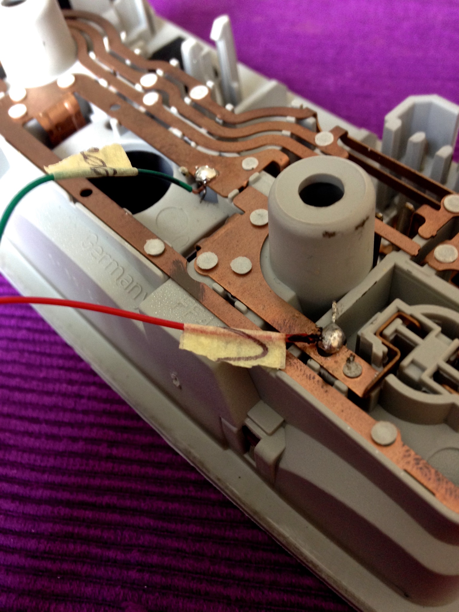

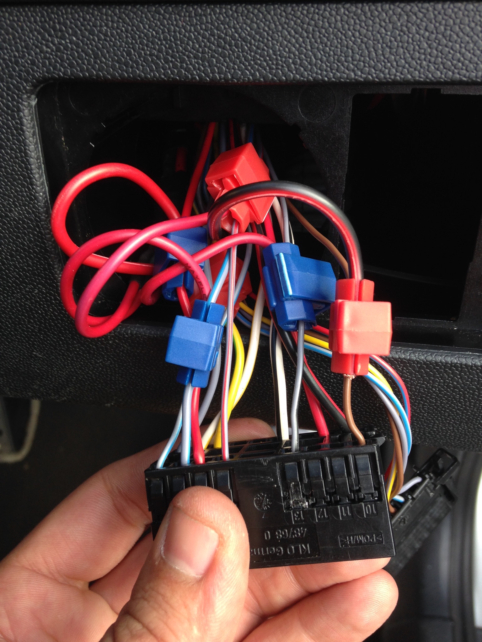

It does require a bit of faffing, including pulling the headling down, removing the interior light and soldering in the wires, pulling out the lift switch and attaching wires to the appropriate connectors and wiring to the fuse box.

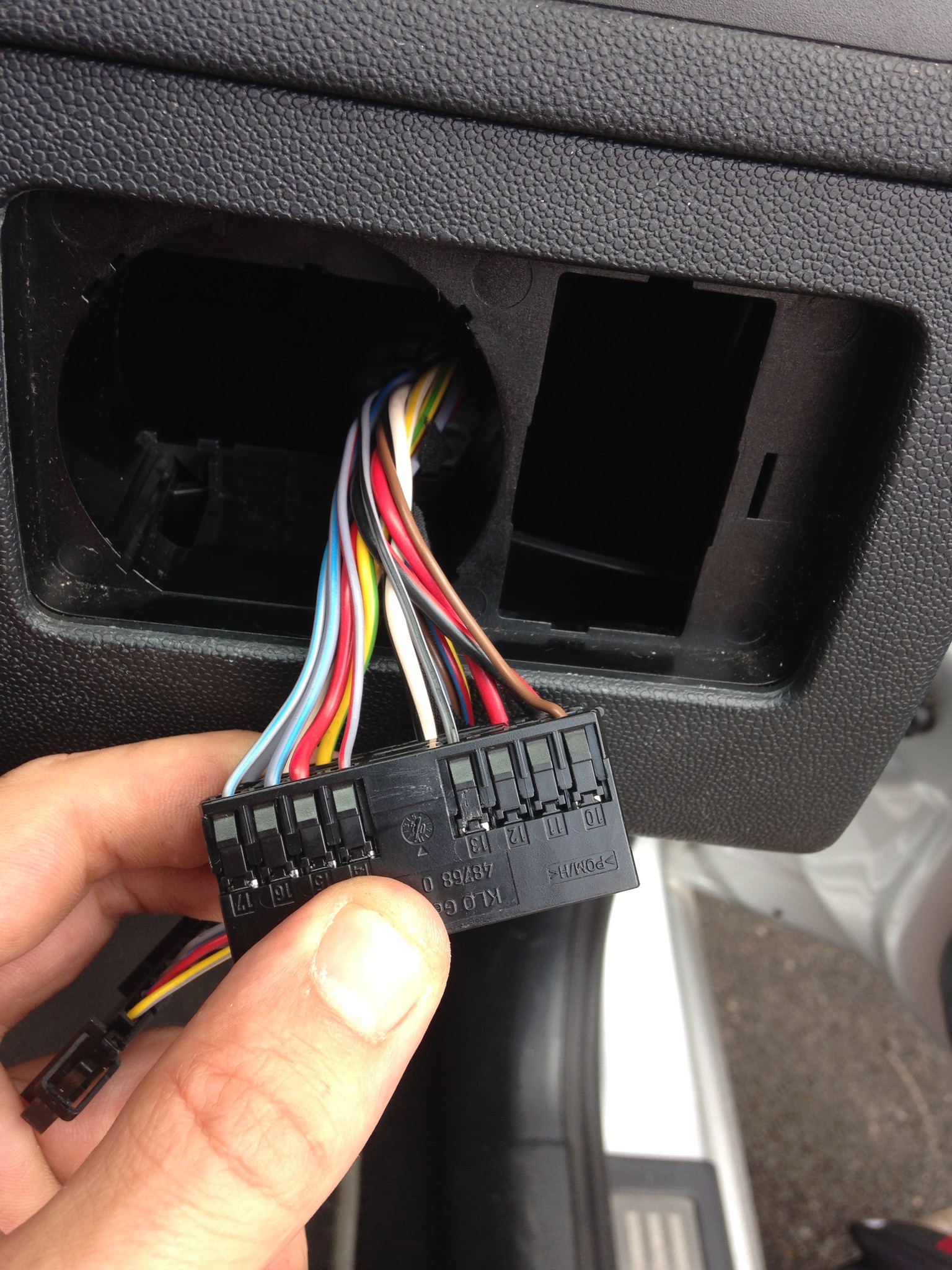

My advice would be the not use scotch lock to connect the wires behind the headlight switch. There isn’t a lot of room behind there and does make it a PITA to get it all back in.
In hindsite, I would solder the wires together and heat shrink them, although I’ve not had any issues with breaks in the connections.
