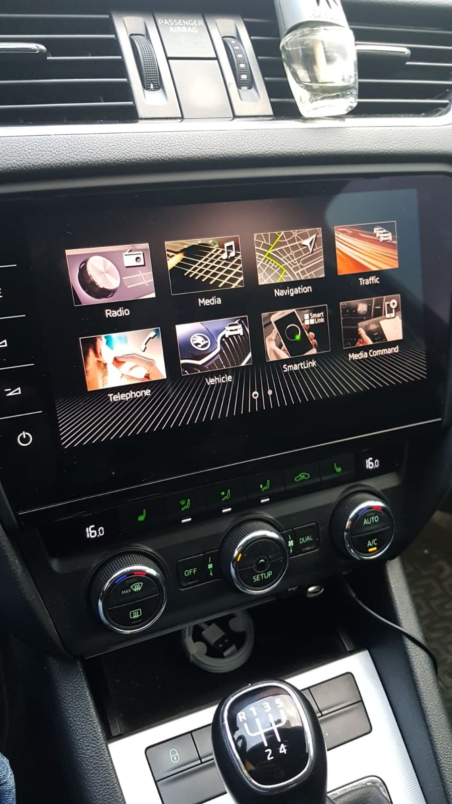

It was optioned by the original owner, never found it useful but I do now! Because it was optioned, the fitting of the Qi enabled phonebox is just plug and play. The dash needs hacking back a bit but nothing serious. Fitting a Qi pad when you don’t have the phonebox is more complex, I’m lead to believe.

  • Talking of things that are done and working, barring a few things I need to sort, the virtual cockpit is in the car!!!!!!      Here’s how it ca
  • My wheels are back!!! Please excuse the dirty car but this week I have broken my Brother’s Fabia and my Dad’s Alfa 159 so I’ve just bolted my wheels on and got moving as I’ve no time today to fit the
  • Oh yeah!!!! It’s finally sorted, a couple of adaptations and coding changes guided by the genius that is @pab567 I have finally got the map mode working and it is awesome  So it’s confirmed that you d

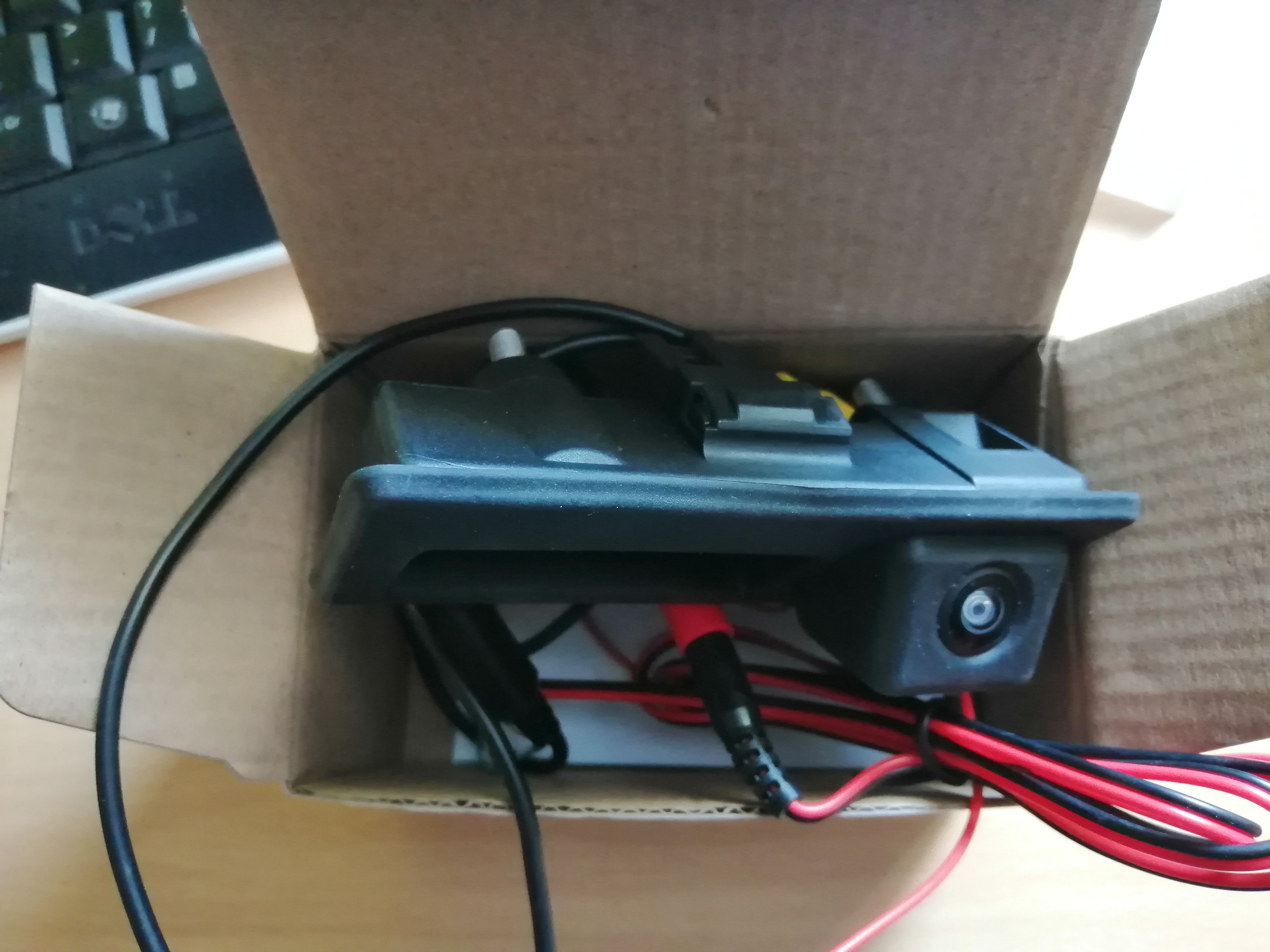

mine is a push fit with clips and doesn't bolt in.
 Anyone want this unfitted one? £15 posted? It's new and unused.
How do we know if it will fit?  Are all octavias the same fitting?
Clearly not!! :)
It's actually pretty easy to take your boot button out to check. That's what I should have done before ordering!

I've used one like that, just bent some L-brackets and used some nuts & washers to make it work. Not too difficult.
The early Octavias (mine is a 14 plate) have a smaller boot hole for the button, so cutting is required to fit the camera. There is a thread on here all about it.

@SashaGrace Assuming you need to plug in for Carplay, what happens if you plug in and use the wireless charger at the same time?
You do, but I can plug my work phone in for CarPlay (old iPhone 6S) and have my personal phone connected via Bluetooth on the charging pad. The Columbus can run a SmartLink connection and a BT connection simultaneously which now I need to have 2 phones is a boon. I’m so glad that transpired as I’d have been gutted had I stayed with the Amundsen.
Really!!!??!!  If I had known that when I got my system I would have got a Columbus.  We listen to audible on long journeys and now I have to log out of my account and into my other halfs to get to the books we are currently listening too.  She likes to have her phone to play with while we drive so I plug mine in.  If we could use mine for Android auto and have hers connected via bt it would save a lot off messing about with accounts.
I didn’t know about it until I got mine, I don’t know if it’s all Columbus’ that can do that or if it’s a MIB2.5 thing or firmware dependant.
yes it will do 2 BT connections also.
I only found out when my work phone rang on the system, very useful feature, my previous car (Fiesta) didn't have the facility.
