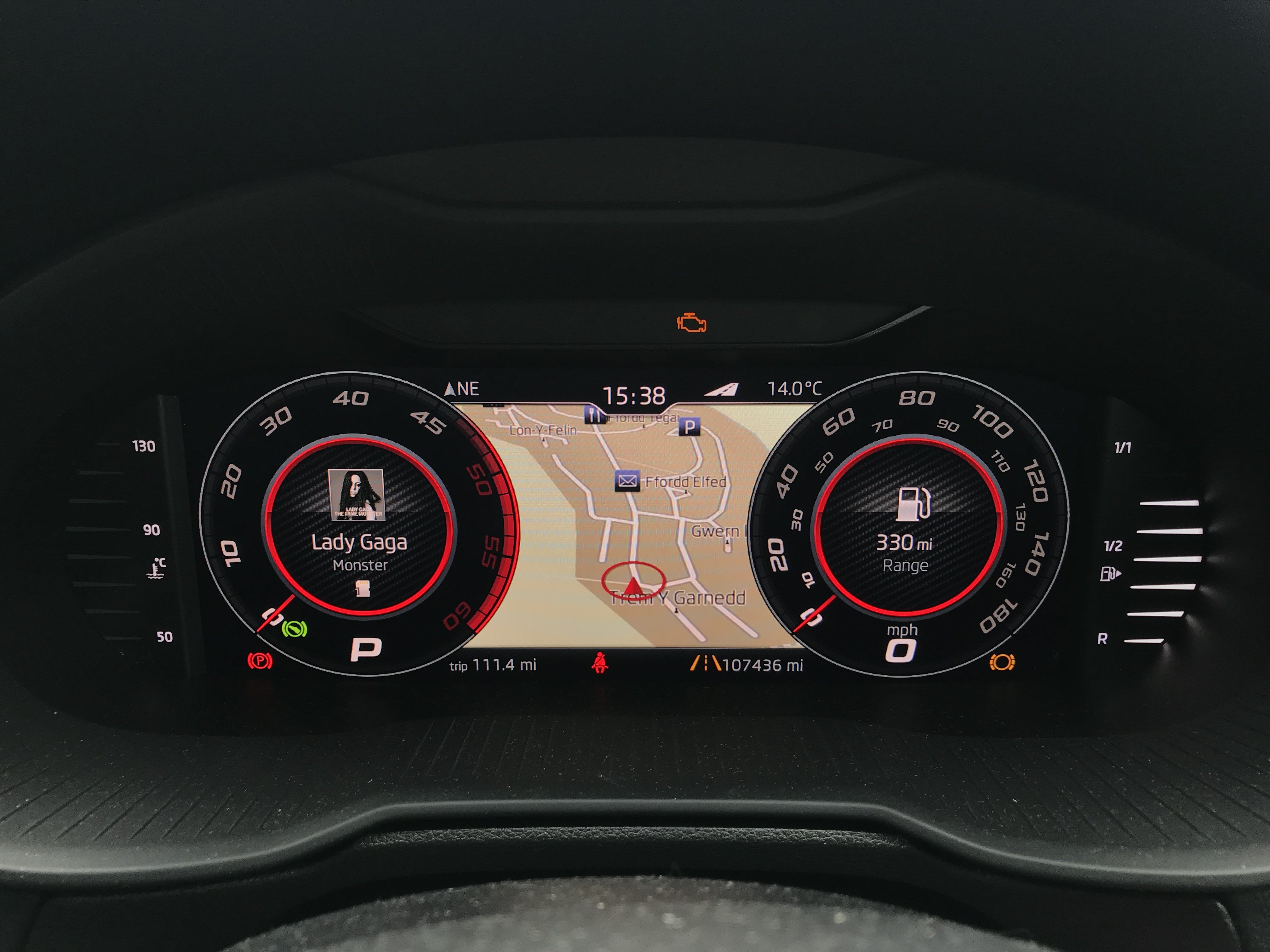

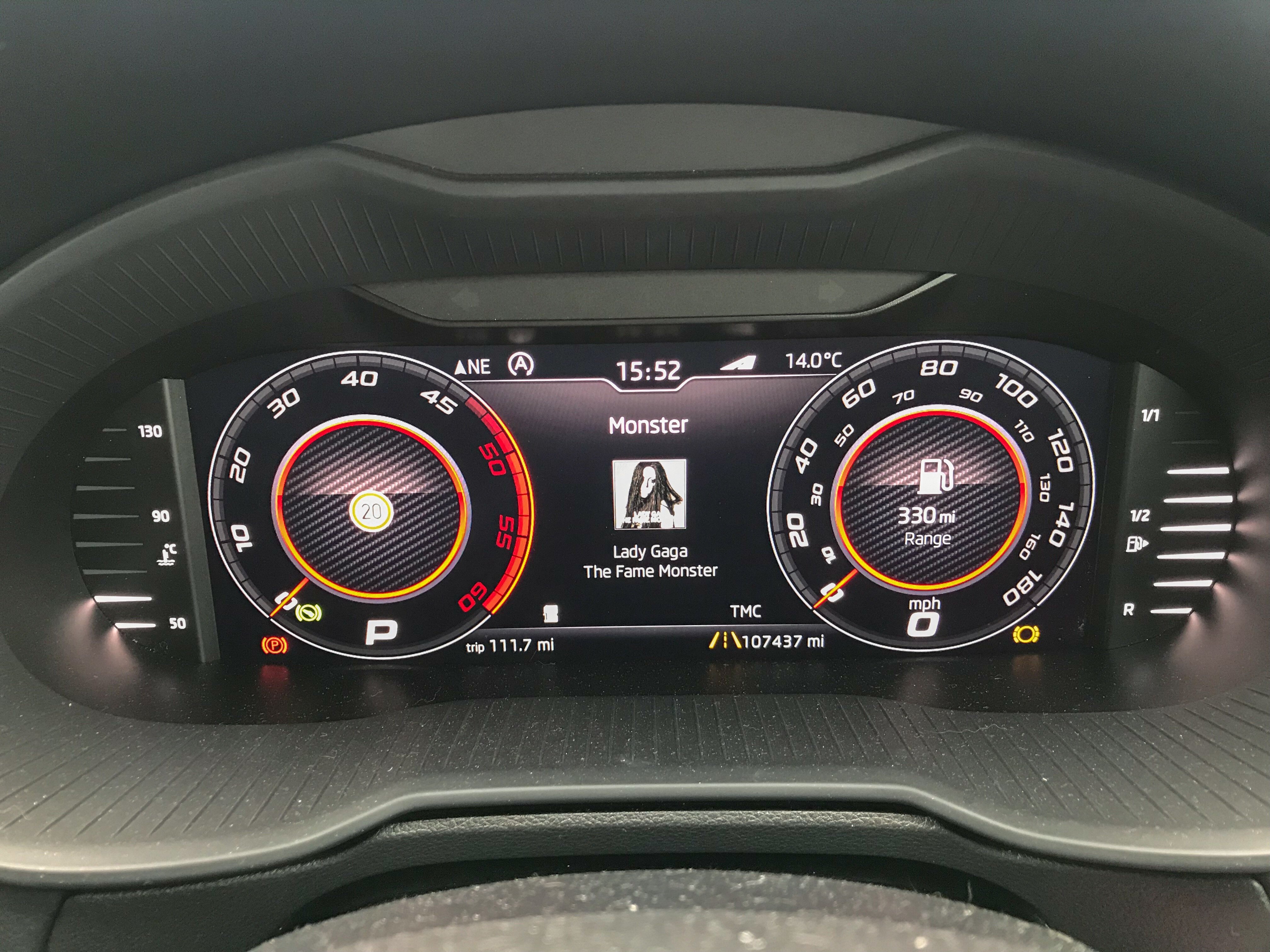

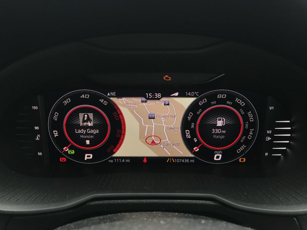

  • Talking of things that are done and working, barring a few things I need to sort, the virtual cockpit is in the car!!!!!!      Here’s how it ca

  • Oh yeah!!!! It’s finally sorted, a couple of adaptations and coding changes guided by the genius that is @pab567 I have finally got the map mode working and it is awesome  So it’s confirmed that you d

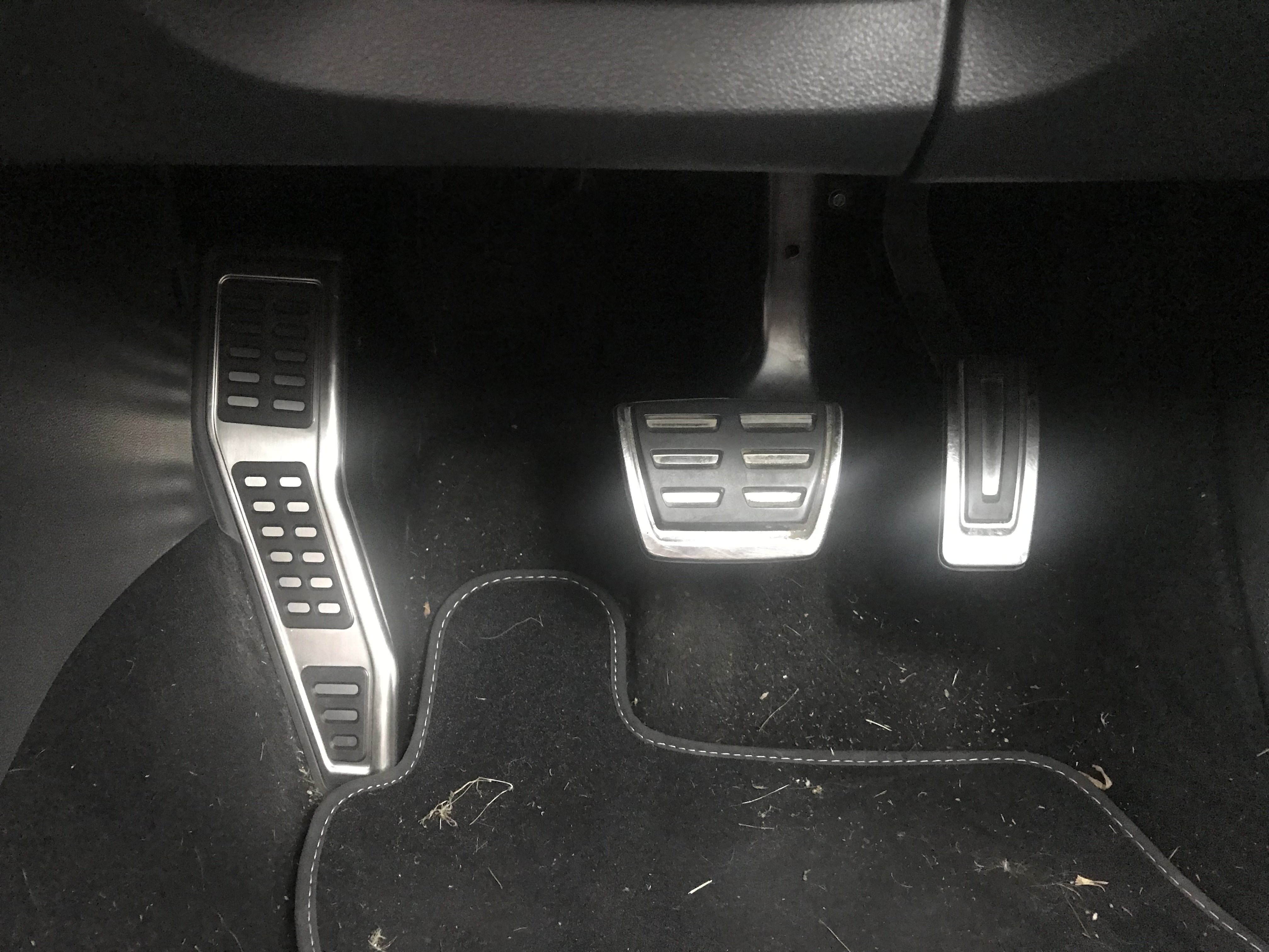

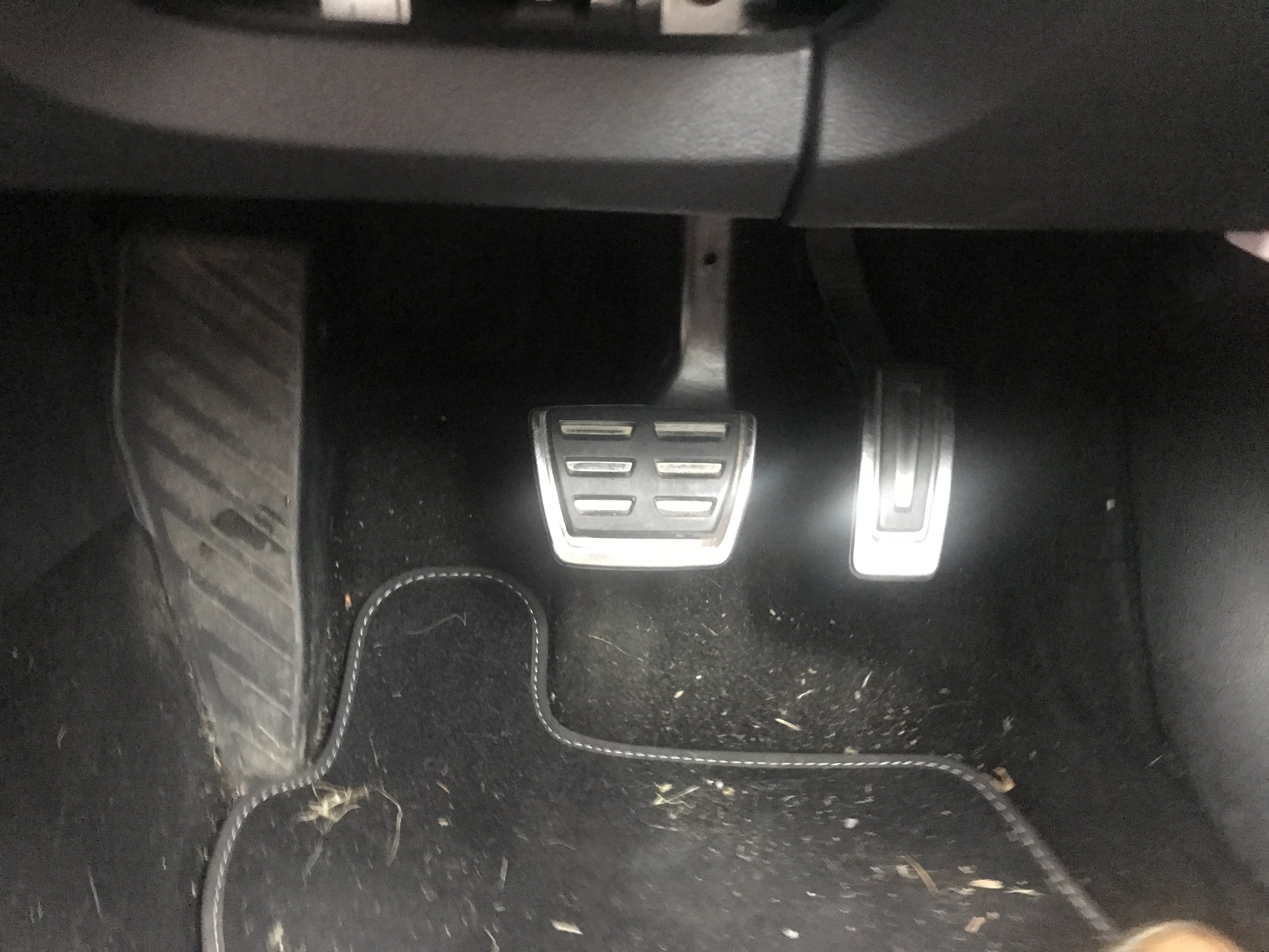

Finally gotten around to doing an interior mod I’ve been considering for ages! Thank you 20% off SuperSkoda :)

No, it’s a whole new footrest. One torx screw to remove it and then replace with this one.
