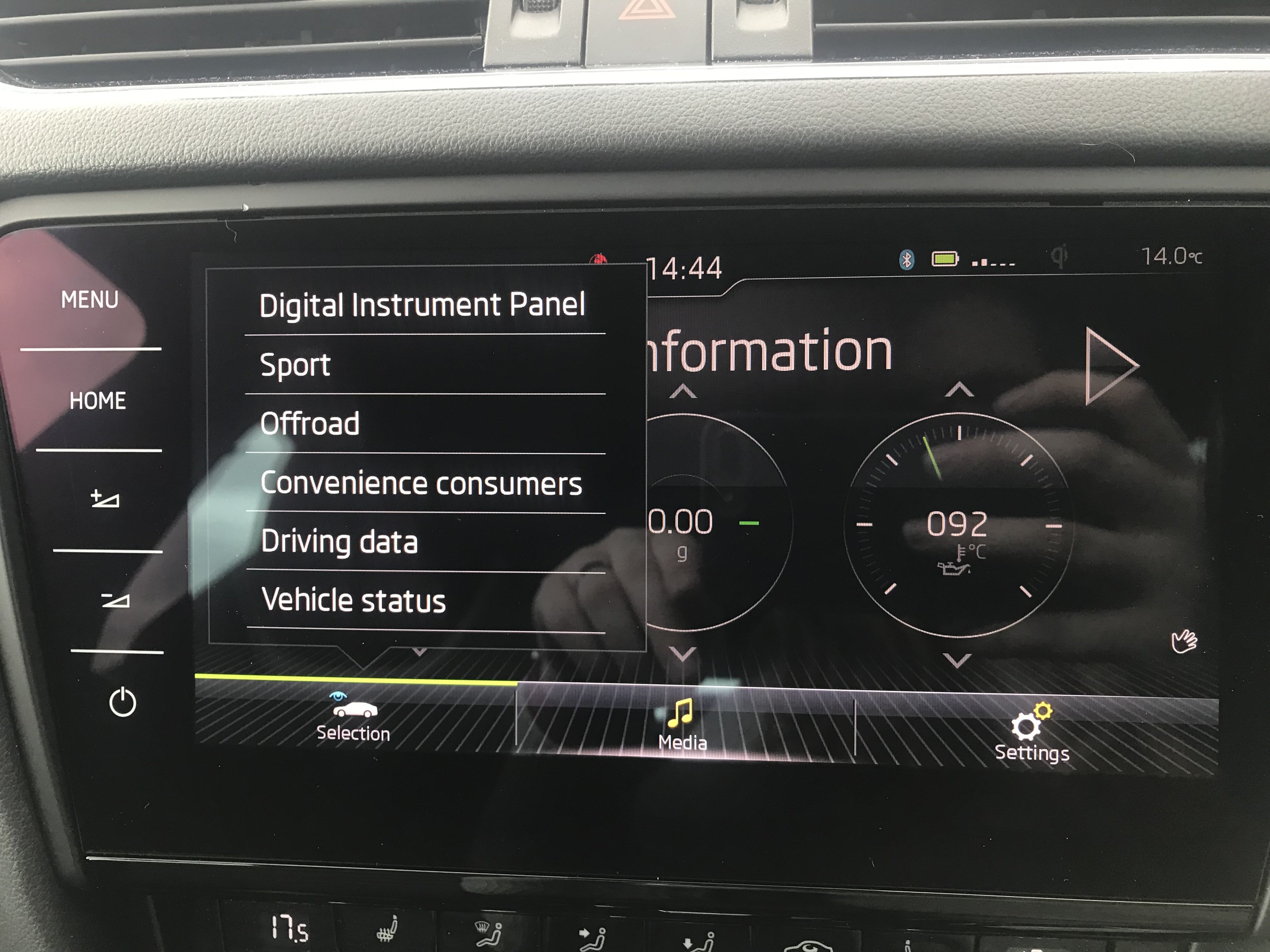

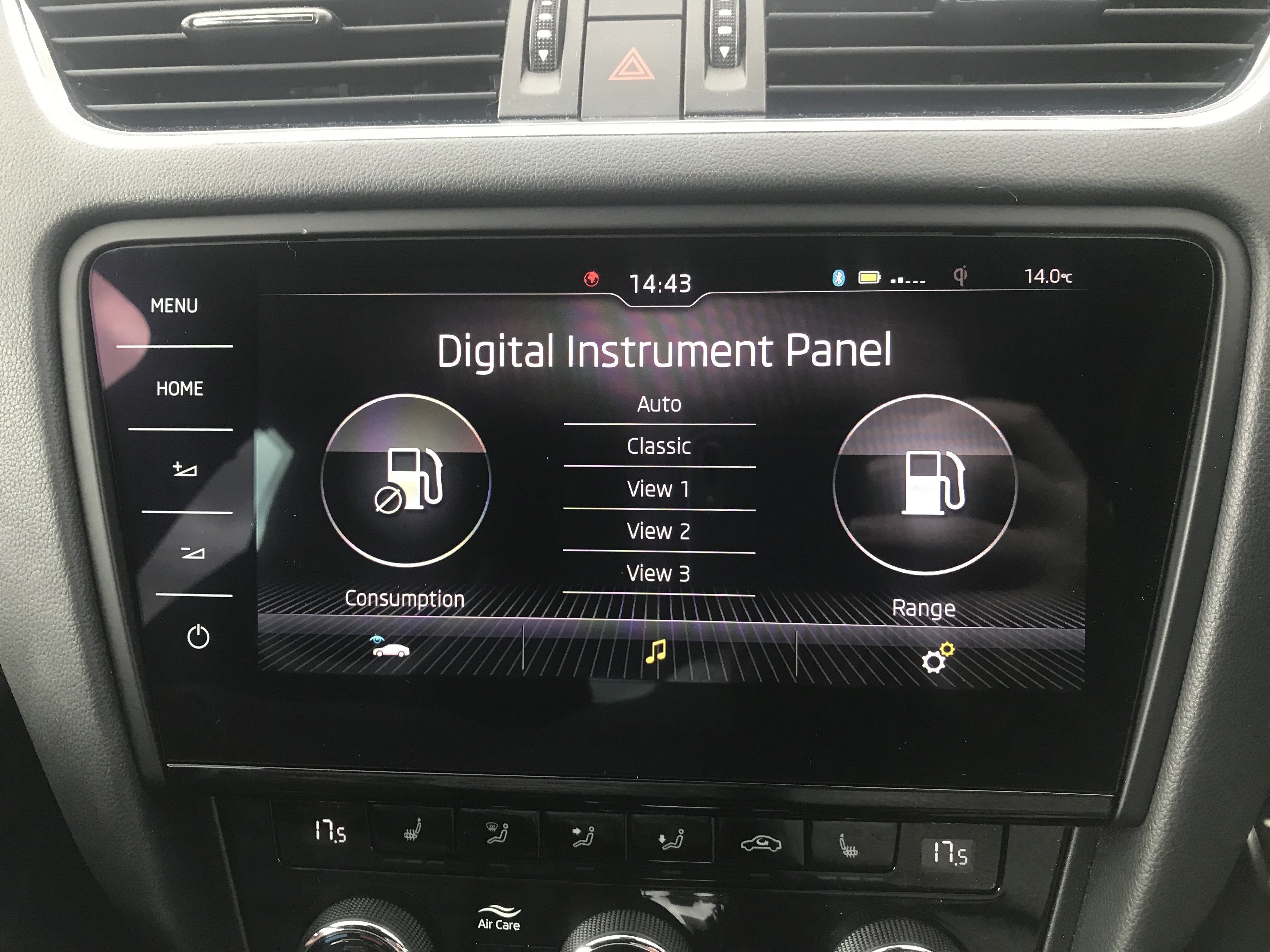

Guess what I have installed today?:D
Question if you can please help. I have gateway Q3. Do I needed anything else to have this menu? Do I need the fiber optic cable? Or just coding?
Does anyone have any idea?

Nice one :) ambient lighting is on my list as I need a new BCM next. For the menu you will need to run some coding. You will need the fibre cable for map mode. What radio do you have? You will need to code that too. PM me with the details and I’ll link you to the coding.

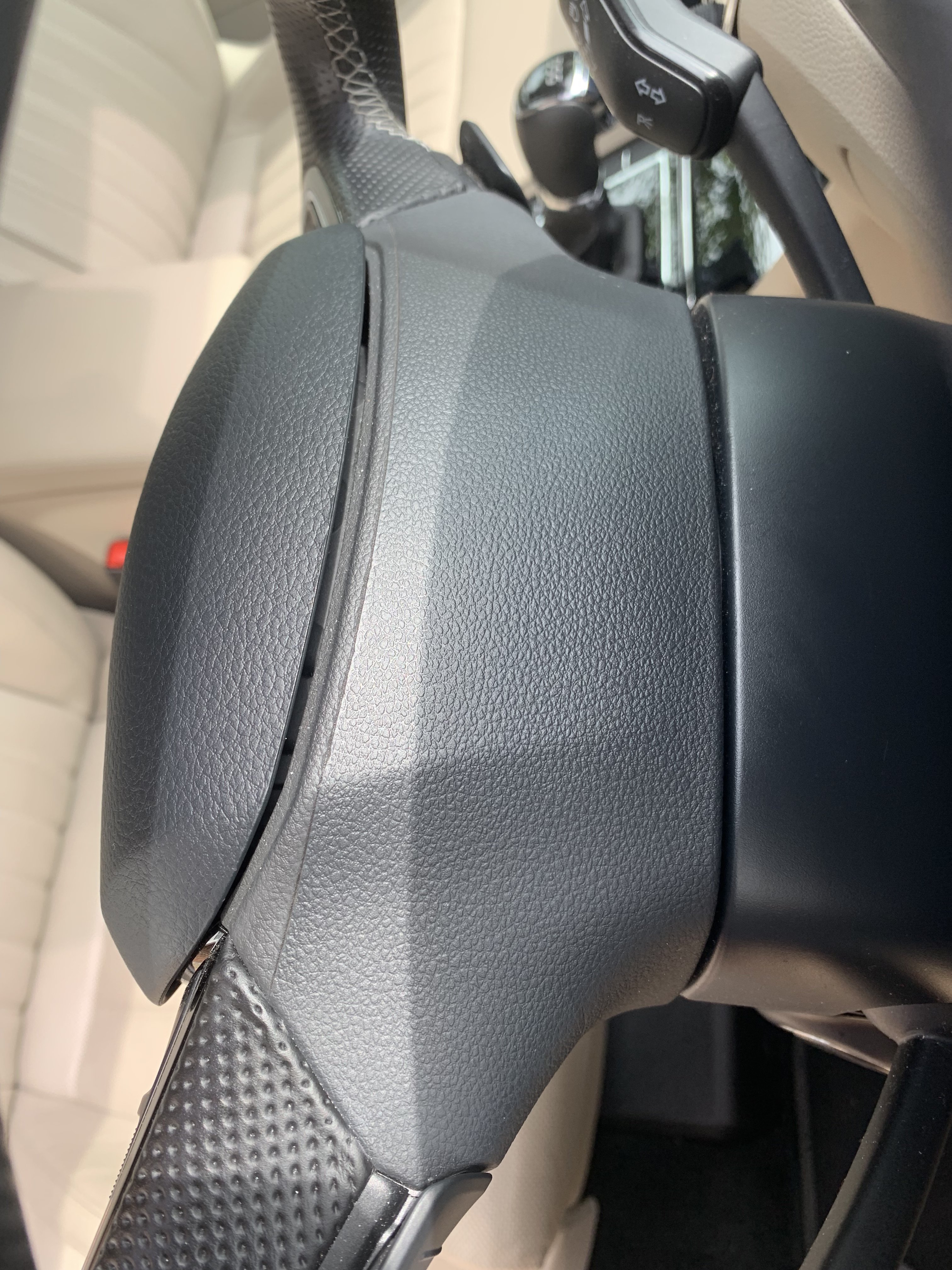

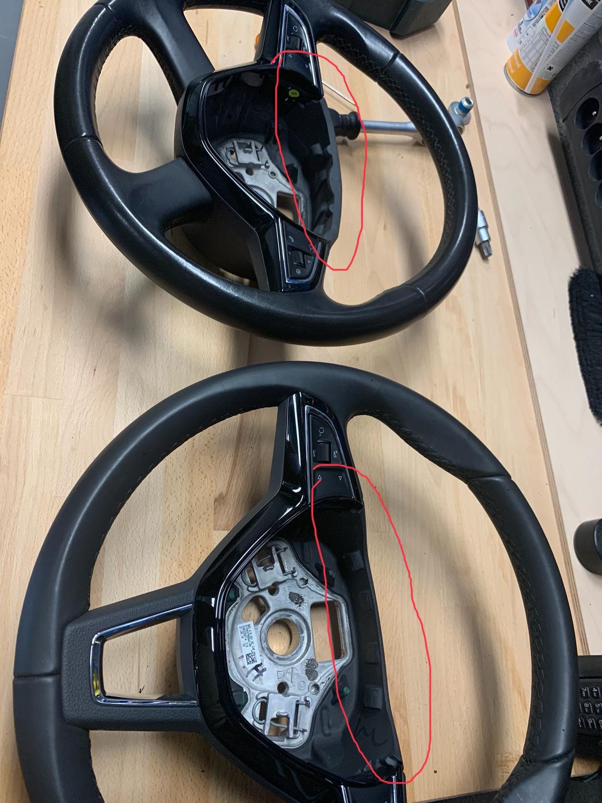

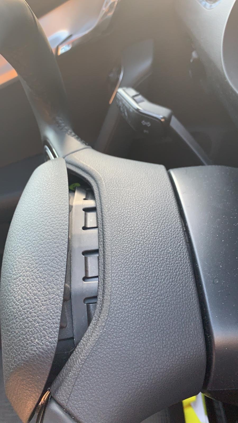

I can tell you guys it needs a different airbag!!! Here I will give you some pictures of it:
Difference between 4 spoke MFSW and 3 spoke sports MFSW. Check out the depth in the red circle!
If you use your 'old' airbag, it will look like this after installing it.
Hope you can use this information :).

The difference is the H models support steering wheel heating. The F models don’t from what I understand.

Any chance you can post the photos directly onto Briskoda?
From re reading the post I think the point is that the 4 spoke wheels have a different airbag to the 3 spoke wheels but that doesn’t help to determine if the heated wheels need a different airbag. From the one thread I have seen where someone does this, they don’t mention changing the airbag, so the mystery deepens.
38 minutes ago, Gizmo said:
This item is only available to registered members.
Ofc I can!
Can you put them in place in my previous post? I can't edit it anymore...
Edited by Gizmo
This has now cleared it up I think,
my 3 spoke FBSW (which is NOT heated):
Compared to @HarrieSkoda 4 spoke airbag (they are both the same)

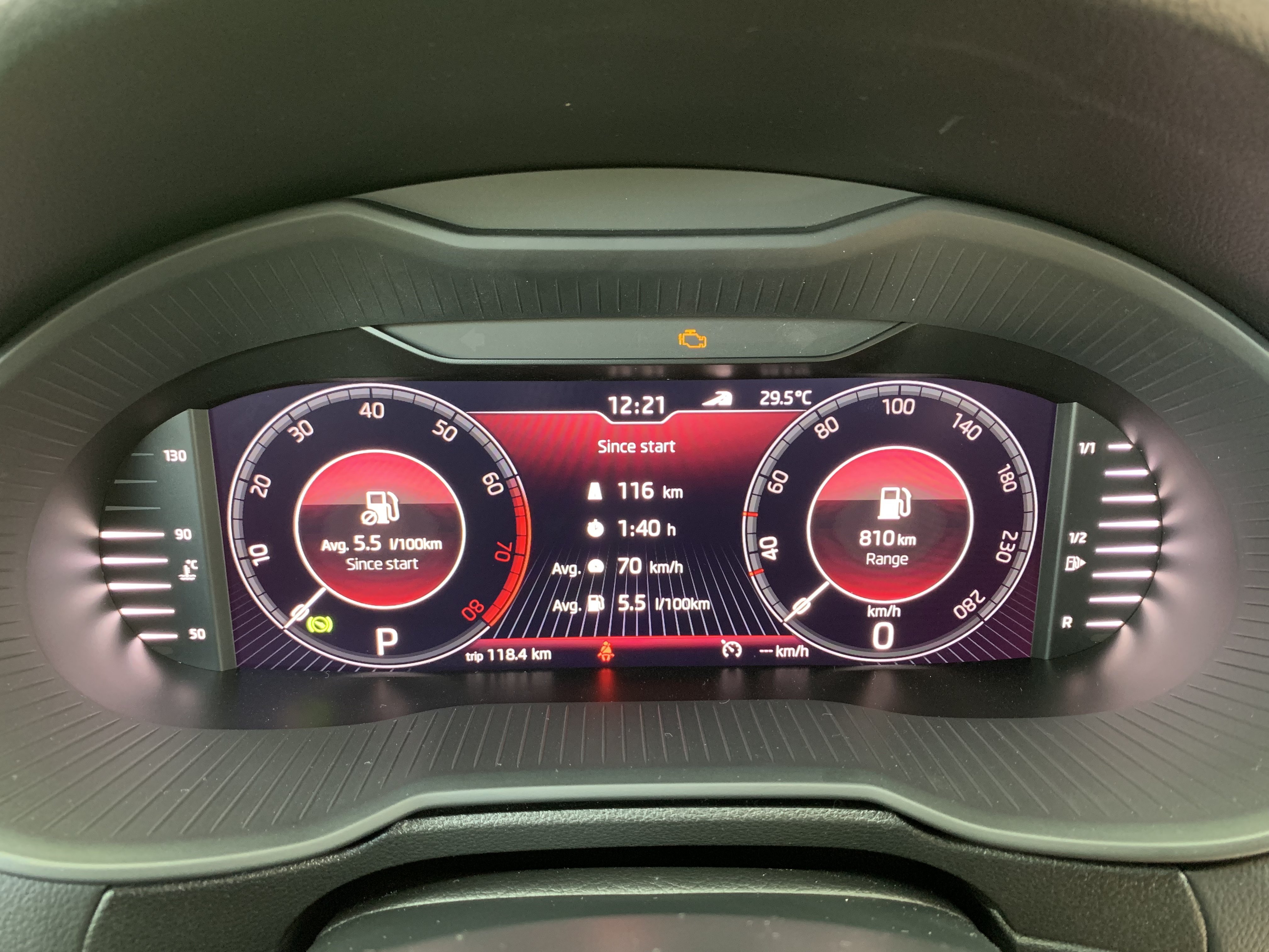

It finally happened!!
What averaging 40mpg or getting 400 miles from a tank? Joking finally cracked the Sat Nav screen between the dials. You need to post this picture on the show us your odometer thread with all those 1111111111111111's.:thumbup:
Should have sat still for a few minutes to knock off the .2.
The nav mode has been done for a while now, just been waiting for the mileage shot. Been using it less so it’s not climbing up so high these days.
