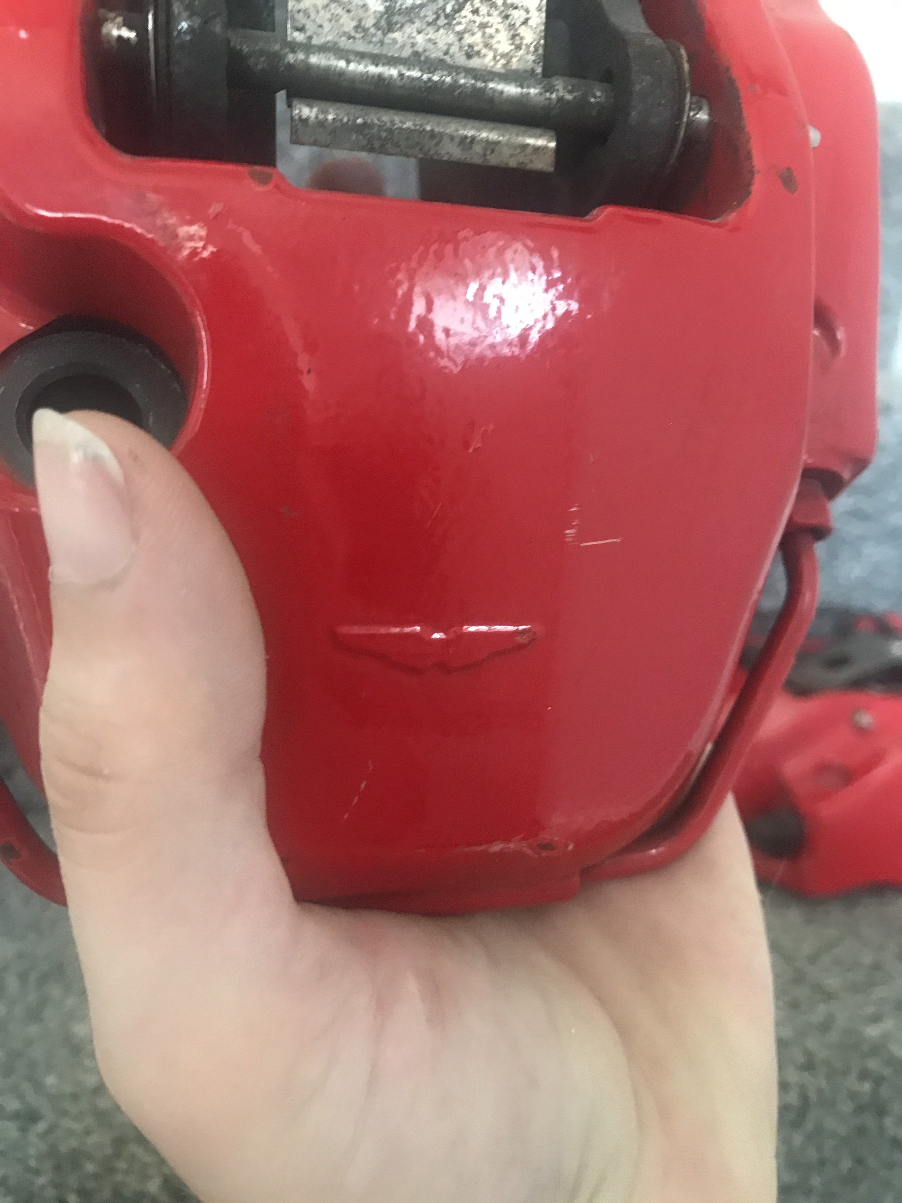

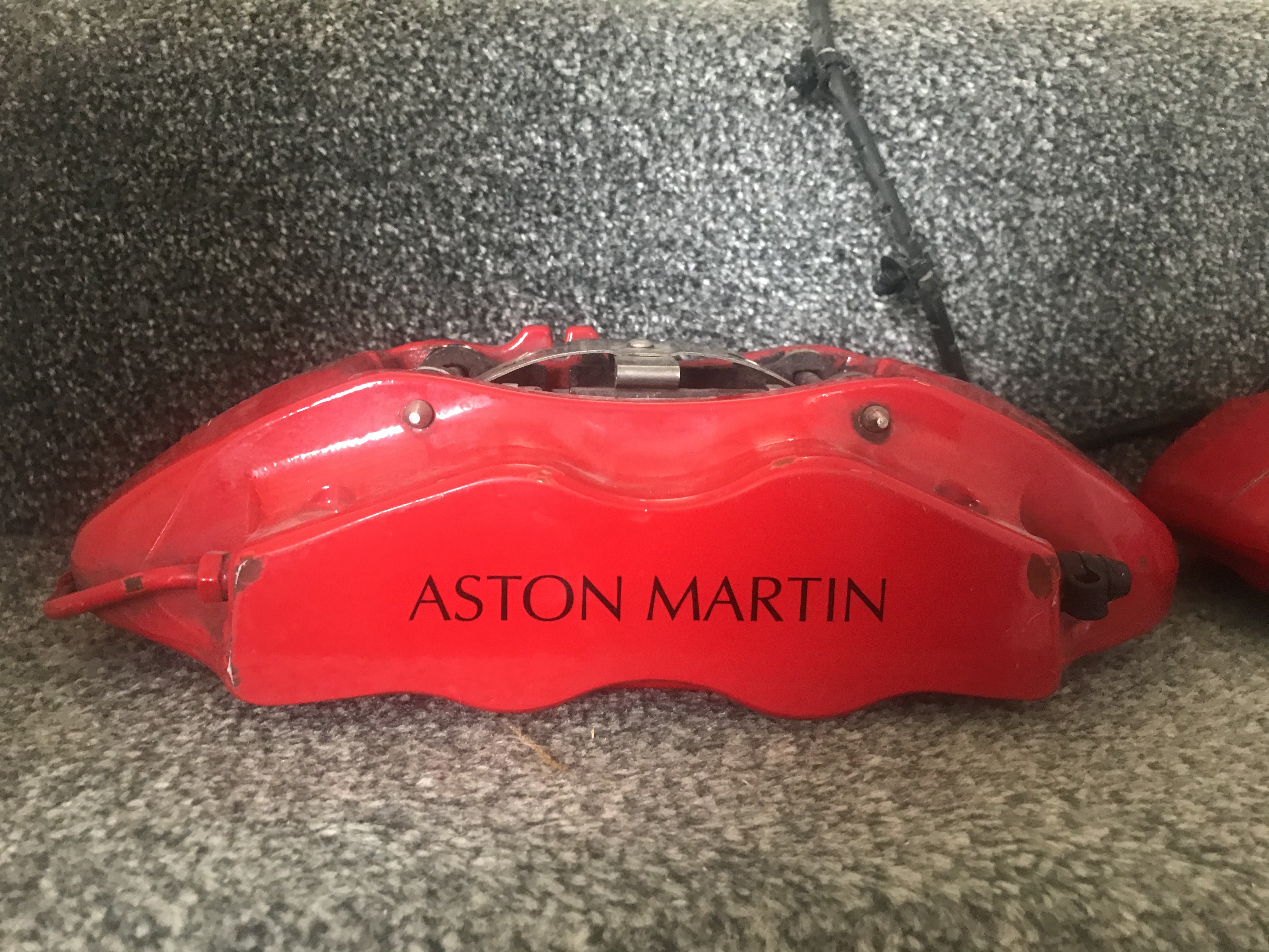

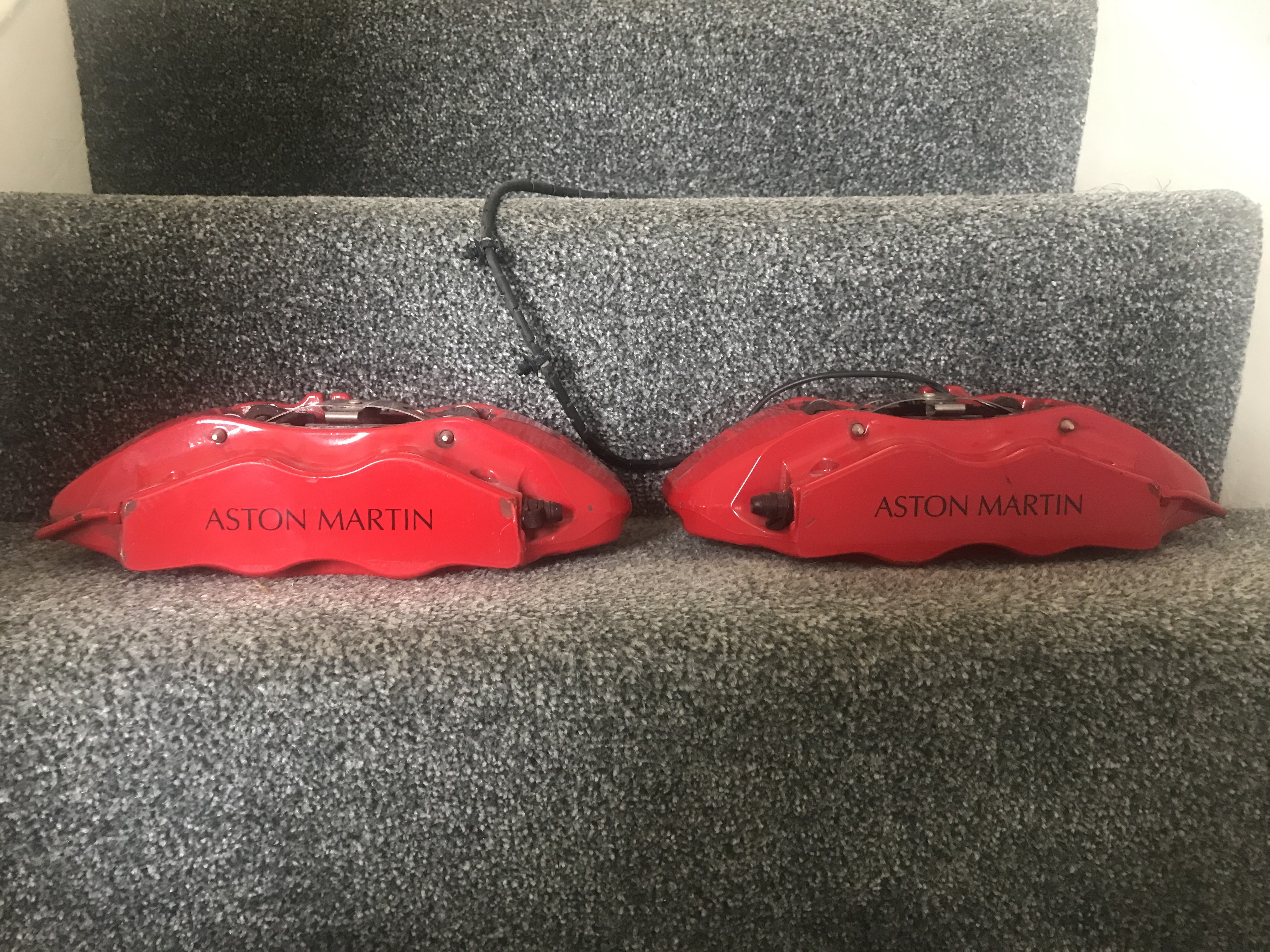

After lapping Donington and deciding that the already large 340mm front brakes on my car were simply not enough, I had to go multi pot. Sadly I have no money for an off the shelf upgrade but I do have the internet and lots of time to search Polish eBay for cheap exotic car parts. Welcome, friends, to the closest I am ever going to get to owning an Aston Martin, a pair of DB9 brembo calipers and yes they are proper AM ones as evidenced by the logo which is embossed on both. These were a total bargain and the exact same model of brembo caliper used on the 8J TTRS and thus bolt onto the Octavia with the correct Audi carriers. This is stage one of the brake upgrade, stage two will be 370mm discs to match but these are still usable with the 340’s for now. Just have to touch the paint up and get them on the car 😀

I assume a quick lick of paint is just to get rid of the Aston Martin badge?
No way! AM badge is staying, touch up is just to get rid of worst of the marks and chips.
