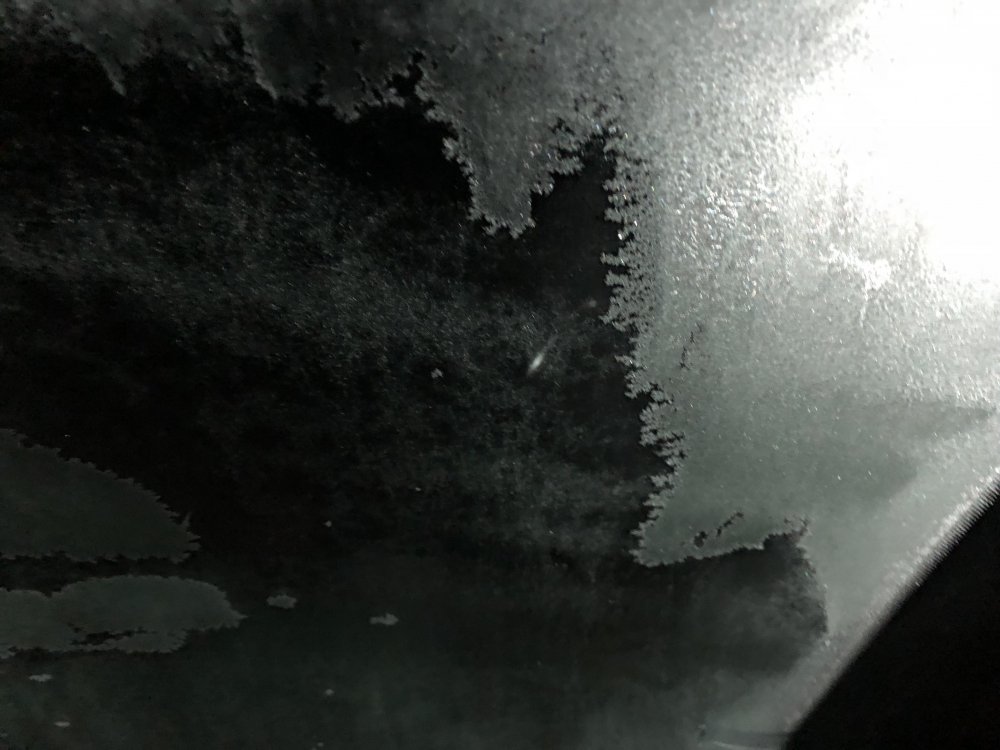

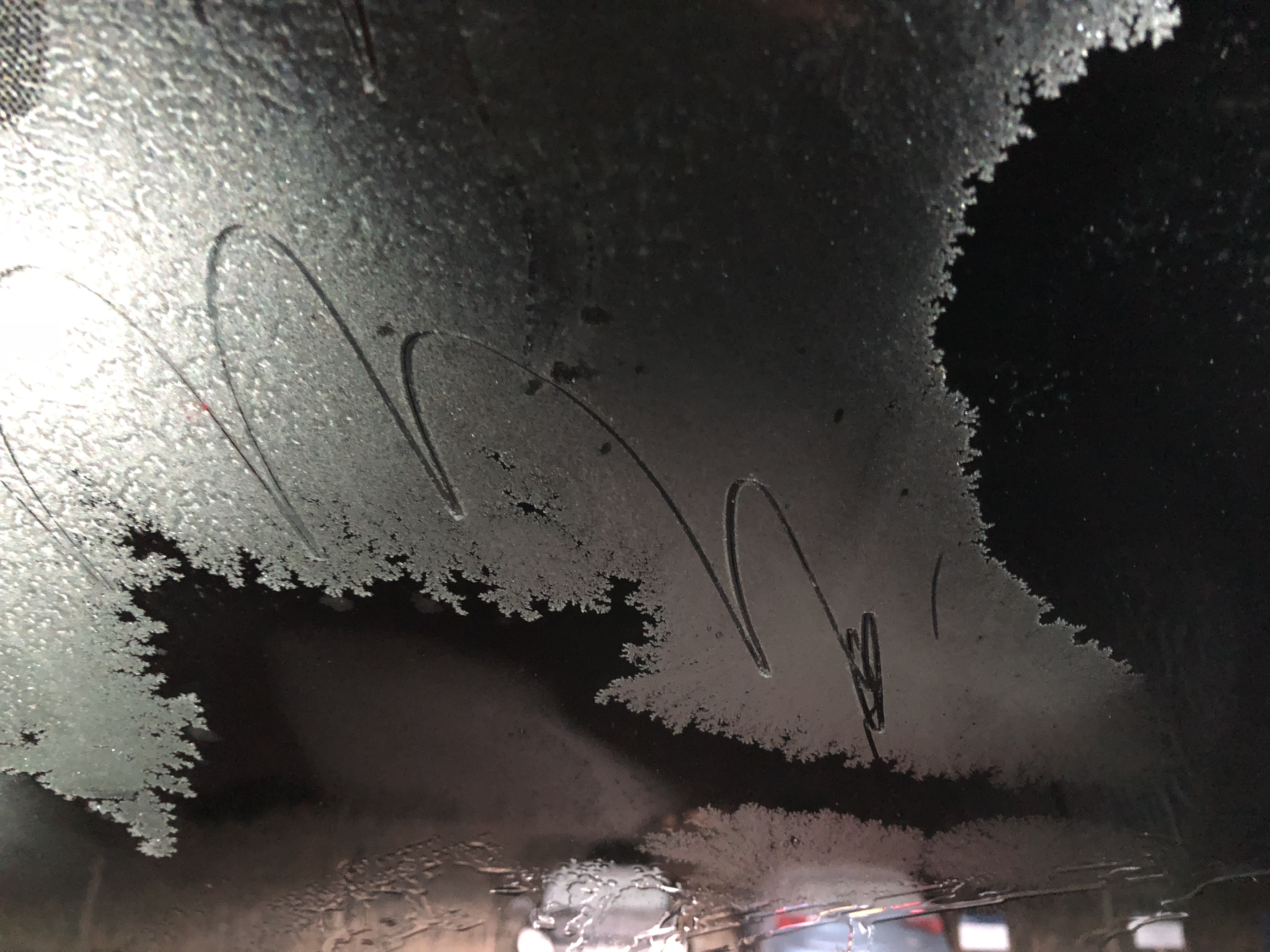

I have noticed that I am suffering with ice on the inside of my windscreen - didn’t particularly notice in 2016.
No damp carpets anywhere. I don’t tramp on lots of water as normally just me in the car.
None of the other windows have got the ice on the inside.
Car at serviced by Skoda and under warranty - 65 plate.
Other than take it in to Skoda which I plan to do - Surely this isn’t normal??
any advice or responses appreciated.
Thanks
Ryan
