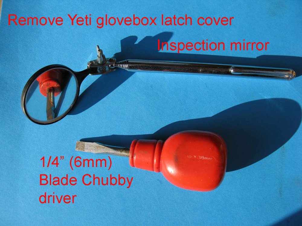

Job done but seeing how to remove the slide latch cover with hidden screw behind is the hardest part! Once removed there are 3 T20 screws across the top and 2 T20 screws underneath. Disconnect airbag, light plugs and cold air hose. To replace the cover you put it back about 20mm to the left of center and slide to the right. Use a 1/4" blade driver and mirror to locate the slot and plastic release clip underneath the latch.
This is a great way to get mod. wiring from the engine bay, behind the glove box, into the cabin and center console.
