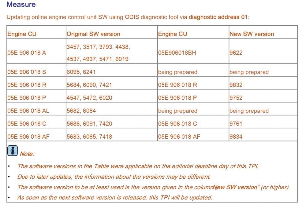

Have just had the update on my MY18 1.5 TSI and the new ECU version is 9752.
The car seems a lot better with a much smoother throttle response. I think the roo is still “minorly” there (sometimes) when you take off for a moment but its vanished after that.
So, i am satisfied for the time being. We shall see how it goes (or "roos").
Is this the first update you received?
Yes.
My problem was not from the start but after an ECU update for an ECU fault back a year ago.
11 minutes ago, fidelio said:
Yes.
Just want to understand, did you install the update released in August (in the attachment) or is this a new batch of updates?
Edited by kifir
From what i see its the one on this table 9752. When was this released?
Ends of August.
That's the latest then
You sure? Thought there was one first week of September?
Maybe it goes by the ECU number. Some are latest than others???
Does anyone have an info about a newer firmware for the same engine type? If yes what is the number of that version?
