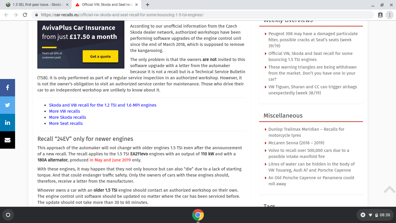

https://www.kfz-rueckrufe.de/vw-seat-und-skoda-rueckruf-wegen-anfahrschwaeche/6785/
https://translate.google.co.uk/translate?sl=auto&tl=en&u=https%3A%2F%2Fwww.kfz-rueckrufe.de%2Fvw-seat-und-skoda-rueckruf-wegen-anfahrschwaeche%2F6785%2F
