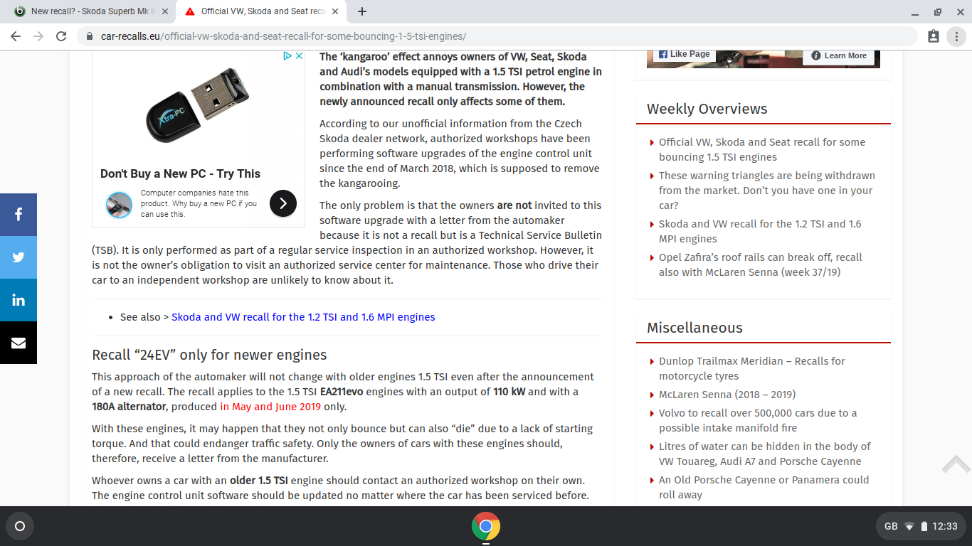

Are Registered Keepers Receiving Recall Letters, if not it is not a 'Recall' might be a Recall Action / Service Campaign.
A phone call from someone at a Dealers saying 'There is a recall' is not a Recall either.
Example.
A Recall Action / Service Campaign on 1.2 TSI & 1.6 MPI engines and if the car is not Main Dealer Serviced owners might never know, and even if it is in at a Main Dealership they might never know,
yet it says it is a 'Recall.
http://briskoda.net/forums/topic/472548-skoda-recalls-there-are-just-so-many-and-so-many-that-never-hear-of-them
This was a Recall Letter', but a voluntary recall that the DVSA allowed VW Group to have on the DQ200's,
and it was not a Recall on the Government site, but the DVLA gave VW the Registered Keepers address & VW Group send the letters.
It was a Recall Action.

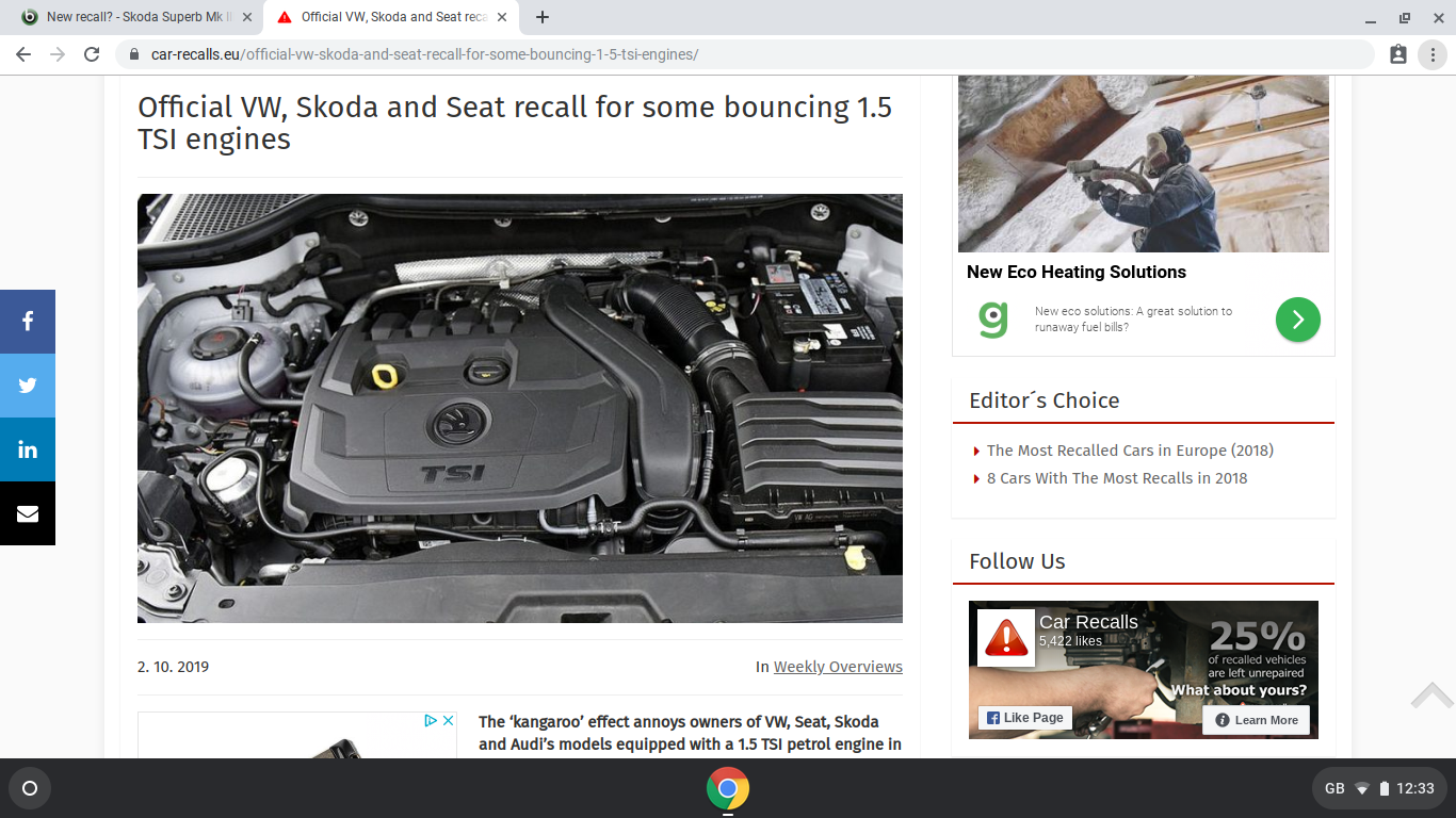

  • Left the below on a SEAT forum but thought I’d share as I’ve been taking interest in this thread the last few weeks as you’ll see why below.   Just going to leave this here for peoples’s inf
  • Had my 'independent' vehicle inspection yesterday by a company appointed by Lex, the mechanic came out and drove the vehicle for 2 hours on b roads.   He returned to report I was correct and
  • At last we have successfully rejected our 1.5 TSI manual and got a full refund! Was bought through PCP VW Finance. Skoda UK and dealership argued kangarooing was a 'characteristic' and that the loss o

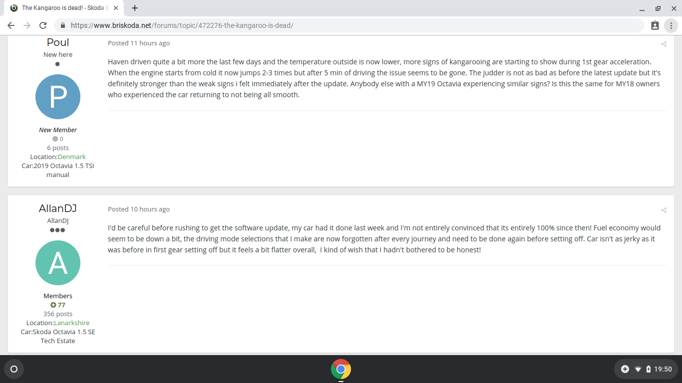

Had the update. It's a lot better, I would say the kangarooing is 99.5% cured. Had a follow up call from Skoda UK today. During conversation they stated no more updates are planned. Apparently the issue was lack of power to the alternator. Not 100% convinced about that. So hopefully all sorted. Not entitled to anything for putting up with it for 9 months as the courtesy car I had for 4 weeks back in Feb wiped out any allowance apparently!

The SW update is done.
No kangaroo anymore.
My car is a MY2019 Octavia with particular filter and "AL" engine control unit.
If the problem is in the alternator, then why the jerking force is not changed when all possible consumers are turned on.
I wonder if it is possible to replace the ECU from “BH” to “AL”, and whether this will solve the problem for cars which the update did not work.

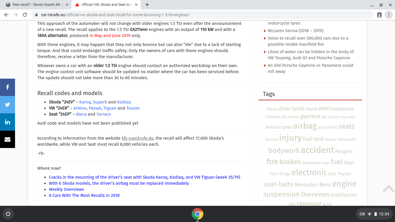

I've been away this week, but my Karoq is due into Skoda next Tuesday for more details. Basically Skoda Tech Support took my original diagnostics and asked for more info and a "video of the behaviour". They feel the software update I had on 21st August should have fixed it, but it clearly hasn't. I need to figure out what ECU my car has to see if it is part of the recall action. I'm not sure how specific those gov.uk recall actions are.....is it just if your car is a Skoda Karoq from 2019 they say there is a recall and to check with my dealer, or is it specific to my VIN and engine model etc.
https://recall.skoda-auto.com/210/en-gb is working again now to check for recalls using your VIN. I did live chat and was told about the 24EV A-Engine control unit recall for mine. Had it done on Tuesday. Roo has not completely gone but is slightly better than it was & car is still not picking up in 2nd correctly.
