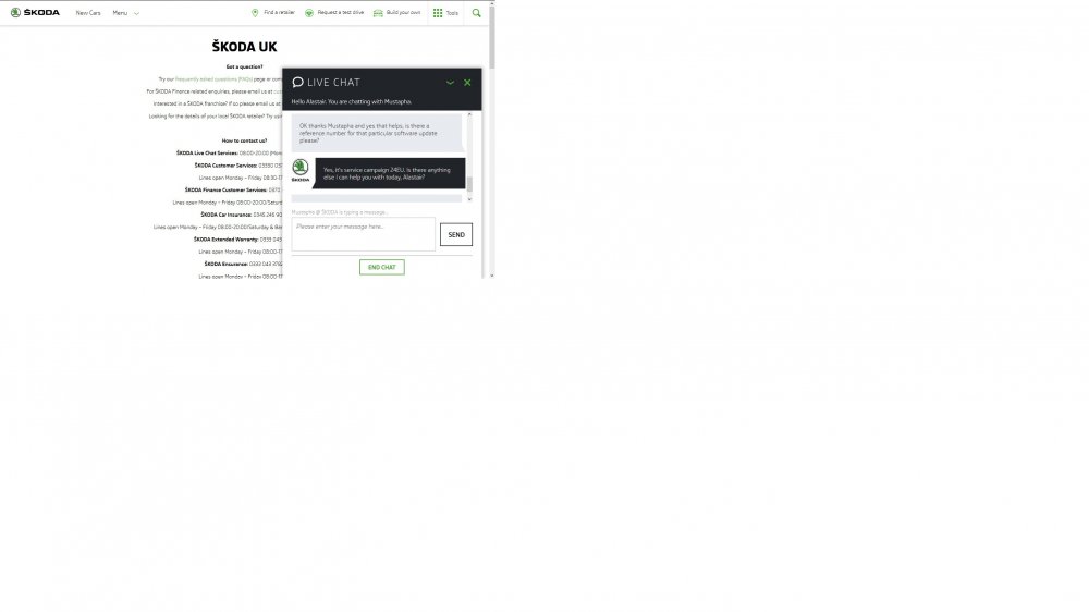

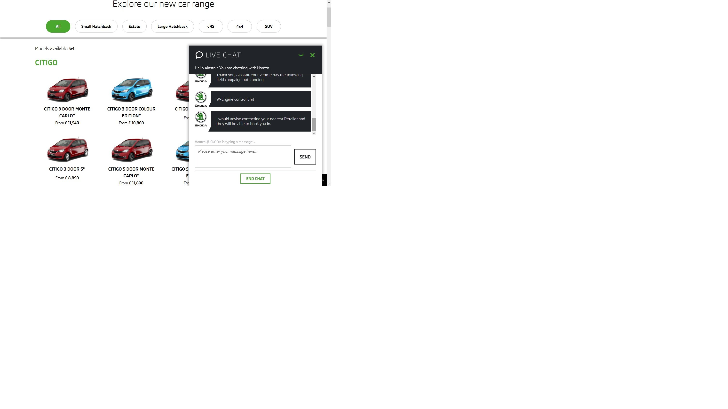

Just tried the website for recall campaigns and it is still not functioning so used the LIVE CHAT contact and after giving the VIN details there is an outstanding field campaign for my Karoq (MY2019) of a W-Engine control unit.

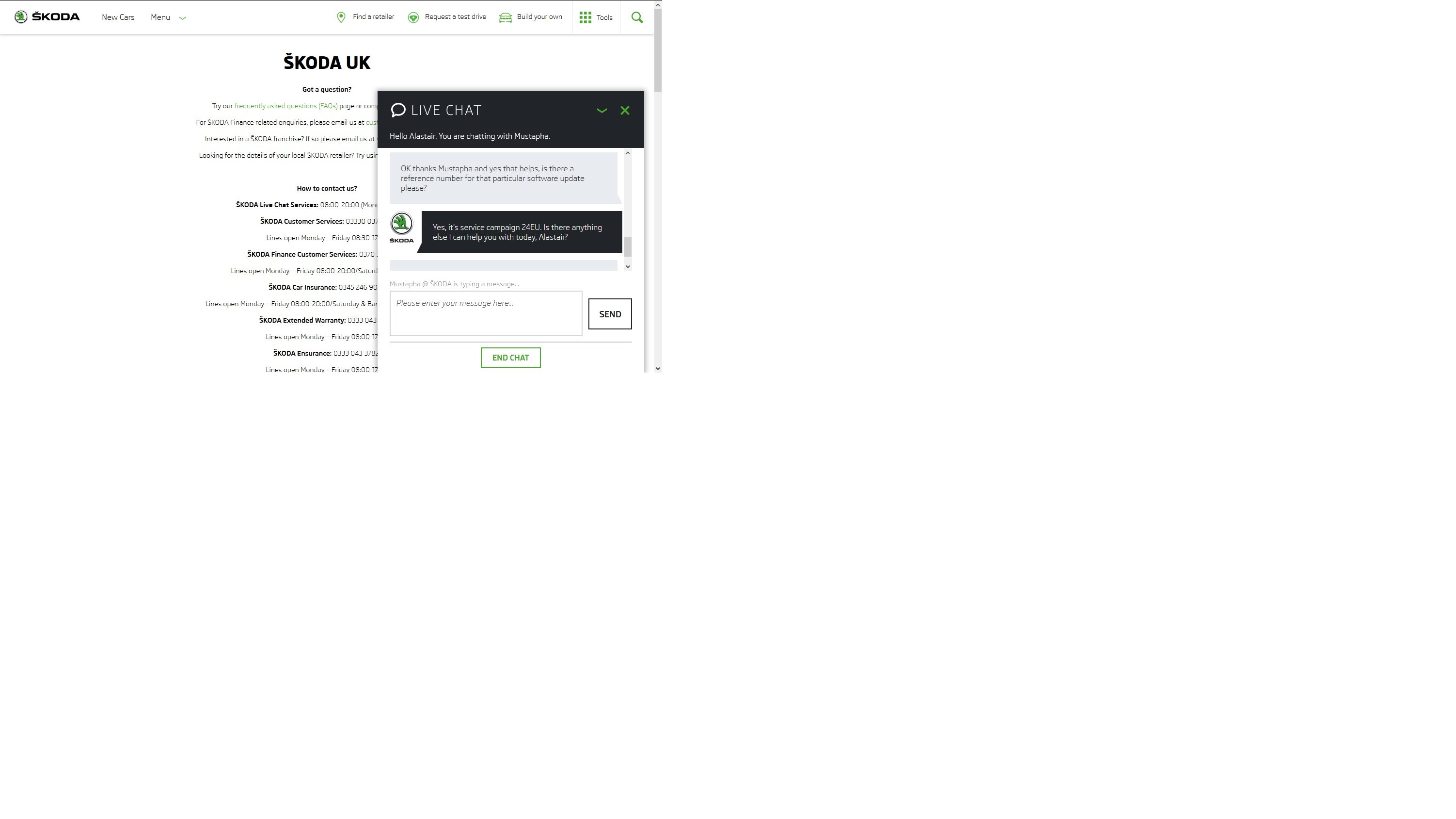

Just had another LIVE CHAT to confirm earlier feedback and the Skoda service campaign is indeed 24EU

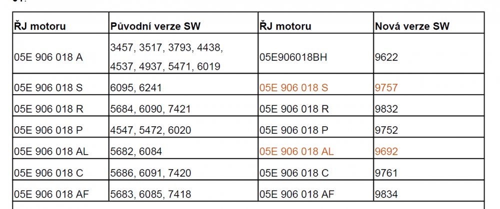

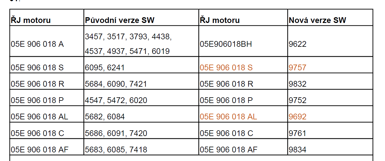

@kifir Maybe that's because the karoqs are the most affected models with this "characteristics". So they created service campaign. But they will not do anything special just update with the latest sw. The important thing is that for each model there is already new sw. So each model can be updated. It doesn't matter if there is campaign or not. As I read your previous posts it looks like you have the latest sw for your model. So there is unfortunatelly nothig you can do now. Even if there is service campaign formally created for your model of octavia. You already have latest sw. Only option for now is to wait if there will be new sw for your model. That can be really frustrating. But as you mentioned your experiences previously it looks like it behaves differently than "standard kangaroo characteristic".  It looks like your engine has more serius issues that cant be solved by latest sw fix. This is just my guess.
My guess is that MY18 behave differently than MY19, so we shouldn't  generalize on 1.5 sw update
Yes but for MY18 there is new sw as well. Each model has already new sw. See the picture below. First column is Ecu version. Second original sw version(s). Last column is for new version number. So they should know how each model behaves and how to fix it.

UPD: I have not yet seen any feedback that 9622 cured the problem.
@fidelio Looks like, but if all MY19 get a fully working update, that's a good sign. Then we can be sure that this is a software problem, not hardware. (As an option for  MY18 owners, wait for stage1 from  some company like REVO or APR eg.)
