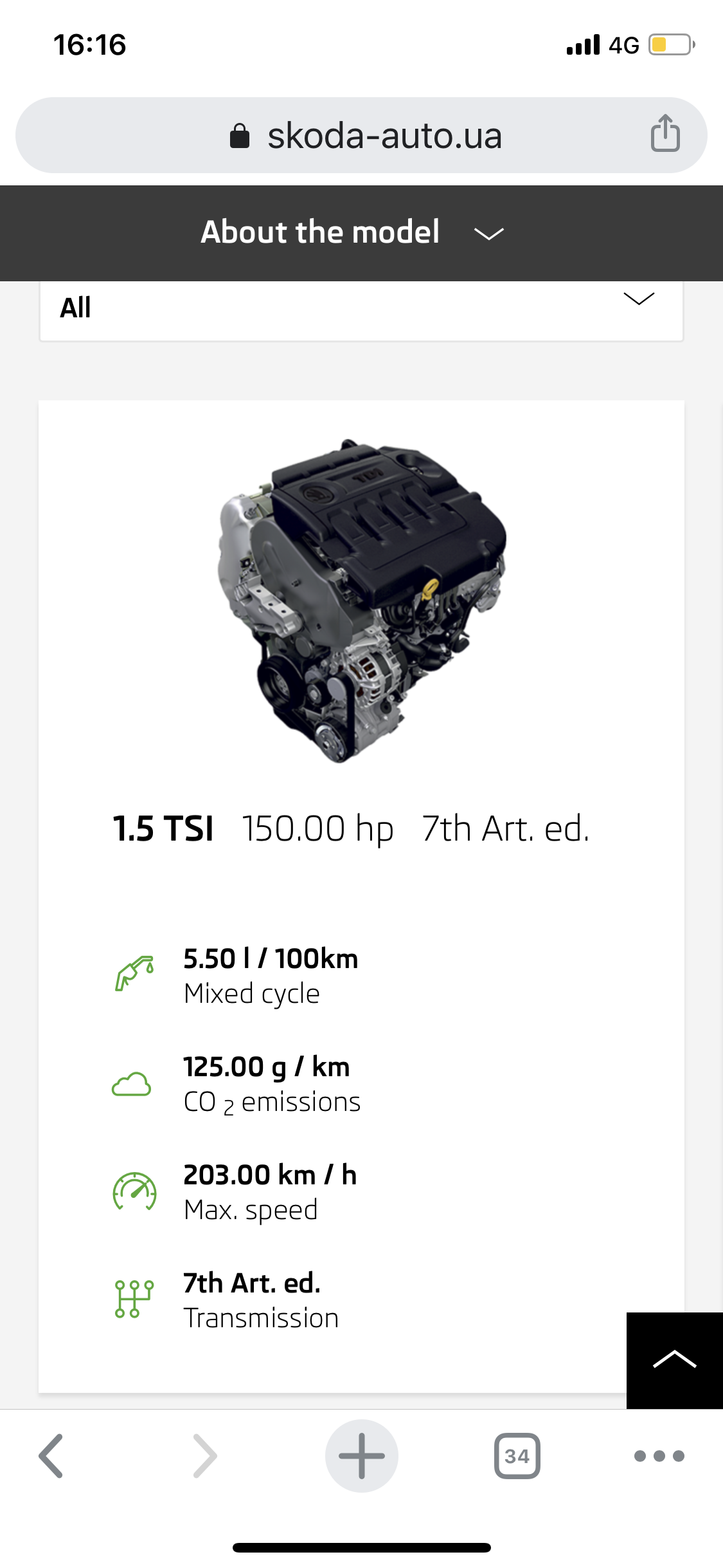

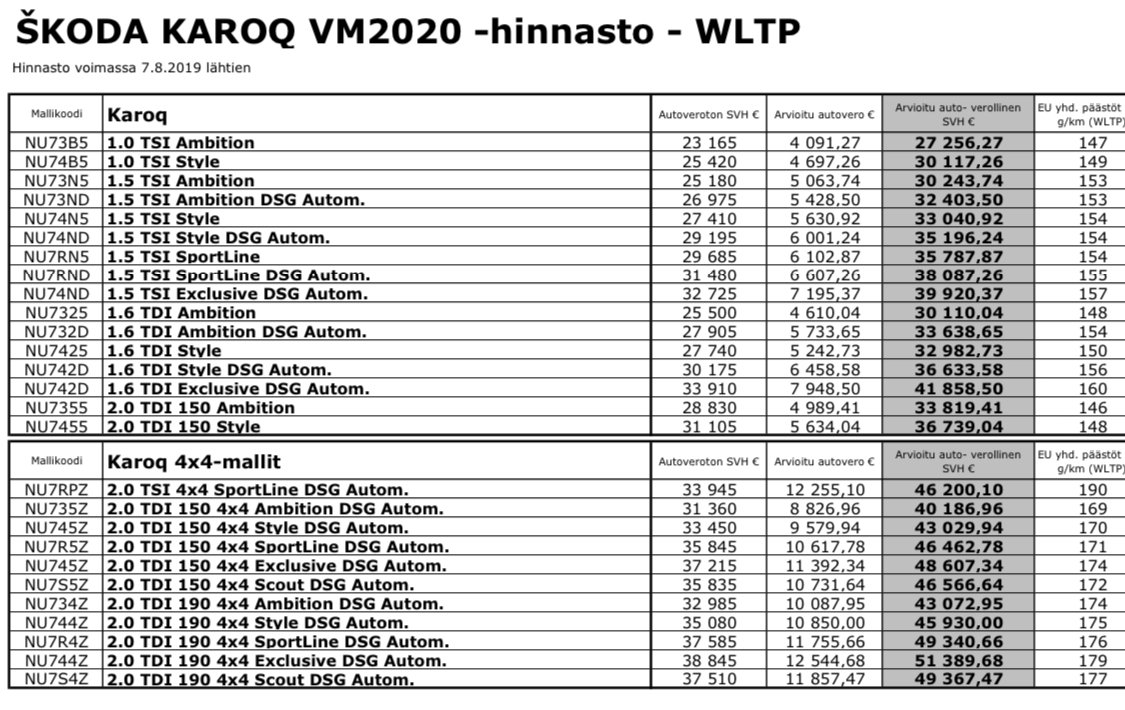

All what I found about Karoq on ukr website, it is CO2 start from 125. In Finland from 153.
Very strange.
Those are simply WLTP values as opposed to the preWLTP values in Ukraine
Just check erWin.

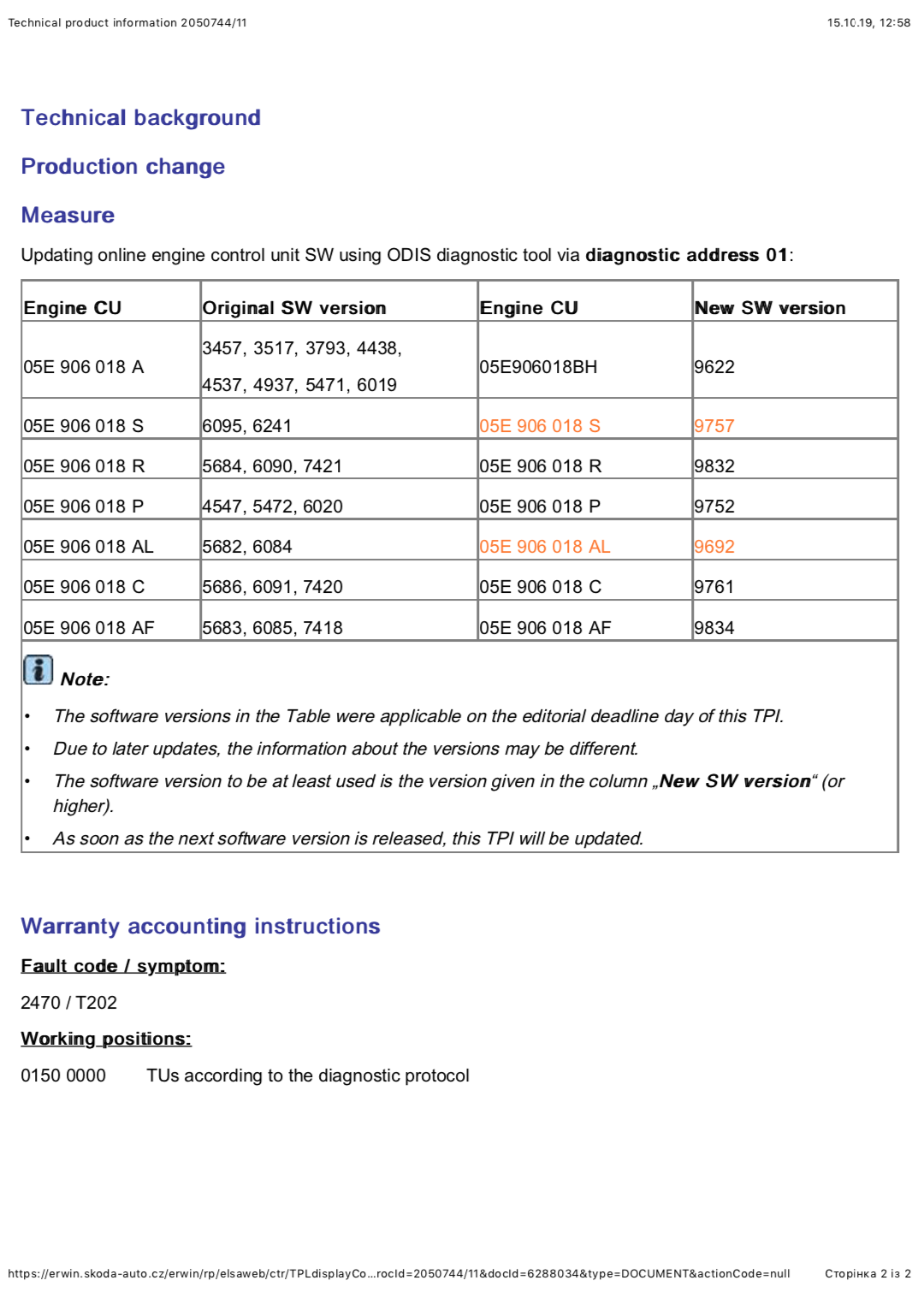

2018 Karoq in the garage today and updated with “TPI 2050744/11”. Definitely feels different, smoother I think, but can’t quite explain it yet.
Had a weird issue when put in reverse to go onto driveway where I brought the clutch up and it just didn’t move until I dipped the clutch again. Weird. Not convinced yet. Will see how it goes!
