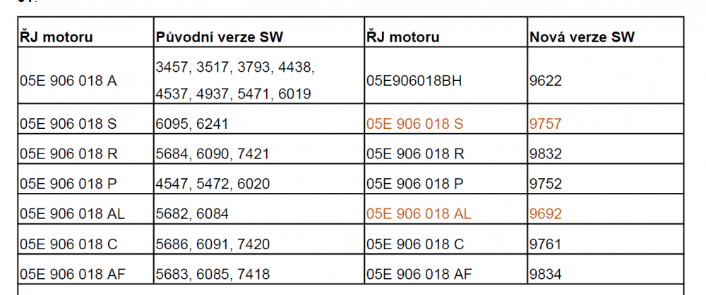

If I understand correctly, BH (A) model had only one update in August It was “9622”. And it update doesn’t work (how I can see on this forum, and same for
me), but S and AL model received new update on September (orange in the table) and it sounds on forum’s like update which helped.01B80A06-6492-48D6-9B2C-1765478B4633.thumb.png.82398e31f7850a4eaf42928ee9a7dae7.png
