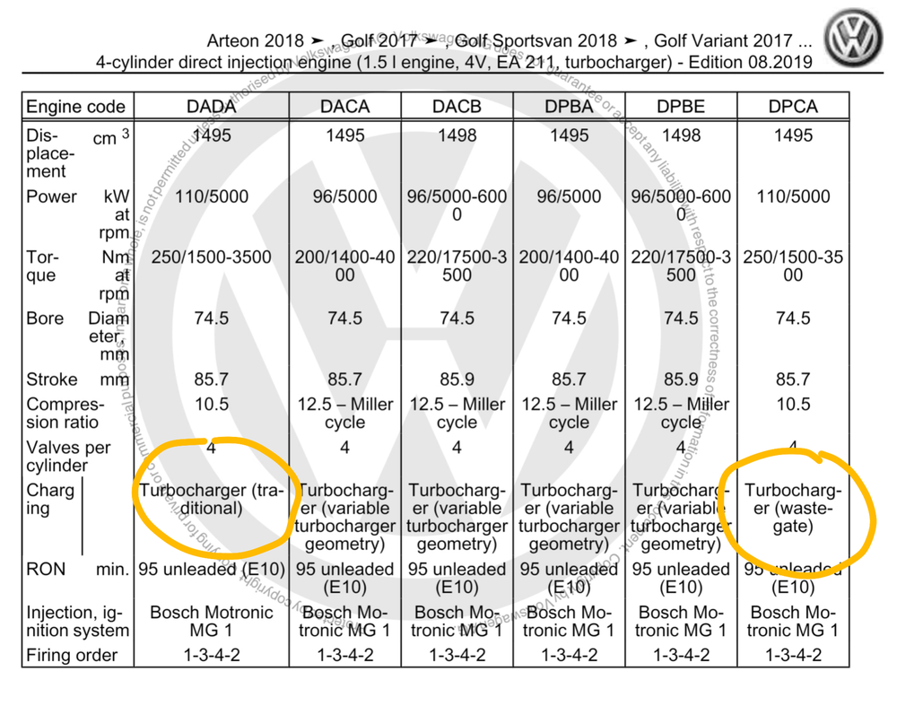

Hello,
It seems, that new DPCA motor code have different turbo.
How works traditional DADA turbo, which haven´t wastegate?
It might explain big turbolag on my DADA engine and kangaroo efect?
