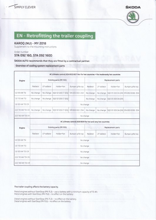

Are you sure? The only parts Skoda claim are different is the fan and grill.
The battery and alternator are unaffected...
I think it might be different whether it's retrofitted or done at the factory. When I tried to look up the details what preparation for towing included I couldn't find the details anymore. What I was able to gather from other sources is that at least a larger battery and increased cooling is included in the towing preparation package. Maybe I'm wrong about the alternator as I only have it from memory.

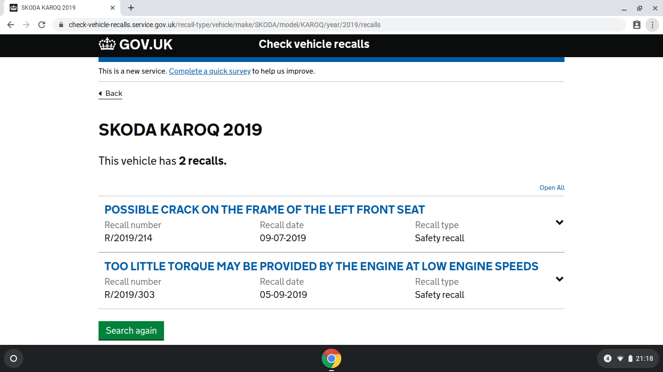

@Karr3
Is your car not part of a Recall where the DVLA in the UK gave Registered keepers details to VW UK / Skoda UK?
http://skoda-auto.com/services/recall-actions
That is flagged as a Safety Recall.
3 minutes ago, Roottootemblowinootsoot said:
@Karr3
Not sure, the dealership insists that mine was not a recall although the paperwork they had did say recall. They would not let me have a copy. I have sent V888 to DVLA for more info.

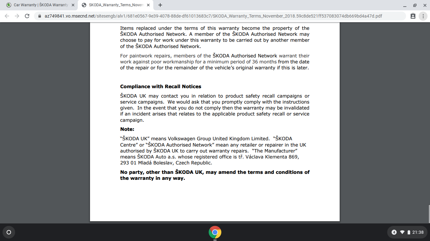

The thing with a Safety Recall is the Registered Keeper should receive a RECALL Letter,  not some vague call from a person at a Dealership. That is a recall action / service campaign.
The next thing is with a car, if you own it or even just drive it you are responsible and not some muppet at a desk refusing you information on any actions being carried out on your property for your safety, your passengers and the innocent public.
Data Protection is for your protection and maybe their Employees, but that does not make them the Skoda Secret Service.
Get all the records from the Warranty Provider and those putting Service Campaigns & Recalls or recall actions in place.
After all they are the ones that say you must comply with them in the Warranty T&C's.
