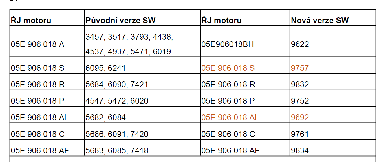

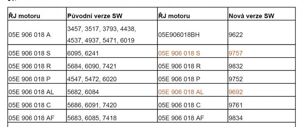

On the forums it looks like all MY19 solved the problem. But some MY18 still have jerking:(
It seems to me that two ECUs in TPI are marked in orange for a reason. I don’t saw someone with ver.9757 or 9692, who still have jerking.
I wonder if replacing the alternator from MY18 to MY19 will help or not. To know what difference they make?!

@Poulwhat is your ECU?
I don't know exactly but from what i have been able to deduce I'm quite sure it's 05E 906 018 AL.
