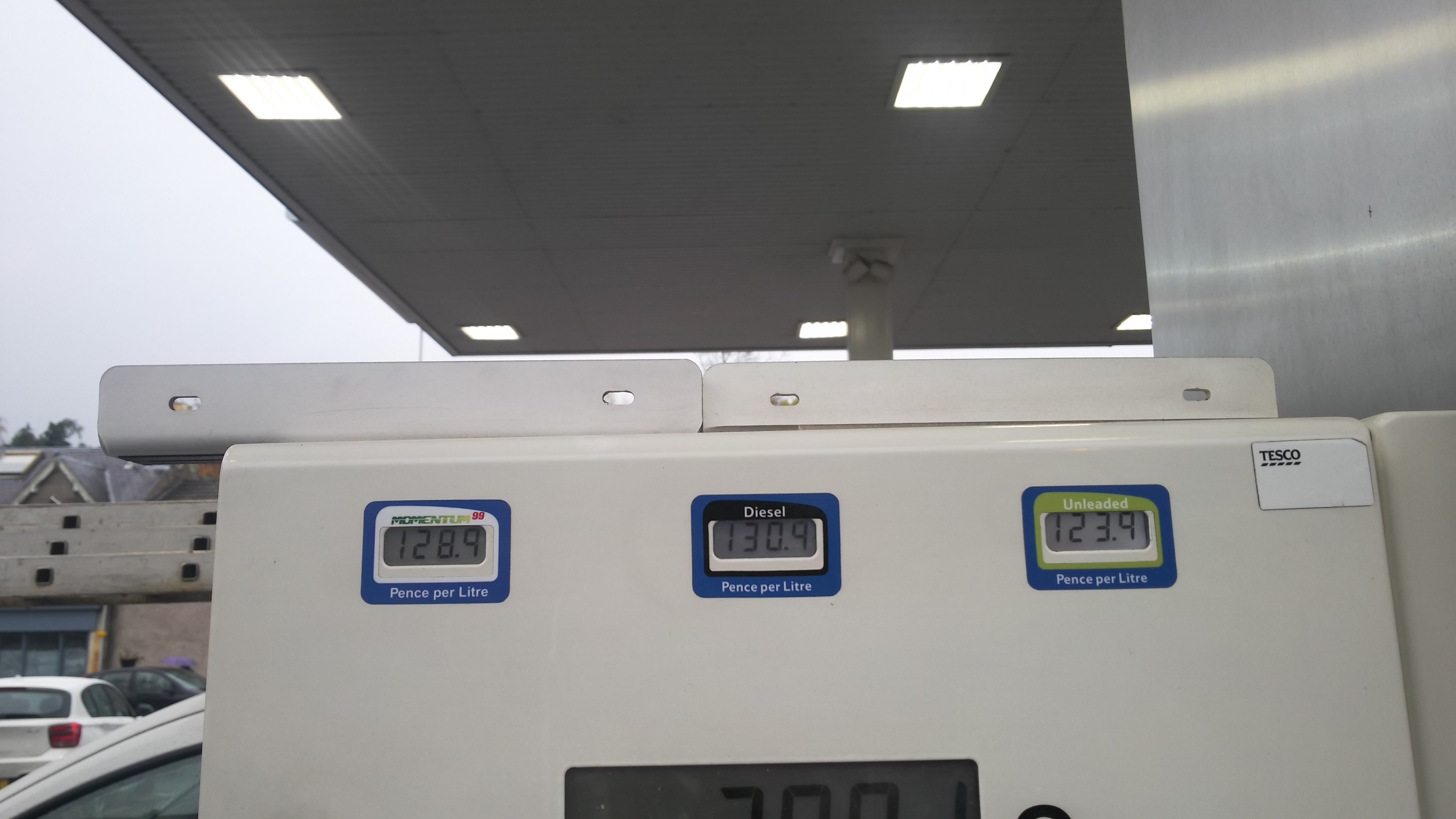

@bigjohn  It is 'Tesco Momentum 99'
& produced by 'Greenergy', that produces fuel for many others.   If the Super Unleaded's higher Octane improves efficient running then good but EU Type Approval and testing requires petrol cars to be tested and run on 95 octane fuel.
http://greenergy.com
Asda Unleaded 95 is no different from other 95 octane Unleaded from ESSO that Greenergy might have supplied, or Sainsburry's Morrisions, Texaco, BP, Shell or any other.
'Own Brand' fuel is not like own brand Beans or Digestive Biscuits.
