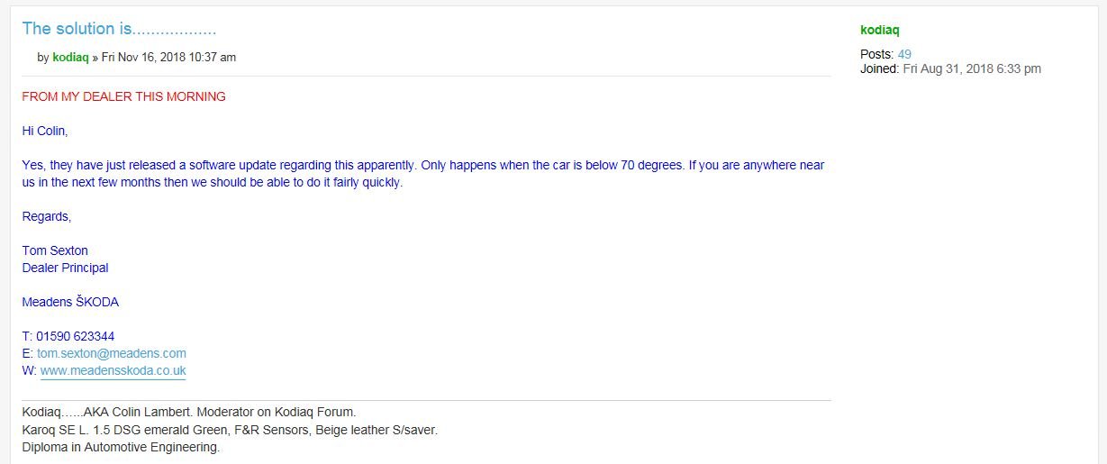

Someone on the other karoq forum has just posted an email from their dealer informing them that a software update is now available.

Well i put a kind of link up showing what someone already posted here about Meaden Skoda saying 'Come on down'.  paraphrase.
Easy enough to remove.  Mods can or i can.
Kangaroo movements in first gear. Solution. see page 2. - Page 2 - Skoda Karoq Forums.mhtml
Why does the person called Tom Sexton who is a Dealer Principal say 'Apparently' to Colin.
A fix has been released 'Apparently'.   is there a release or just might it Apparently be 'a fix' ?
Edited by Offski
In case it doesn't work?
Good though.
So Apparently 'Meaden Skoda' have available the Software to apply an Update, so all the UK Approved Repairers should have.
Owners should contact their chosen Dealership and arrange an appointment 'Apparently'.

Yeh right. Watch this space!! Skoda UK didn't mention a fix being available when I spoke to them yesterday afternoon. More fake news????
Edited by AMC150
More info
The fact you're able to post the link would suggest a work-around, or that Briskoda hasn't flagged that site as not allowed.
I tried to post a link to another Kodiaq forum and the post was automatically held / hidden until approved by a moderator, which it wasn't.
Hopefully a screen grab is allowed...
