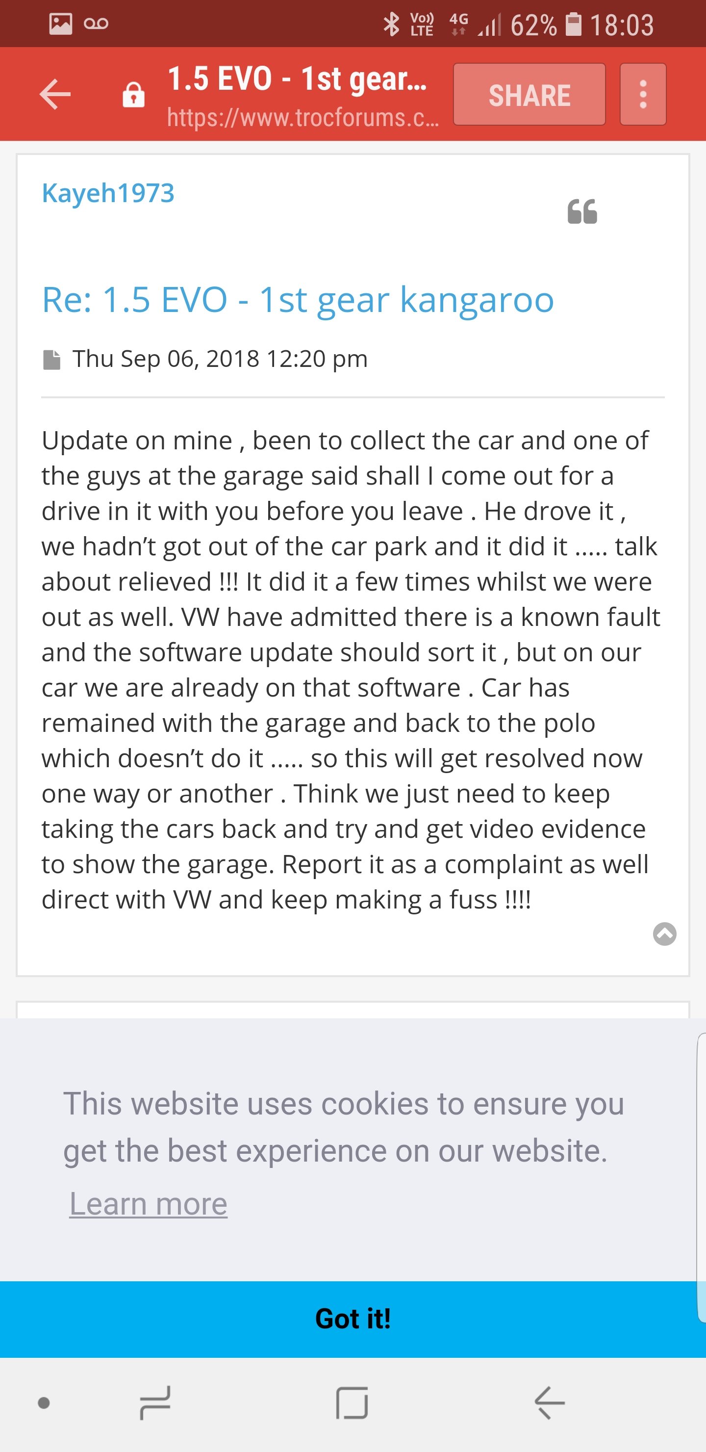

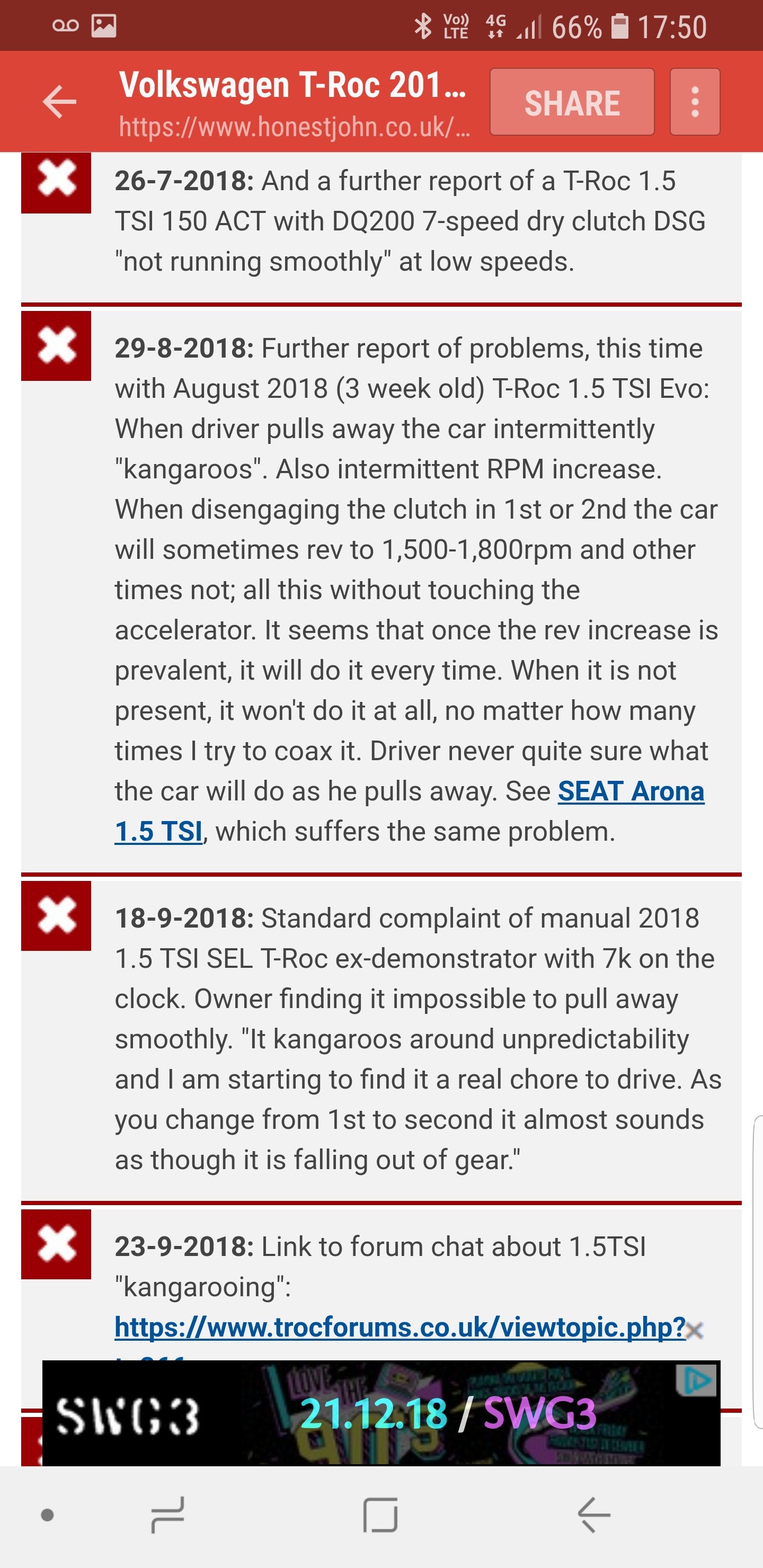

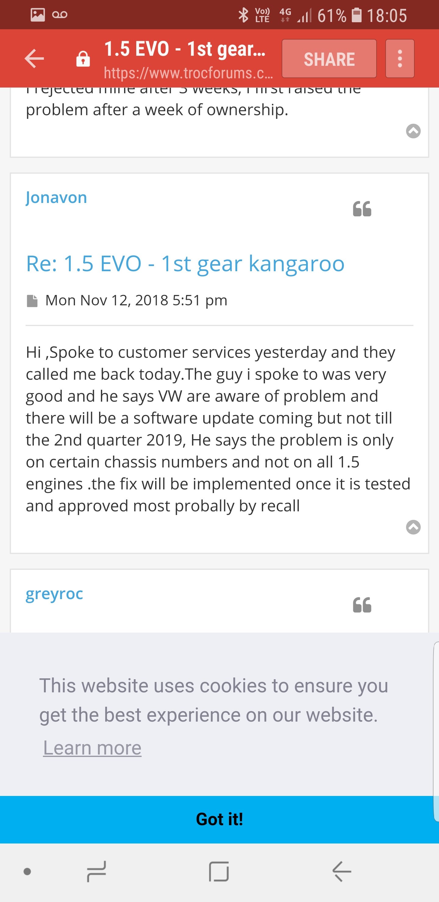

Seems there are a lot of Troc 1.5's doing the same thing. I've been into a Skoda dealership in Newcastle today. Once again they hadn't heard of any issues I pointed out that a lot of owners had issues so suggested he takes a look at all the posts on here. I'll find my local dealer near Oldham and get it in there. No more fobbing off as they say!

Hi. I have sent all of these links to the salesman at my Škoda garage last week. I'm going there this Friday. I have informed Škoda customer services myself last week. Will update how I get on. Not hoping for much though. We really love the car apart from that fault though.
