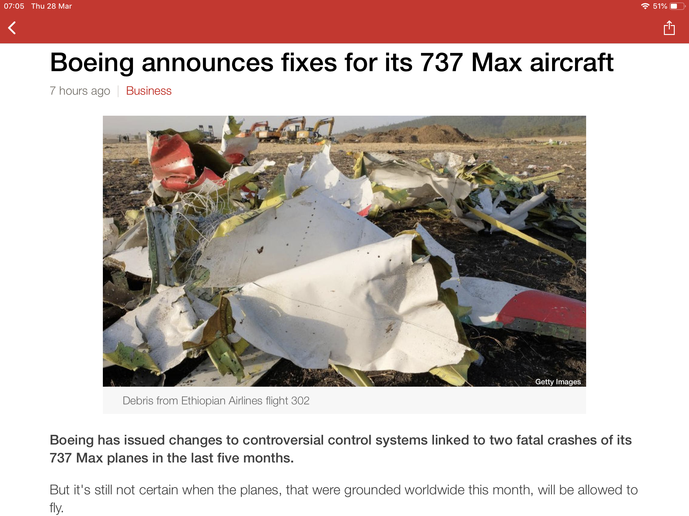

1 hour ago, Sad555 said:
Some companies are quicker that others
Sorry but this is in poor taste.
