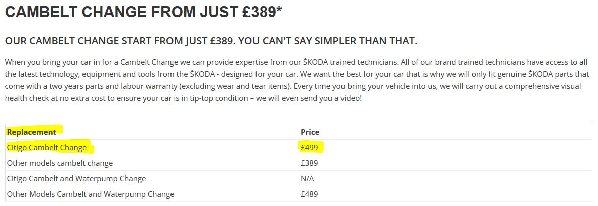

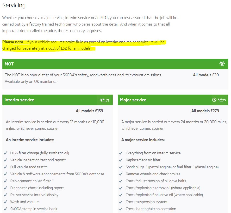

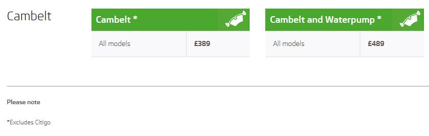

My Citigo will be 5 years old on May 3rd and it's done less than 4,500 miles.  It cost me over £12k when new in 2013 and is in immaculate condition plus it's always been kept in a garage too.  I believe it's now worth about £4,500 in a trade-in.  I can't really believe that VAG could have designed an engine that needs a new cambelt after only 5 years.  According to the website of official Skoda dealers, Jardine Motors Group trading as Lancaster, a replacement cambelt (no water pump mentioned) costs £499.  It's not even shown on the official Skoda UK website where it states "Excludes Citigo" with no mention of an actual Citigo cambelt replacement cost.    I'd also have to pay £159 for an Interim Service plus £52 for a Brake Fluid change plus the cost of an MOT around May 3rd.  This little lot would come to nearly £765 for a car that's now worth sweeties!!  I'm disgusted to say the least.
