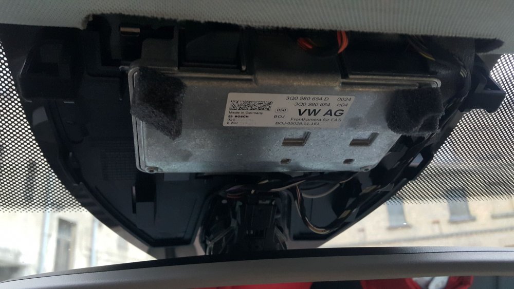

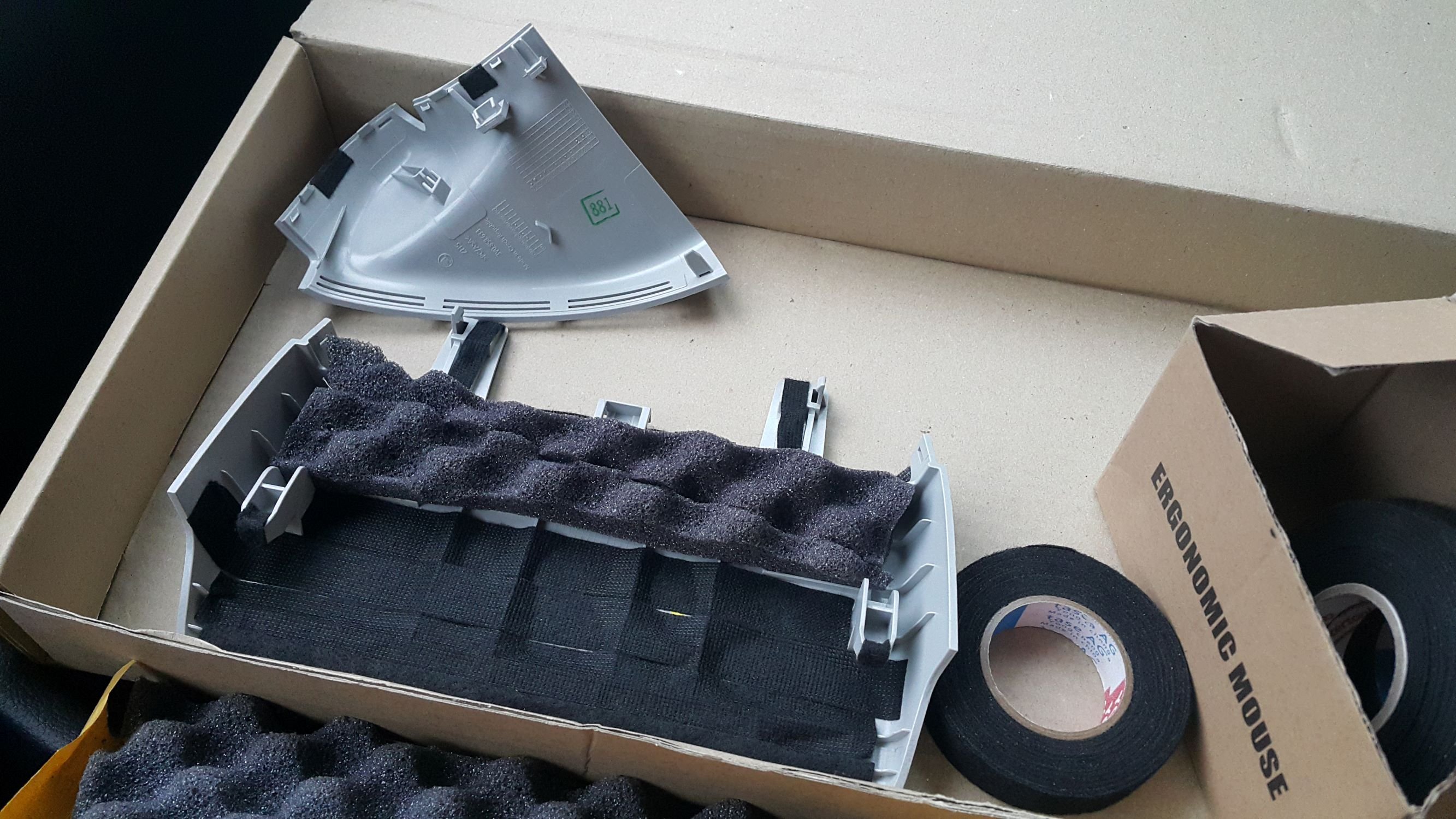

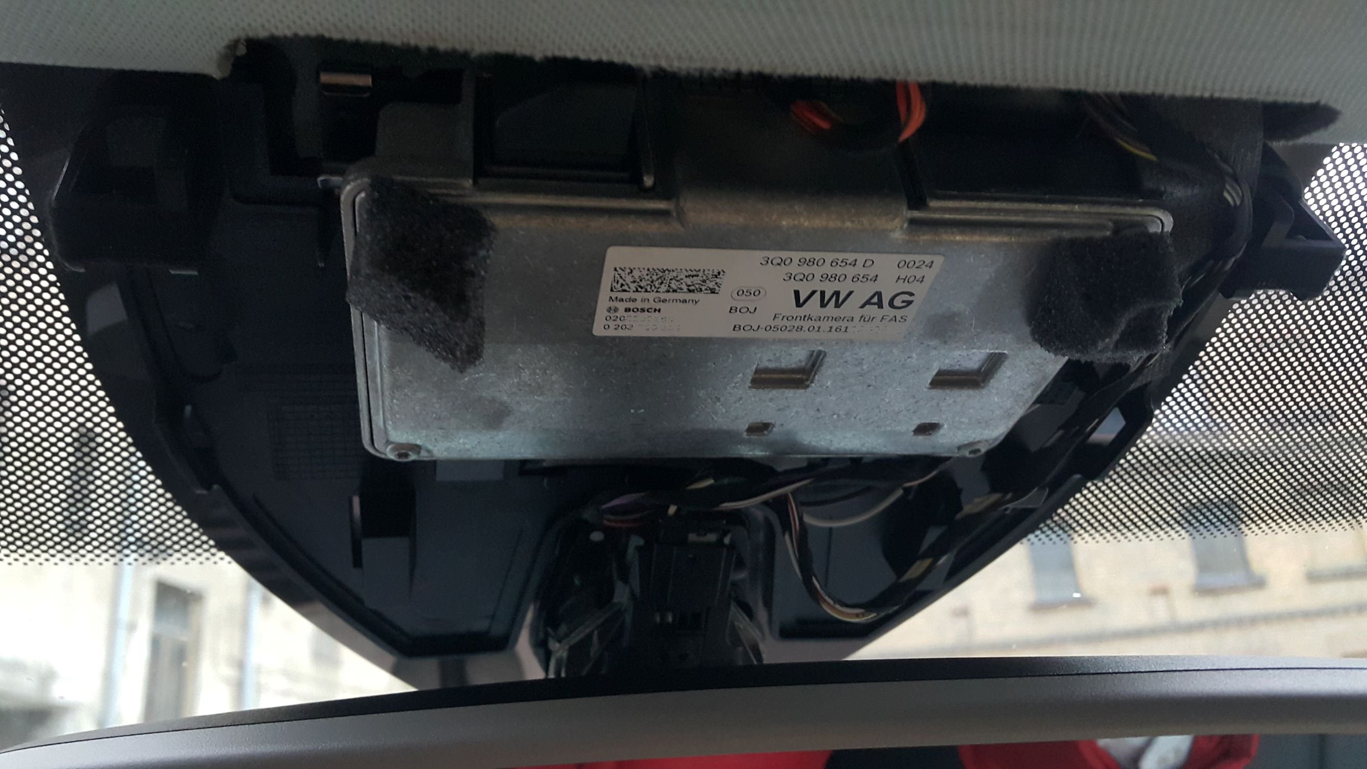

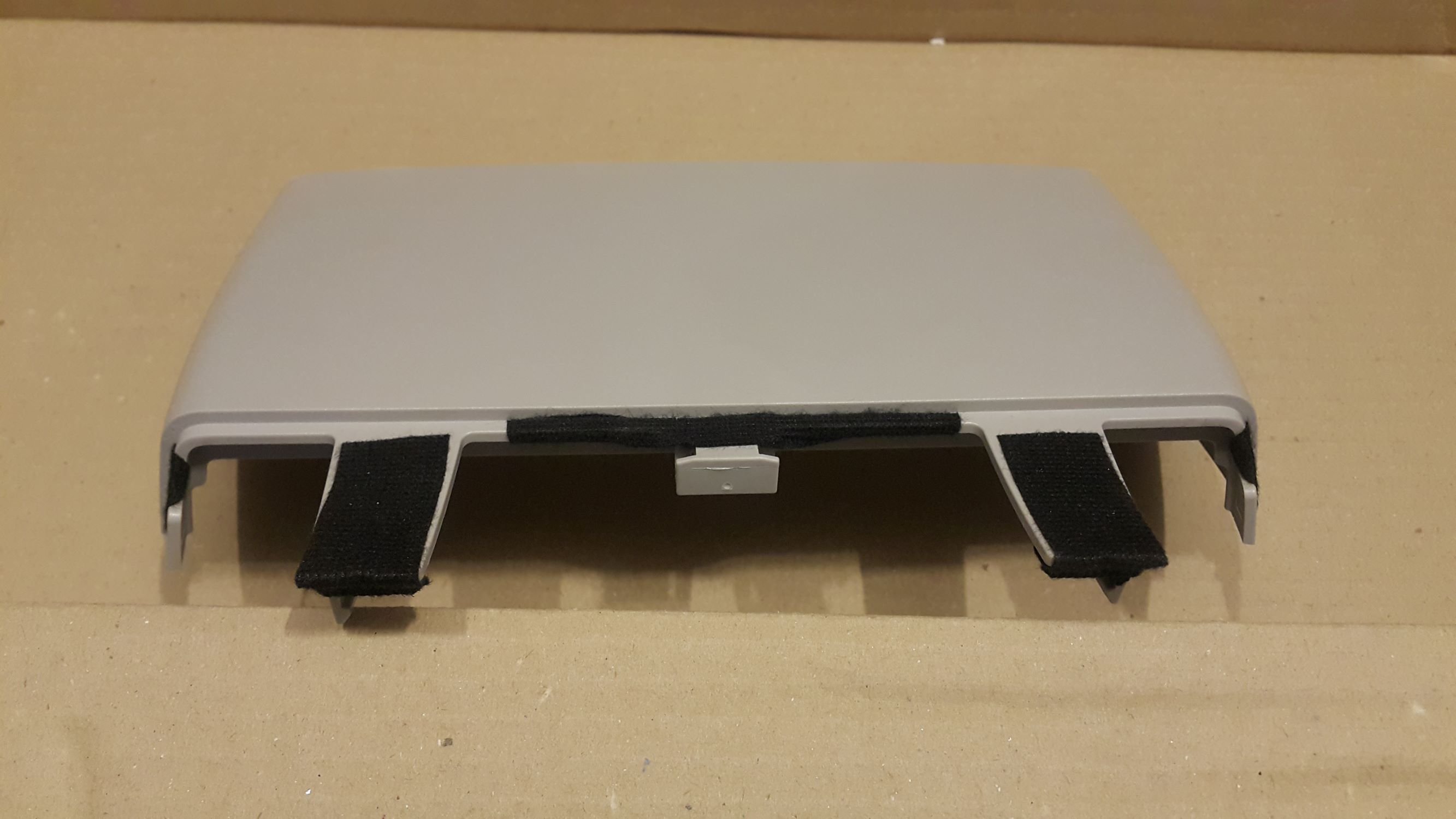

Last week my ŠS3 went to dealer for replace of Windscreen,
asked to fix these rattles or do not mount camera cover back.
not fixed that earlier cause i didn't had idea how it can be disassembled.
they left cover removed,
so i were able add little bit fabric tape and few pieces of sound deadening foam rubber
but happiness weren't lasted long, three days later i had another visit
and this position weren't removed from their job list -
on the evening they reported "cover were removed, fixed and mounted back"

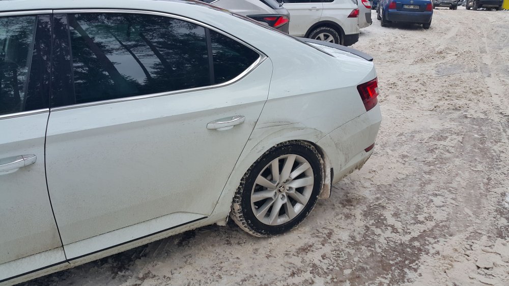

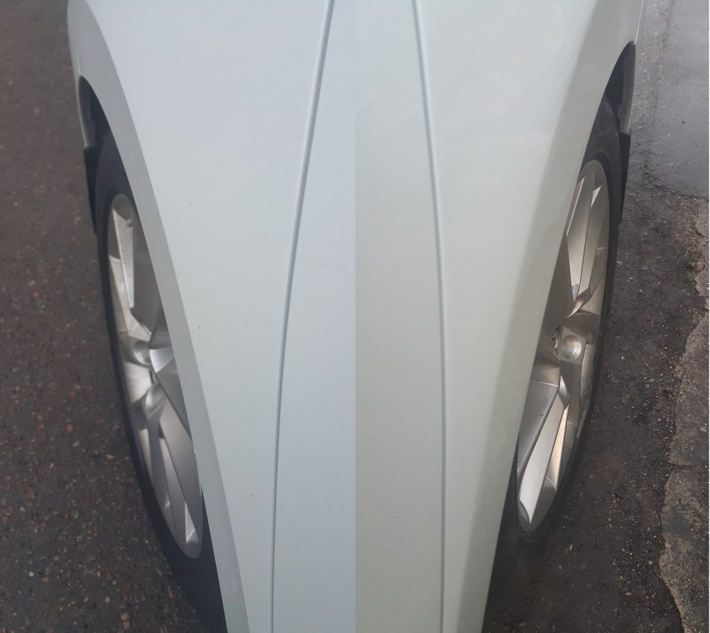

So some time ago some one hit my car on the parking lot and I got a nasty dent in the door. Doors are covered by Dodo Mat's anti-vibration material, so I'm wondering will this material melt when they repair the dent?
I never saw how hot these panels get when they're repairing them, so I'm worried it will melt and create bad odor in the car.... I tried burning material with lighter and it doesn't burn, but it does melt and stink really badly when under fire...

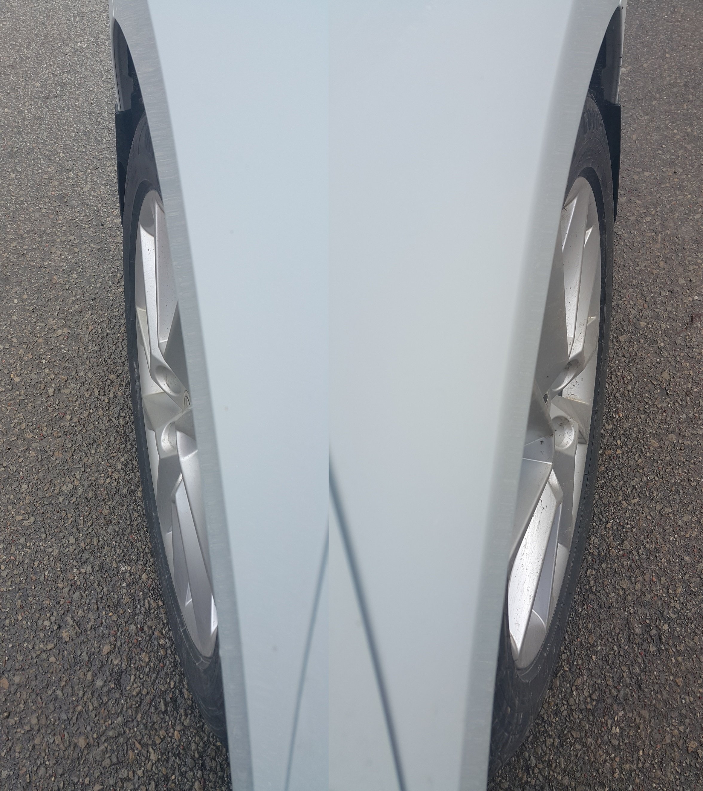

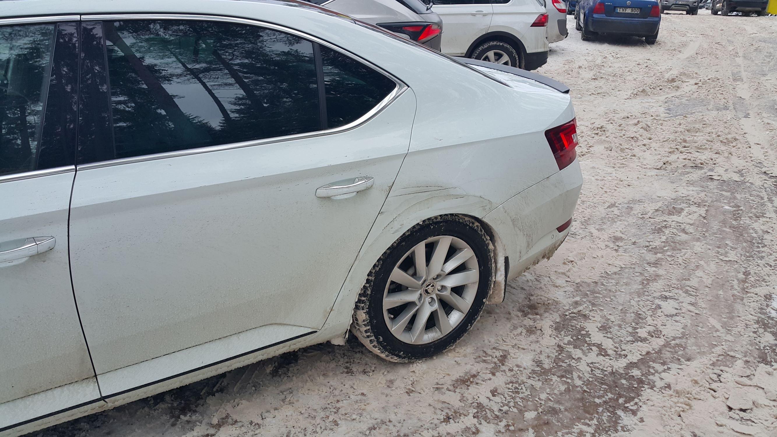

I'm also worried about that,
after two days dealer going to cut out and replace rear wing.
by two attempts of repair by paint they weren't able fix such small problem :(
after first and second attempts

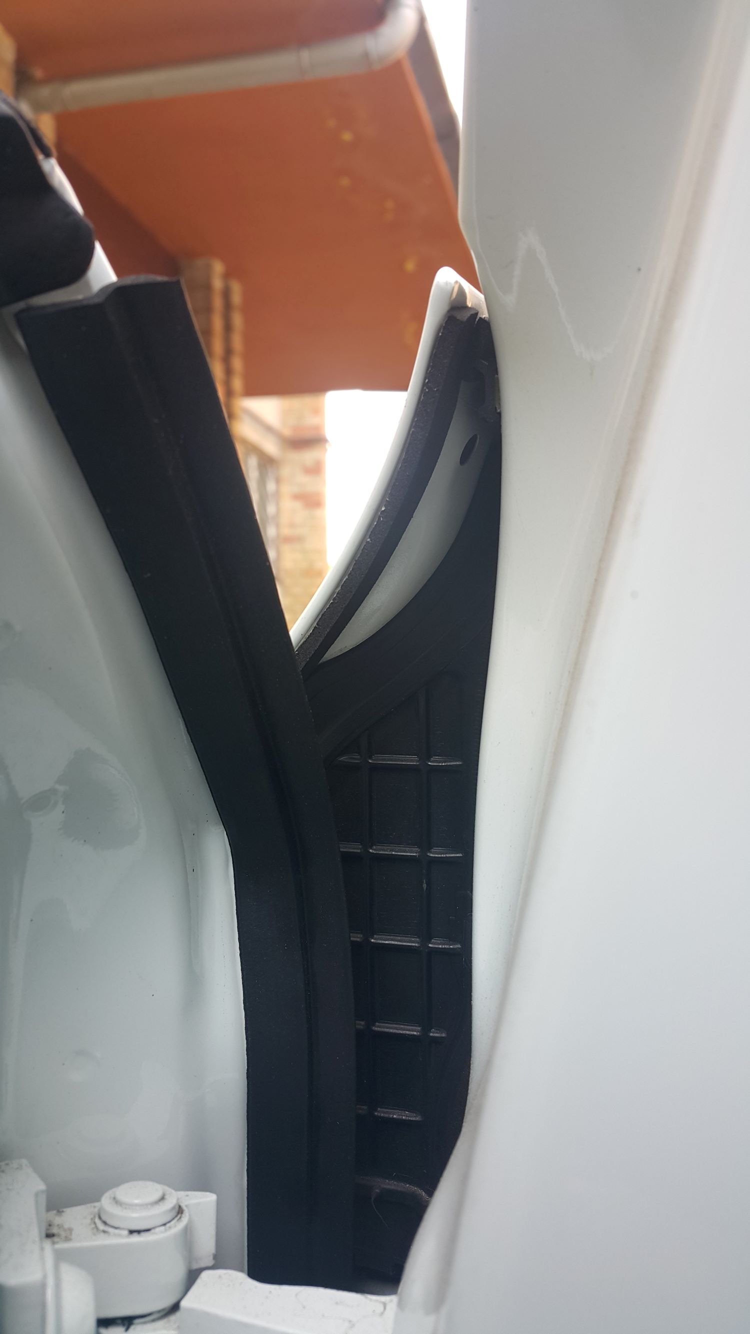

added little bit Sloping D rubber
before vs after
firstly it must prevent of coming these dirt, but it works also as noise insulation
20190224_Labais_un_Kreisais_50p.thumb.jpg.813b956ab8c3dab2c9c62cef0f3eb648.jpg 20190309_Labais_un_Kreisais_50p.thumb.jpg.5f0745ba569e92f8b2ff7c5f1e53caf8.jpg
That sounds scary! Welding will melt material for sure... The metal gets very hot when they weld and the silent coat or similar material will not be able to withstand so high temperatures.
What I have doesn't require cutting and welding anything lucky, but I have no idea how they fix dents otherwise. I saw they quick weld some pipes on metal and then push them outwards but idk how much does that heat up metal.
It really scares me, that maybe it could even cause fire with enough heat. I will for sure talk to dealer next week when I go drop off my car
I had damage on the wing too, the rear right tire made fender bend outwards and they never fixed it as it should be. If you look carefully you can easily see its not 100% straight. But at least paint is correct. So i'm not bothered much.
The rubber sounds good idea, does sound wise make big difference or unnoticeable? I will probably get something like that too, but these Chinese ones never stick enough =/
about +25% for sound deadening inside the doors
but i have also vertical Z Type rubber strips

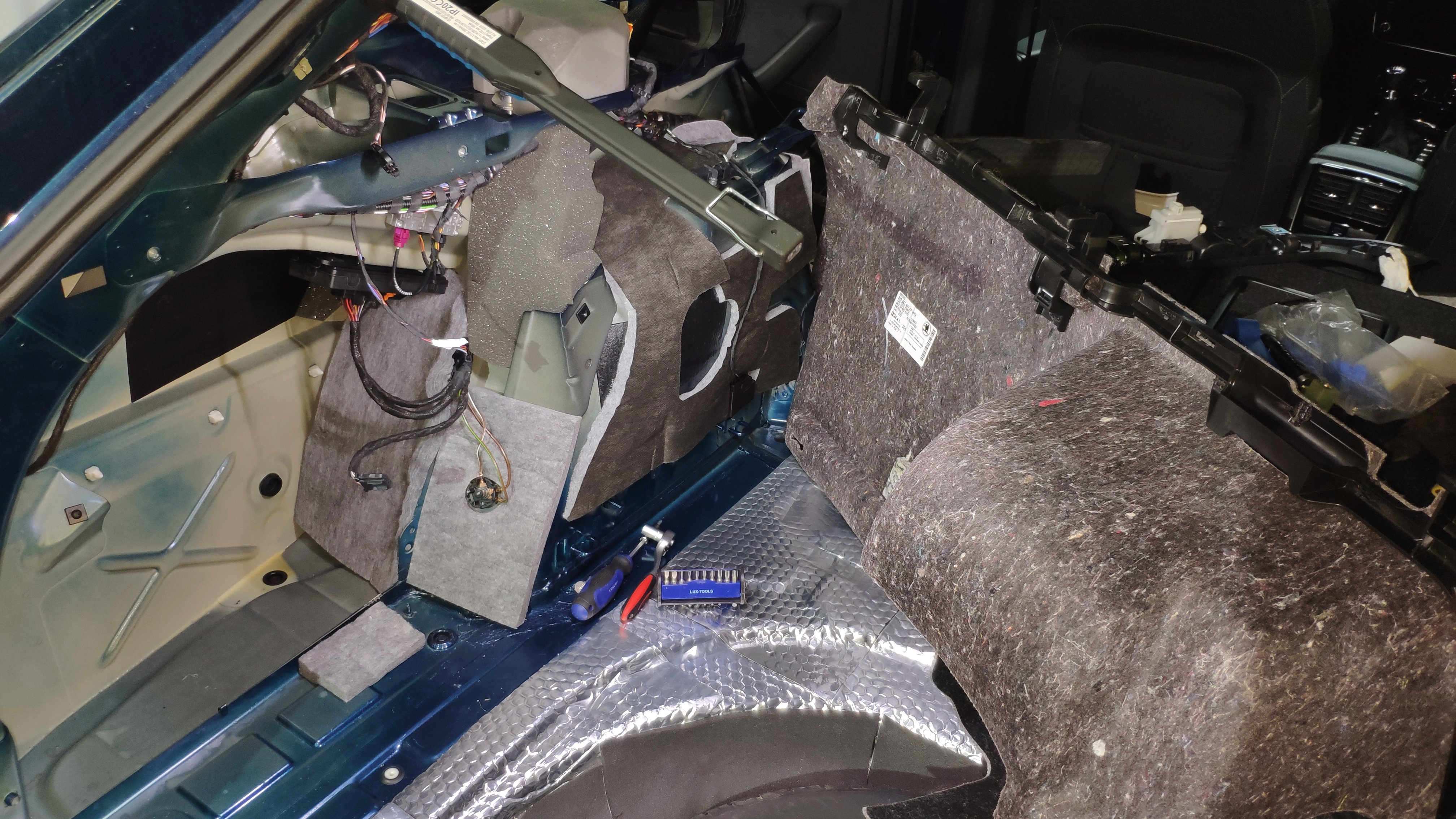

For the trunk, its hard to explain, but initially I thought by looking service manual that I have to remove every thing, including the rear seats and every damn thing. What I did (as its seen on pic) is not removing the rear seats but only (in this order):
- Rear seat bench
- Rear Air bags (removed battery)
- Last Pillar (D I think)
- Removed Top of trunk (plastics that holds light, seat drop, 12v socket etc...)
- Removed "loading" plastic that has metal on it for dragging stuff in/out of the car, dunno the name
- Removed sides at "loading" plastic left/right
Then finally remove sides of the trunk, but not 100% remove, just bend them a little so u can get to stuff behind as seen on my pic above. Once you do it, its not hard to do it again, I had to remove it again because the sides of trunk started rattle very badly when listening to music at high volumes (sub shakes)... For some reason the plastic clips of the trunk sides didn't hold plastic to the metal firmly as before but that's weird cause I was very gentle and I am sure i didn't bend/damage any of these plastics. Any way I removed top again to fix rattle and added anti-vibration material between plastics. Now its quiet.
P.S.: Its possible to remove top covers of the trunk without removing airbags, but its risky business as you might damage C pillar as I did (it doesn't stay firmly on anymore... Top left side of pillar seems to be bit off for some stupid reason...

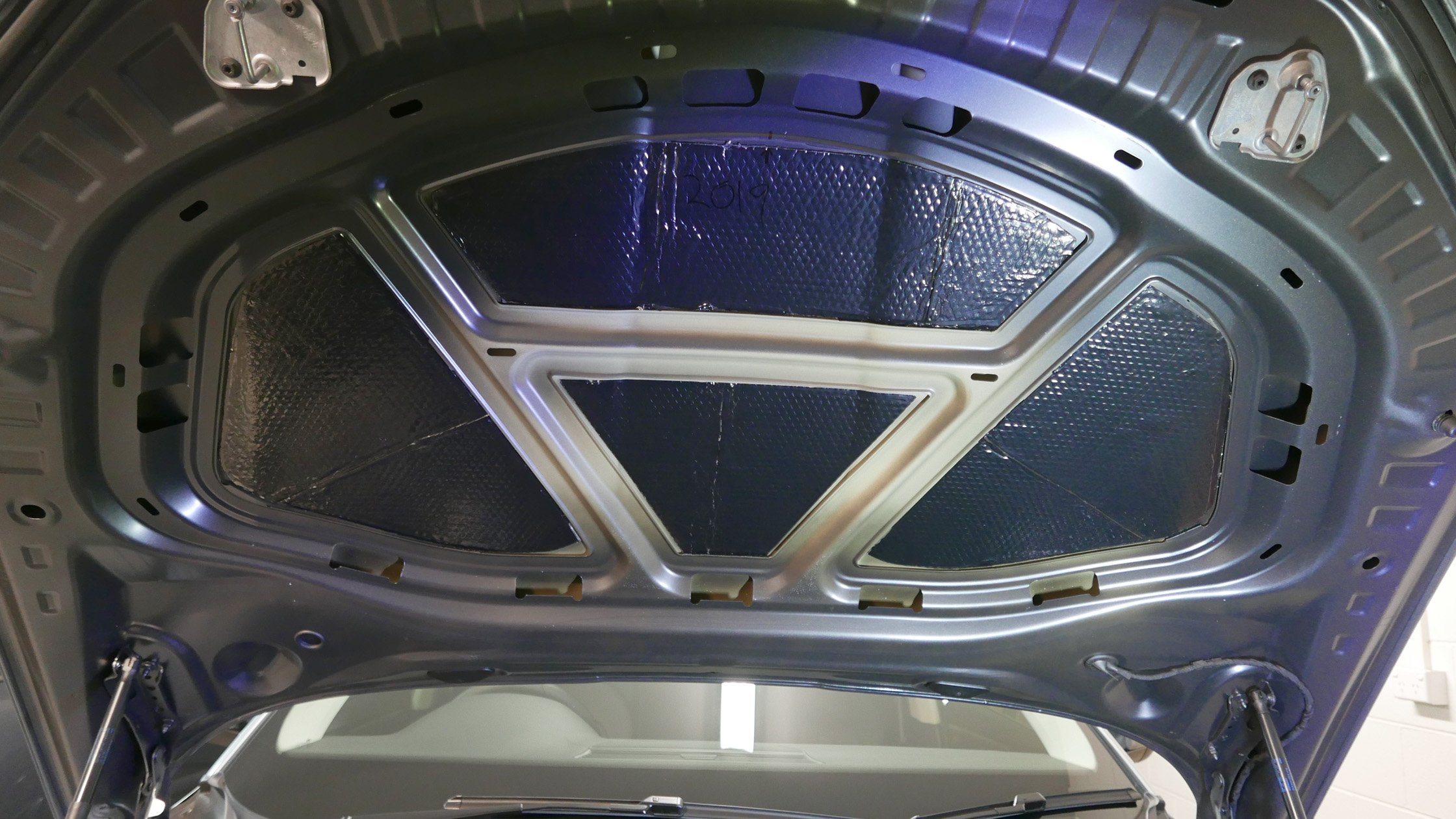

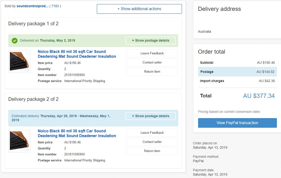

I just started on my Skoda Superb III sedan/hatch this weekend using only Noico Black Byutl (aluminium on buytl) sheets.
TLDR - Bonnet, quieter engine, road noise subtle improvement but nice. Boot, totally worth it.
https://www.ebay.com.au/itm/251811595900

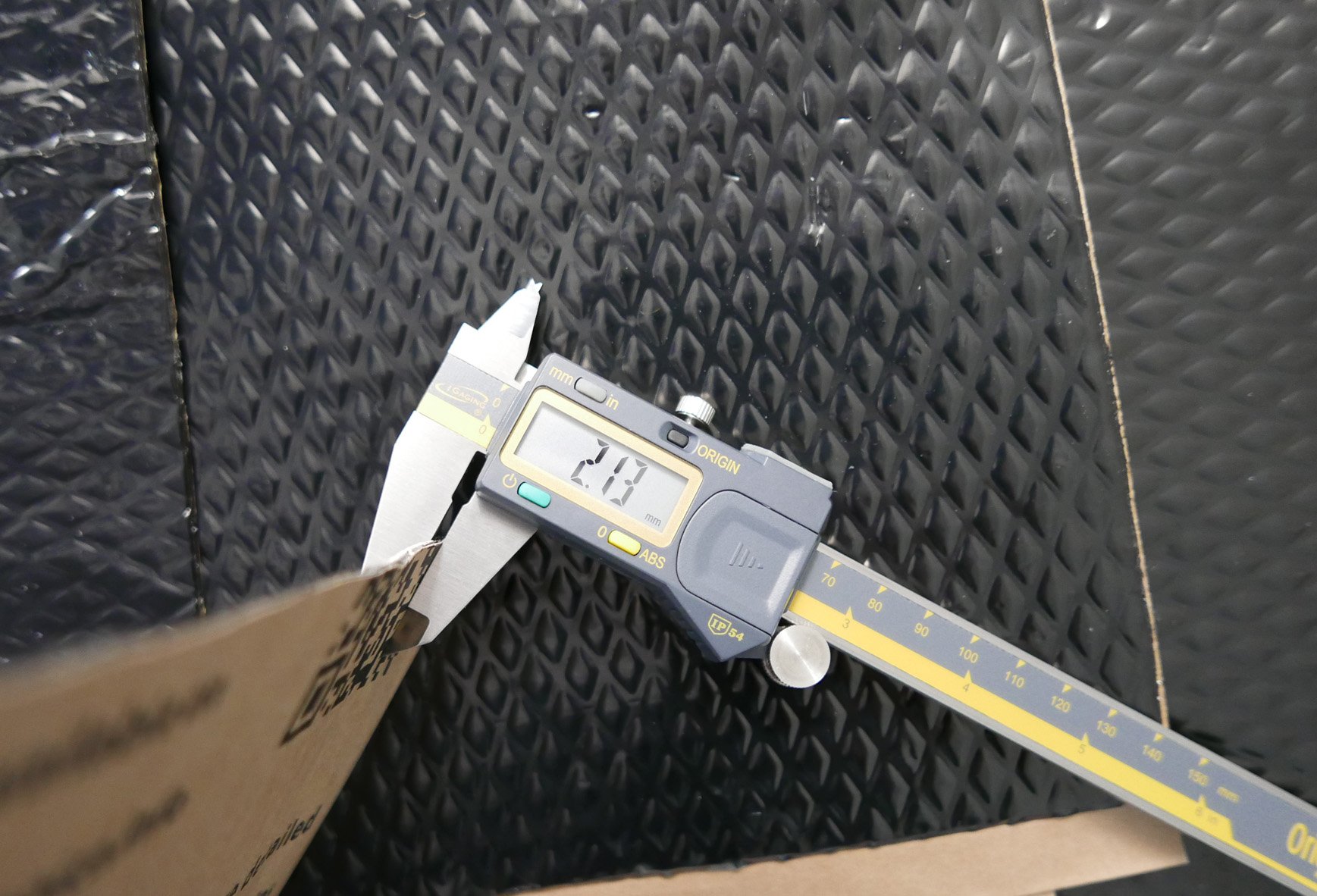

Quality product. Large sheets, About 2 mm thick. You get nine ~ 750 mm x 508mm x 2 mm - sheets in a box @ 12.7 kg. I really like the black, it looks (almost) OEM once installed.
1. Under bonnet - First I did under the bonnet (the 4 panels available once you remove the heat blanket held on by clips (as you can see here in Alfonsos post). TIP: To get a template for the shapes, I taped some wide-roll aluminium foil over each cutout and rolled around the edges with my roller. Then cut the pattern out with scissors and transferred to the sheeting by tracing and cutting the byutl. For the two side panels, as they are mirrored, just flip the foil template over once to make the compliment.
Test drive - This made the engine noise noticeably quieter in the cab and (surprisingly) seemed to tame a bit of road-noise.  Just a sense of things being calmer up front. There must be some coming up through the engine bay, through the bonnet and then through into the cabin from the windshield?)

Yes, the price of a single box delivered to Aus is ~ $190 per box ( 3.3 m2 ) I got two boxes, but but one would probably be enough. That said, I like this stuff a lot, and its handy to have more ;)

Under bonnet pic ... all you need to do is pay attention to the orientation of the clip heads (put them back the way they were installed due to the oval slots they go in. If they are rotated 90 degrees to the correct direction they will fall out), the clips are relatively easy to get out. The head squeezes together and releases the clip, with a little bit of tugging.
The cover itself is light as a fluffy cushion and no problem at all to handle.  Leave one of the top clips in till last, a single clip will support the weight of the whole cover.
